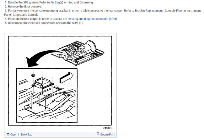

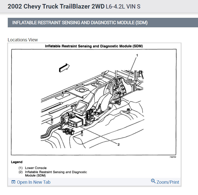

airbag light stays on. Code is for right front impact sensor, replaced, reset , still on. GM mechanic says probably airbag module. Tried to find it, says in rear seat area under carpet. where?
Feb 5, 2018 at 11:05 AM
CJ MEDEVAC
  • 11,004 POSTS

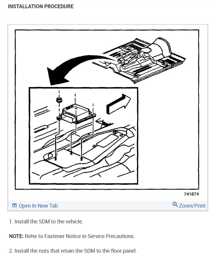

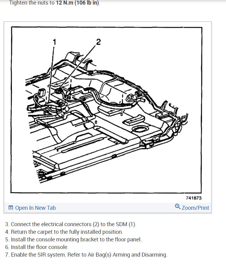

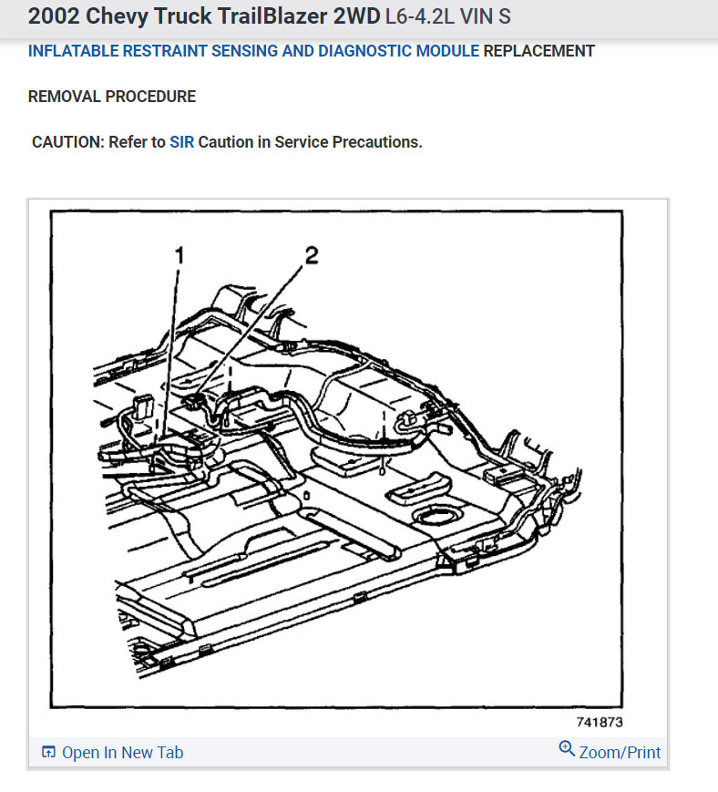

On an 2004, it s sort of on top of the "hump" at the rear end of the console. Here is the location in the diagrams below of how to change the airbag module out and the location. Looka t this video to help get codes
