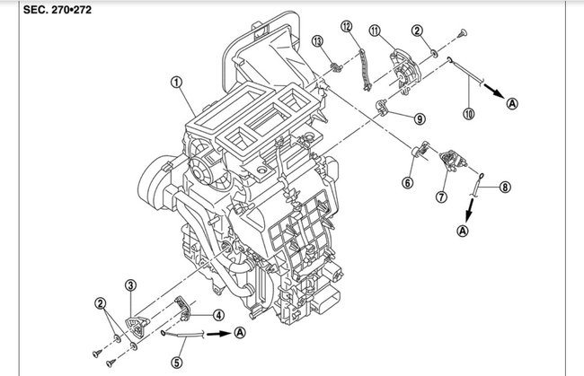

So about a month ago, two of the four vents in my car stopped blowing. Ever since then I’ve noticed that my car has started to feel very humid. Like, the windshields would condense on the inside, and everything just feels somewhat damp.
Mar 25, 2020 at 6:09 PM
SCGRANTURISMO
  • 4,897 POSTS

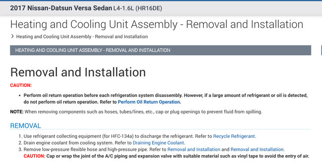

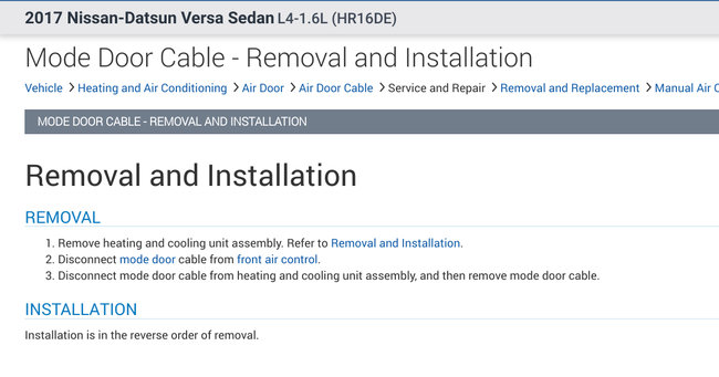

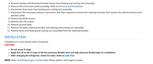

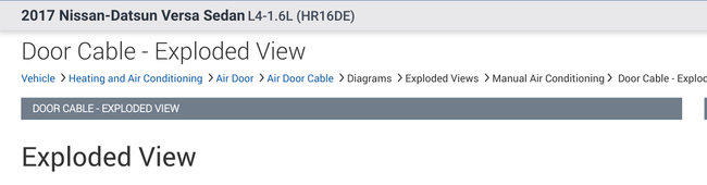

This could be a problem with your mode door cable. In the diagrams down below I have included the instructions from the vehicle manufacturer for the removal and installation of the mode door cable for your vehicle. Please go through this guide and get back to us with how everything turns out.
