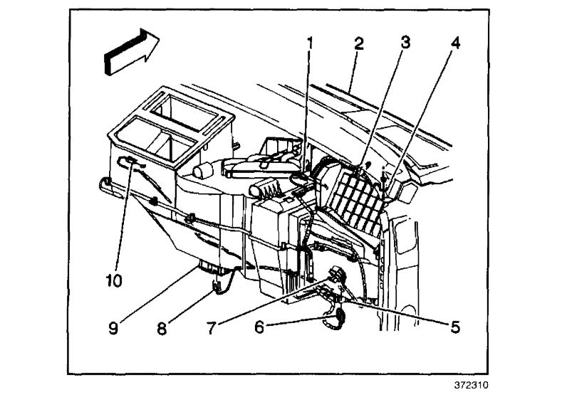

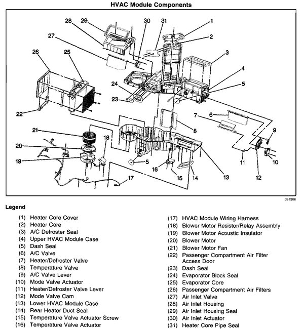

It sounds like you have a restriction. Since you have the dash out it should be easy to remove the cabin air filter. Your filter is either very dirty or something got sucked in. Attached images. #26 is the cabin filter location. Pull filter and upload picture to see what is going on.

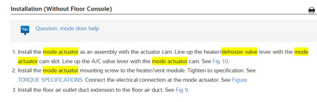

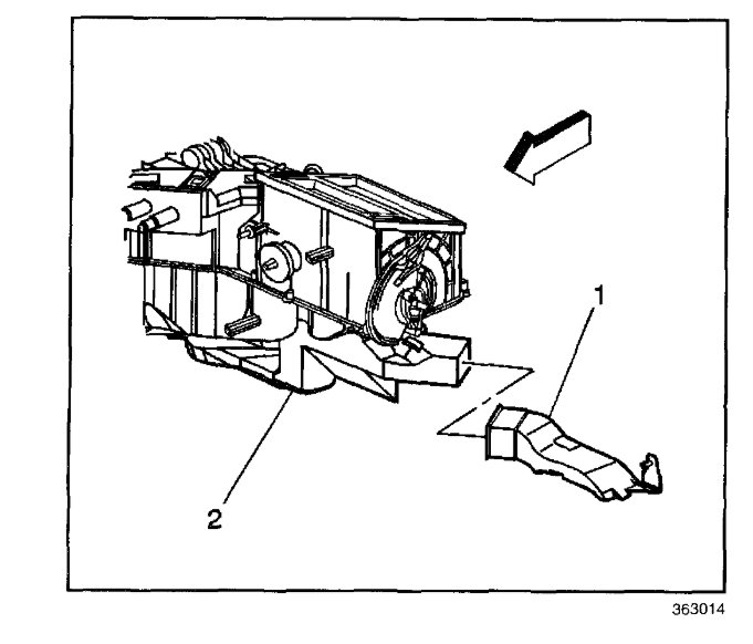

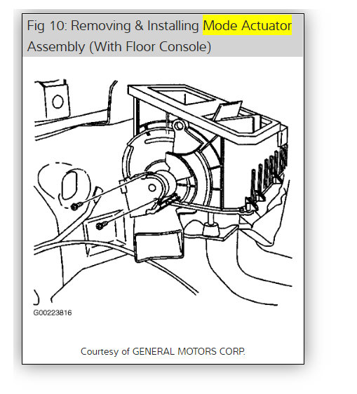

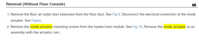

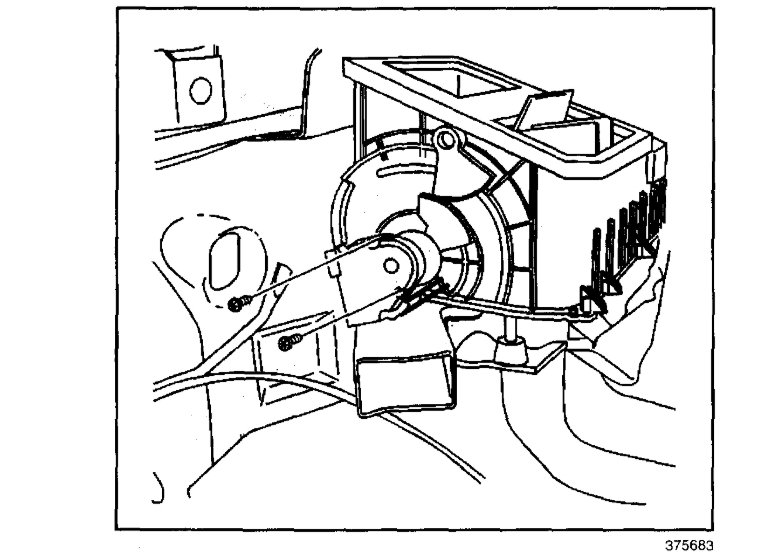

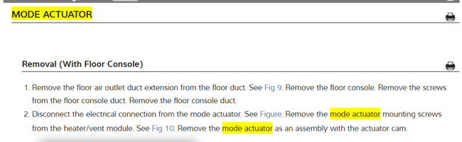

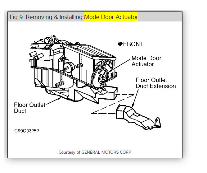

Good morning,
There is a mode door in the system that is commands vent operation. I attached the procedure for removal with some pictures.
As far as the blower, make sure there is power to the blower resistor at the rear. Good chance the resistor is the issue.
REMOVAL PROCEDURE
1. Remove the floor air outlet duct extension (1) from the floor duct (2).
2. Disconnect the electrical connection at the mode actuator (10).
3. Remove the mode actuator mounting screws from the HVAC module.
4. Remove the mode actuator as an assembly with the actuator cam.

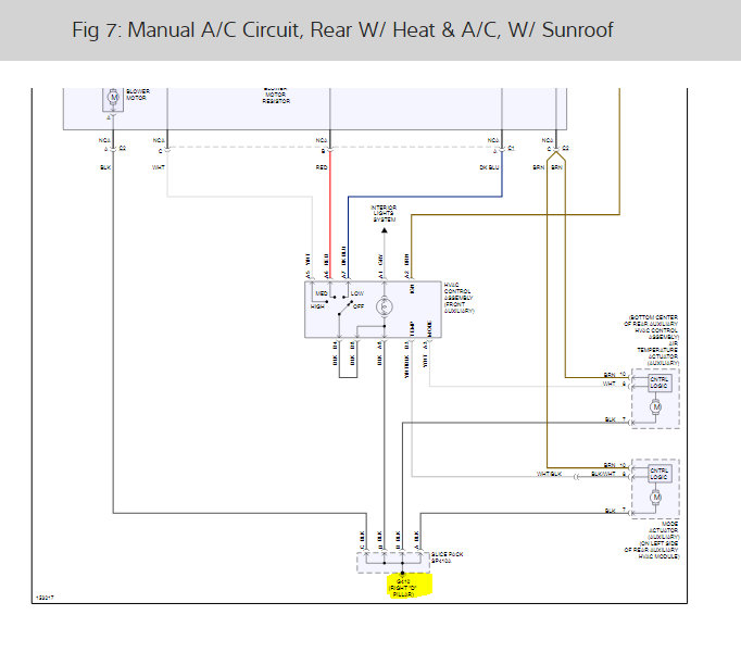

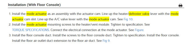

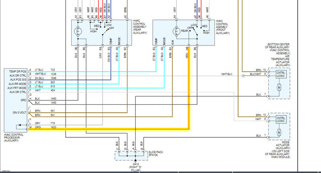

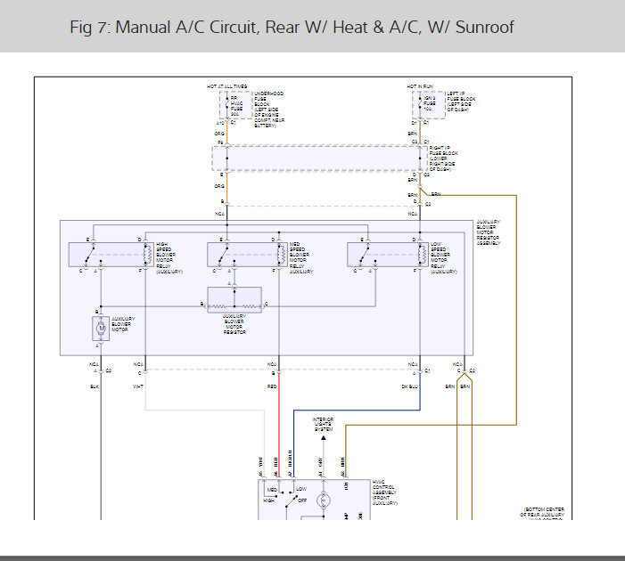

SCGRANTURISMO
  • 4,897 POSTS

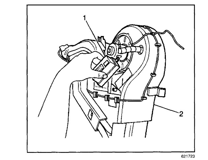

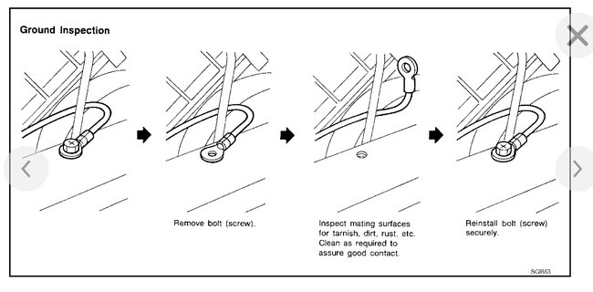

Okay, the problem with your vents is probably going to be with your mode door actuator. In the diagrams down below I have included the factory directions for the removal and installation of the mode door actuator for your vehicle. I have also included a wiring diagram for your rear blower motor as well as a guide for how to inspect ground connections. The problem for the rear blower motor could be a bad ground connection at ground #408 which is located on the right D pillar of your vehicle. Please go through these guides and get back to us with what you are able to find out.
