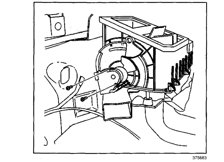

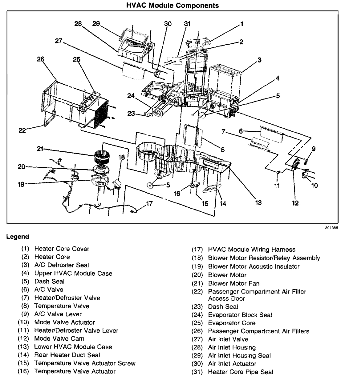

When my air is turned on i have no air or very faint air coming from my vents. When i turn the defrost on or the heater i have no air coming from either places. The blower is working fine but it does make a loud bellowing sound when turned on high. It almost sounds as there is something plugging the ventilation up. I have my dash completely opened up. I watched my mode actuator as i went through all the modes on the unit and moved but very little. I watched my temperature actuator and it also moved very little, not only that but it kept moving back and forth. I pulled my temperature actuator and then moved it manually and i got my heat coming from the floorboard. Once i moved the flap door by hand i could not move it again unless i turned off my air. I have not gotten to my blend door yet but i figure i better contact someone who knows more on this subject before i pull that out. So basically if i turn the unit on i am not getting air where I am supposed to in any mode. The blower is working. I can hear movement in my dash. And the only time i have gotten air out where it supposed to be is the lower heater when i turned the air temperature actuator. Can you help?

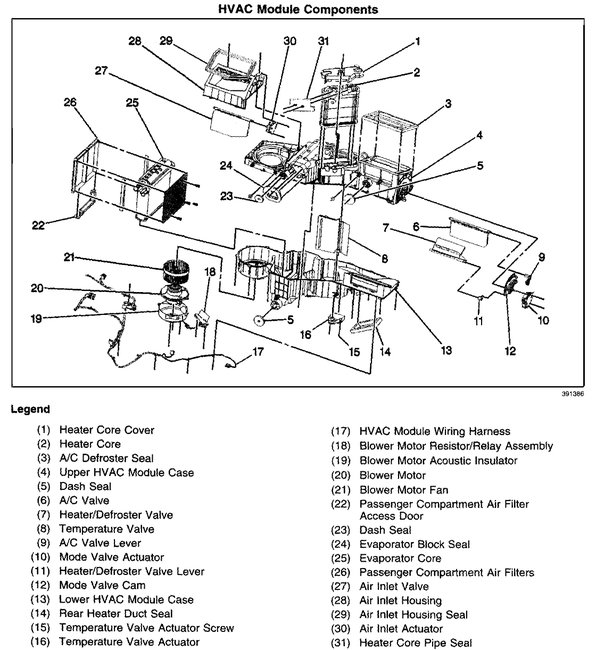

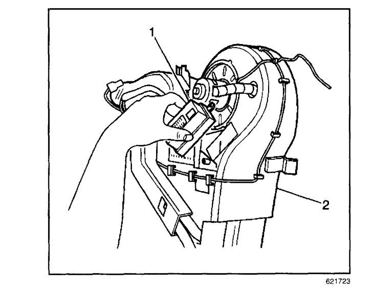

It sounds like you have a restriction. Since you have the dash out it should be easy to remove the cabin air filter. Your filter is either very dirty or something got sucked in. Attached images. #26 is the cabin filter location. Pull filter and upload picture to see what is going on.
Feb 13, 2018 at 10:13 PM

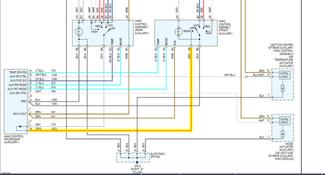

All of a sudden one day I turned on the A/C and I had no air mowing out of my vents in the front. Air will blow out when it’s directed to the floor or defrost, but not the “front” vents. I can hear the compressor kick on and the fan blow. Blow motor resistor was changed about about two years ago, but not the blower motor. At the same time, I have no air at all coming from the rear. I replaced the blower motor in the rear not quite a year ago, but I hear nothing when I turn the fan on in the rear.

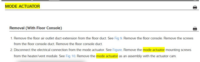

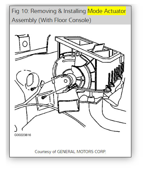

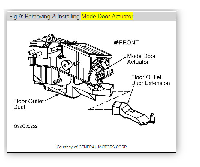

Good morning,

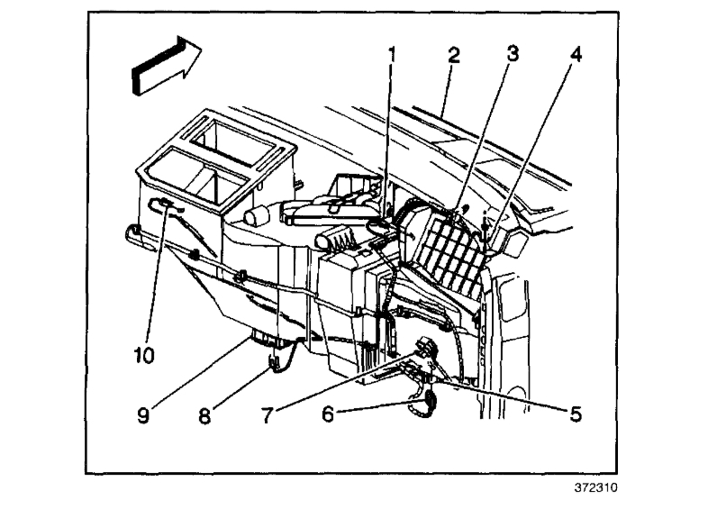

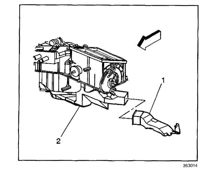

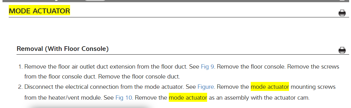

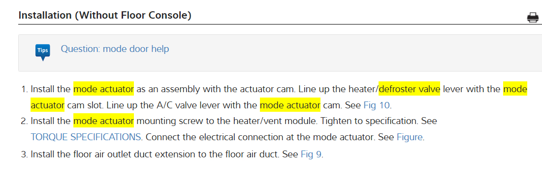

There is a mode door in the system that is commands vent operation. I attached the procedure for removal with some pictures.
As far as the blower, make sure there is power to the blower resistor at the rear. Good chance the resistor is the issue.

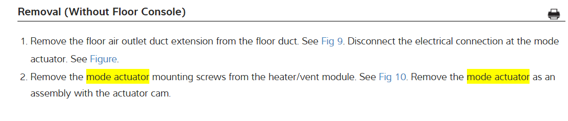

REMOVAL PROCEDURE
1. Remove the floor air outlet duct extension (1) from the floor duct (2).
2. Disconnect the electrical connection at the mode actuator (10).
3. Remove the mode actuator mounting screws from the HVAC module.
4. Remove the mode actuator as an assembly with the actuator cam.

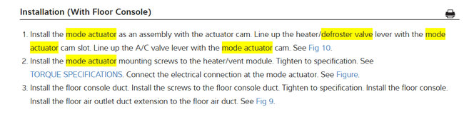

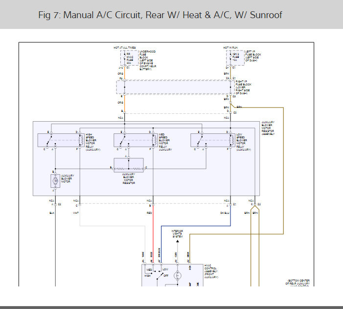

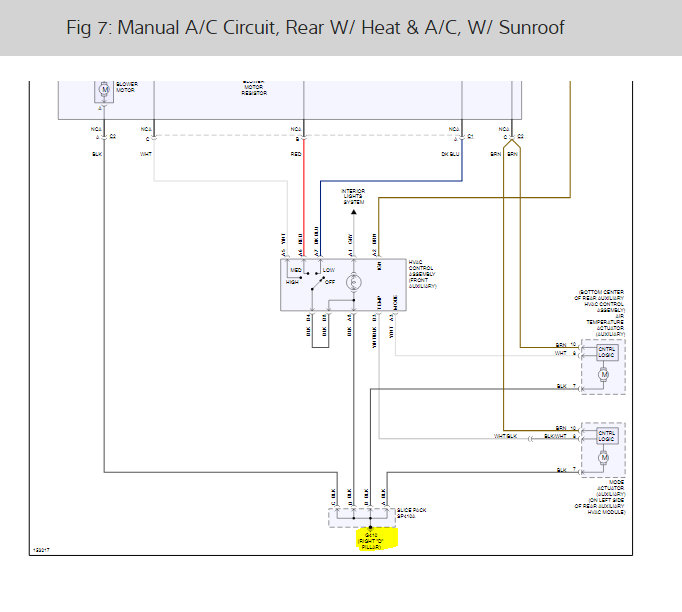

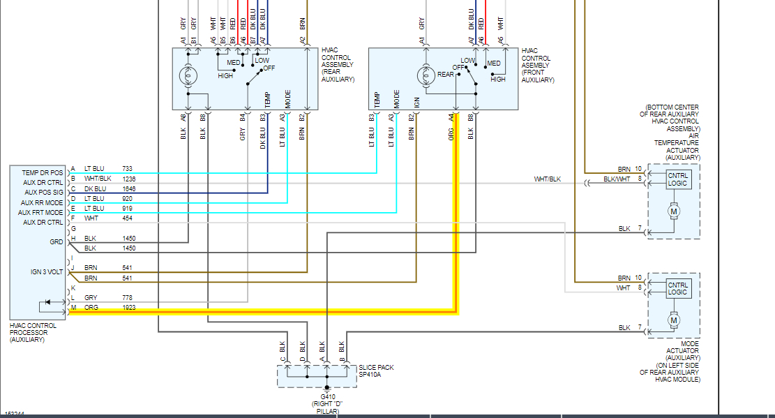

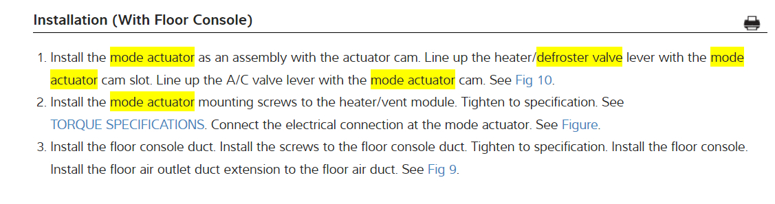

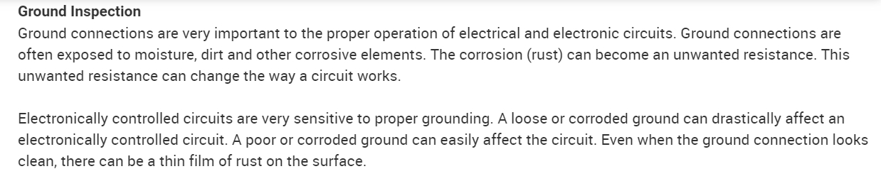

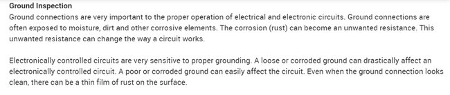

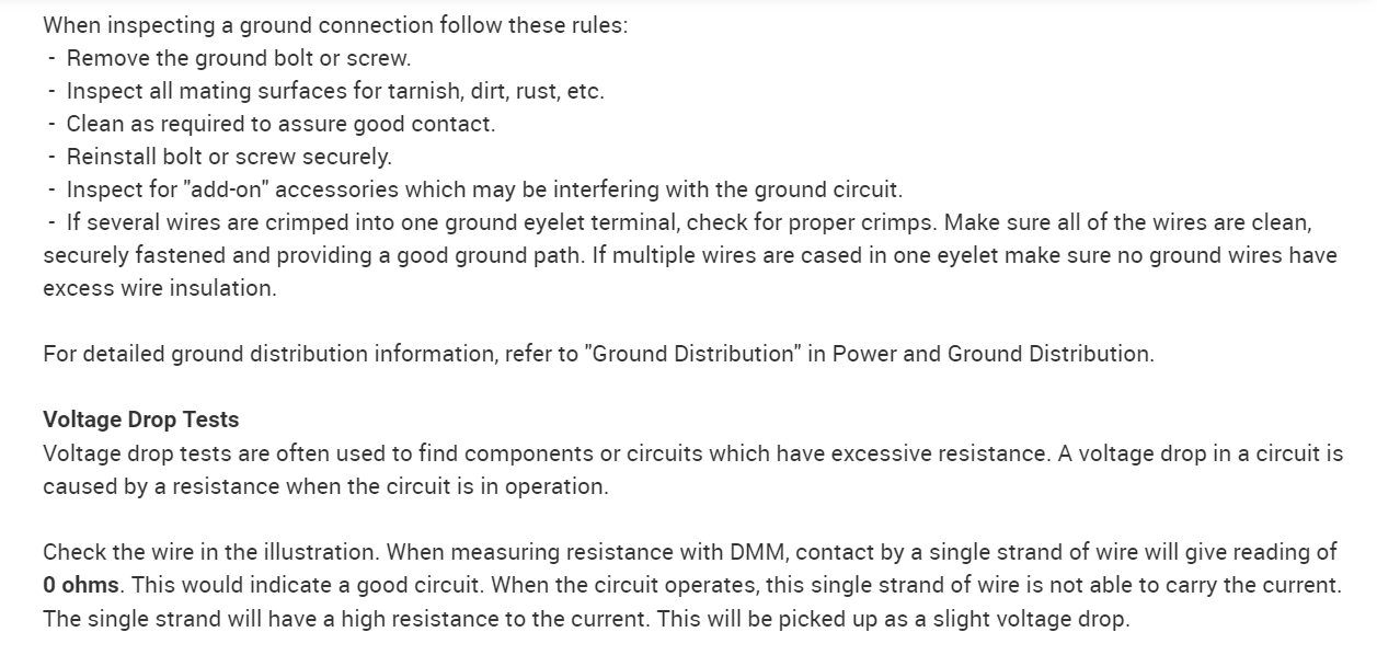

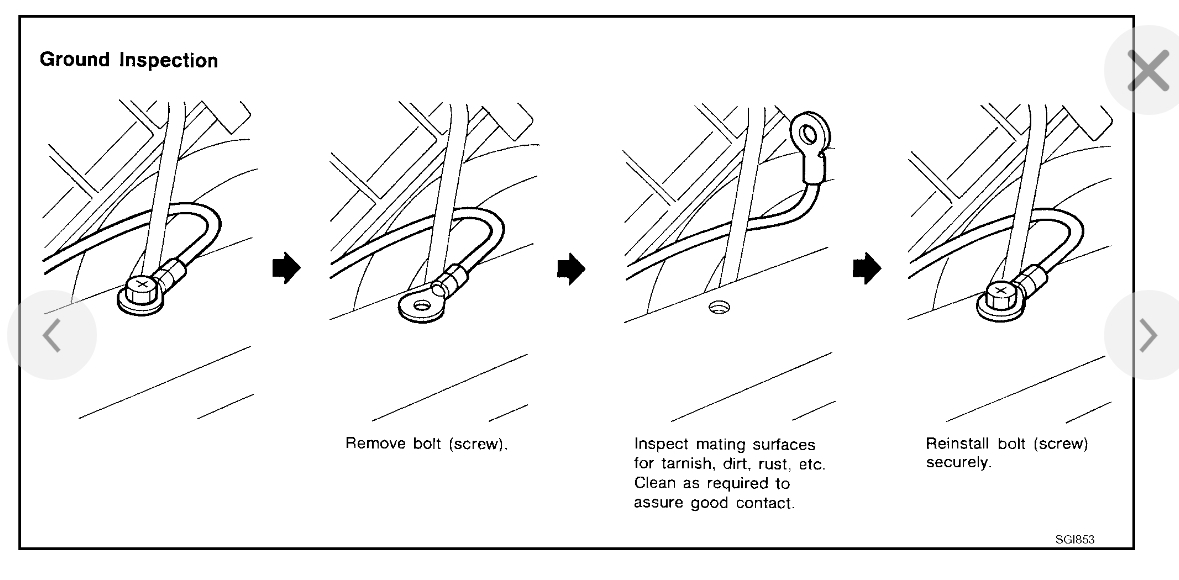

Okay, the problem with your vents is probably going to be with your mode door actuator. In the diagrams down below I have included the factory directions for the removal and installation of the mode door actuator for your vehicle. I have also included a wiring diagram for your rear blower motor as well as a guide for how to inspect ground connections. The problem for the rear blower motor could be a bad ground connection at ground #408 which is located on the right D pillar of your vehicle. Please go through these guides and get back to us with what you are able to find out.
Thanks,
Alex
2CarPros
