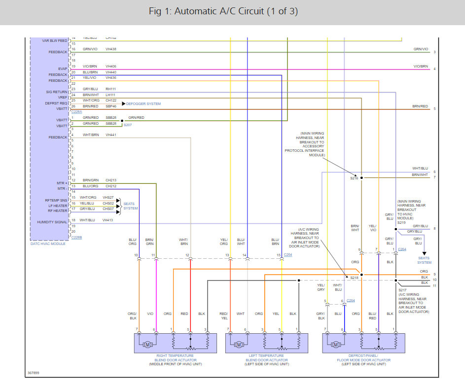

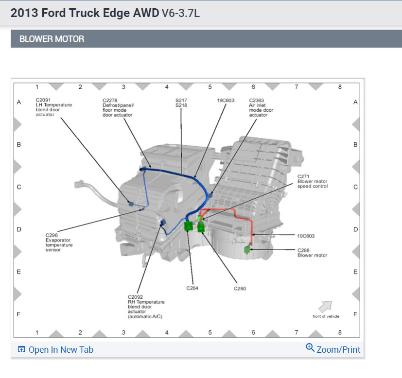

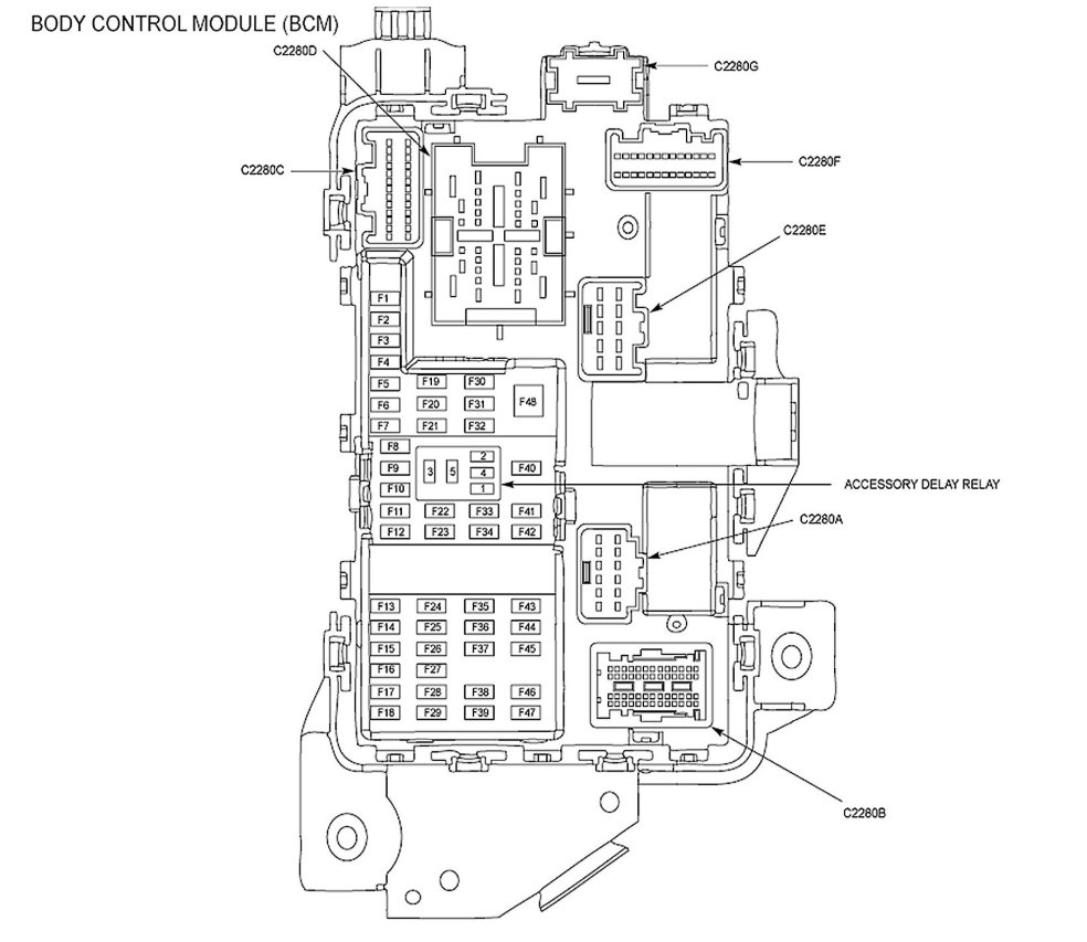

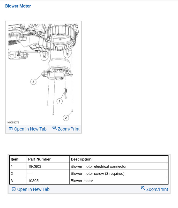

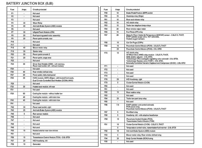

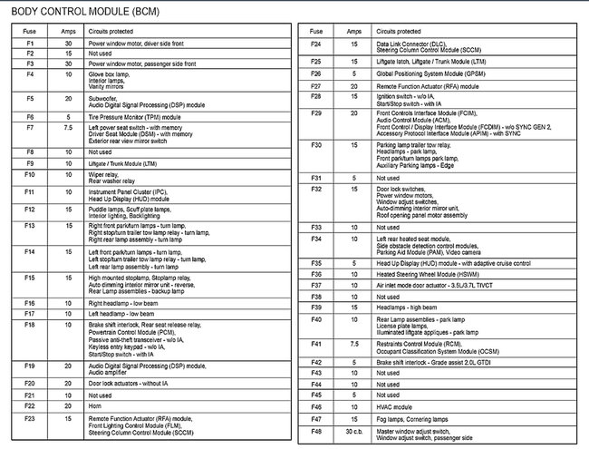

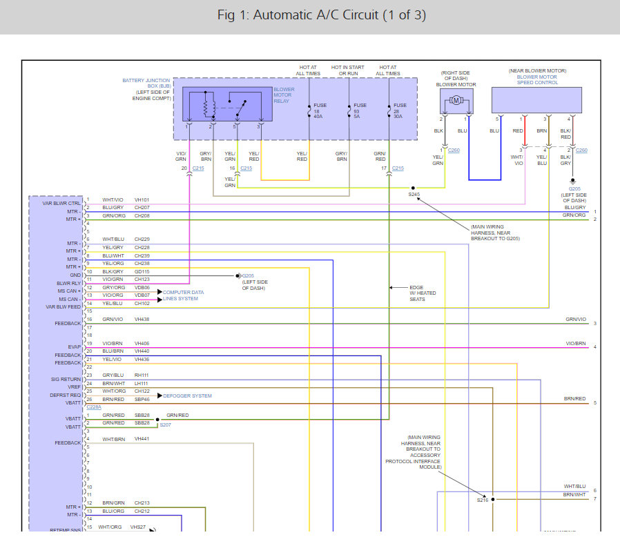

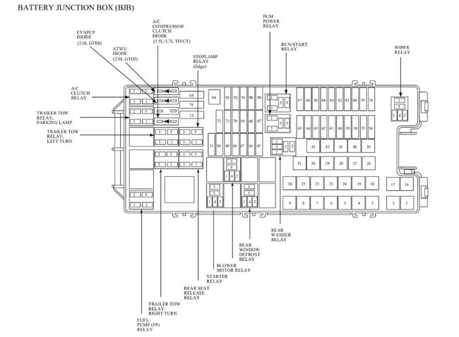

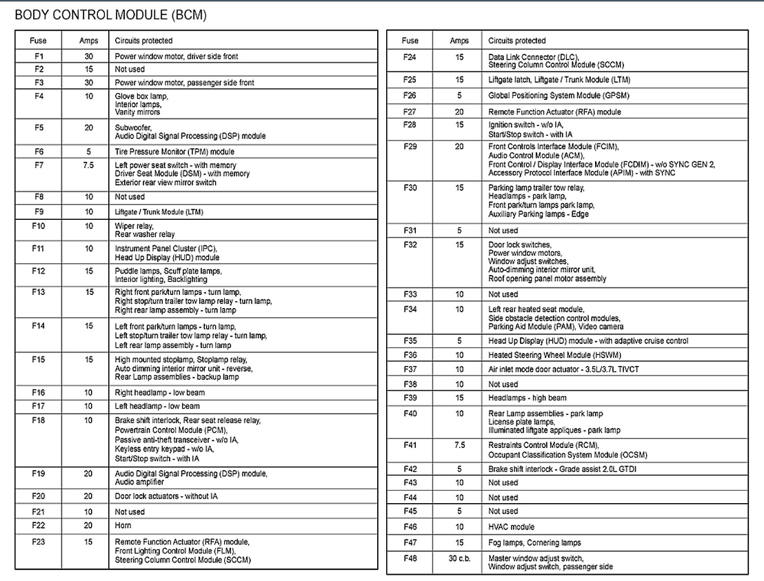

Is there a common issue with these as far as A/C blower resistors? no air coming out of vents even at defrost.
Jul 24, 2022 at 6:01 AM
  • 55,694 POSTS
It is common for the blower motors to go out. To be sure, this guide can show you how to test for power and ground to be sure. Also, I have the location and replacement instructions for your car in the diagrams below. I also have found the wiring diagrams for the blower motor so you can see how it works. There is a blower motor relay and three fuses# 18, 93 and 28 and we need to check.
https://www.2carpros.com/articles/blower-fan-motor-works-on-high-speed-only
and
and
