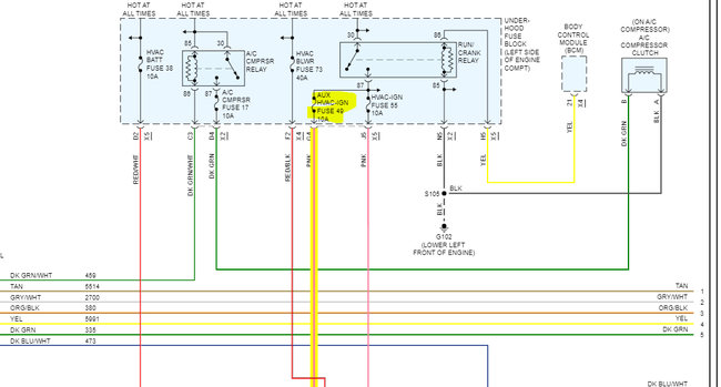

A/C is blowing cold from the dash but getting zero in the back. The rear blower motor was burnt up because of this, so replaced that and still nothing.

When you say you are getting nothing in the rear, are you referring to air temperature or airflow direction? Does the new blower motor work?

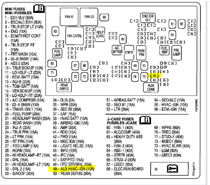

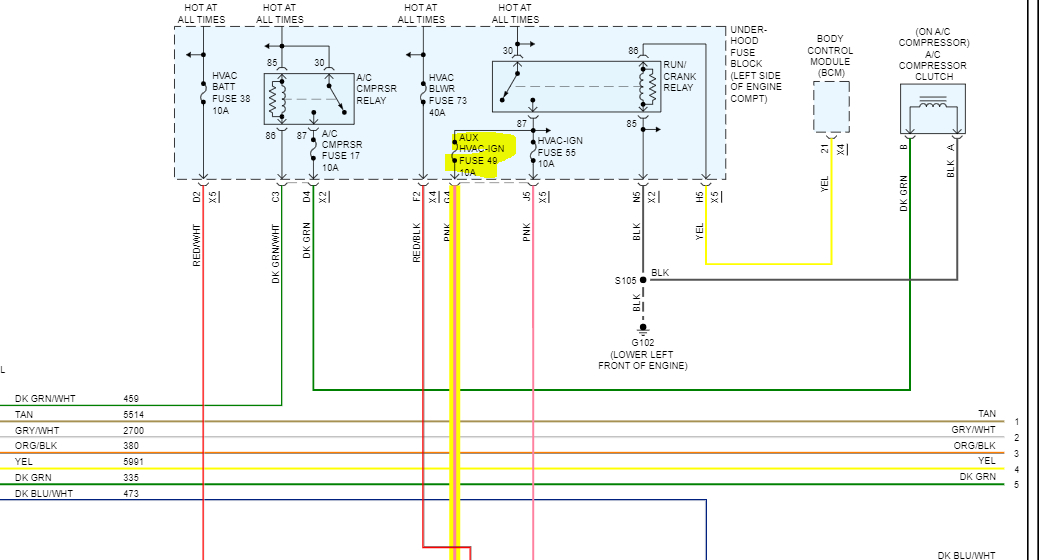

If you haven't already, check fuse 49 in the under-hood fuse box. make sure the fuse is good and confirm there is power to and from it.
If you look below, I attached pics of the wiring schematic and the fuse location. Check that fuse and let me know what you find.
