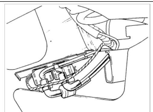

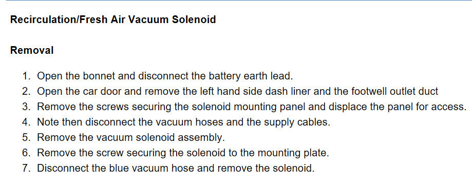

My car has blower motors running but cannot get air anywhere. I cannot find any vacuum leaks under the hood. I opened the center vents manually but still no air. I was going to try to manually open the blend flap but do not know where it is.
Jun 30, 2017 at 3:19 PM
JAMES STONE SR
Did some further checking. I have vacuum to the box under the battery but don't have any under the dash
Jun 30, 2017 at 6:49 PM
HMAC300
  • 48,601 POSTS
unfortunately we do not have any vacuum diagrams of the heating system. your car does not have a blend door it has a hot water valve in heater hose. I did find a solenoid for recirculate/fresh air which is on pass side here is some instructions and a picture of another solenoid nearby for help as you may find a vacuum line off. See pictures.
