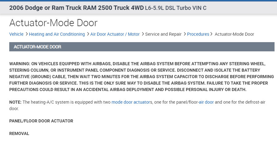

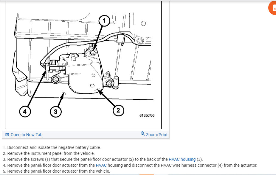

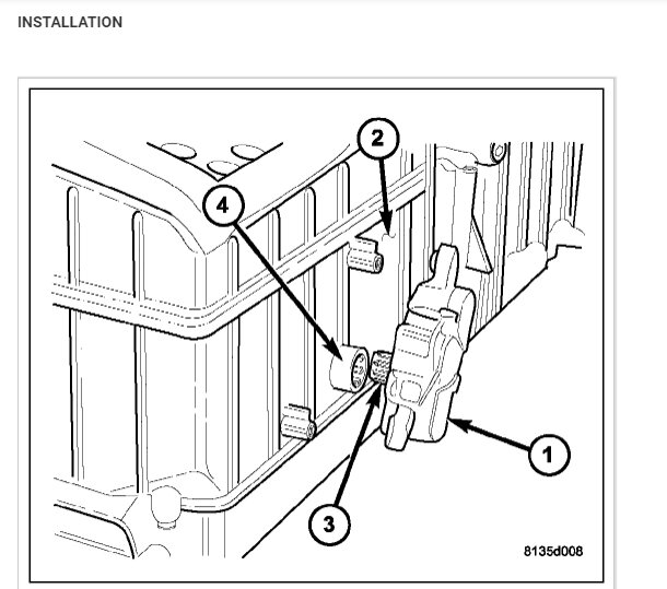

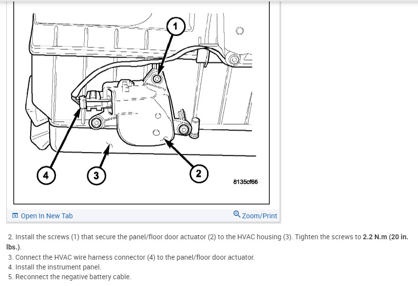

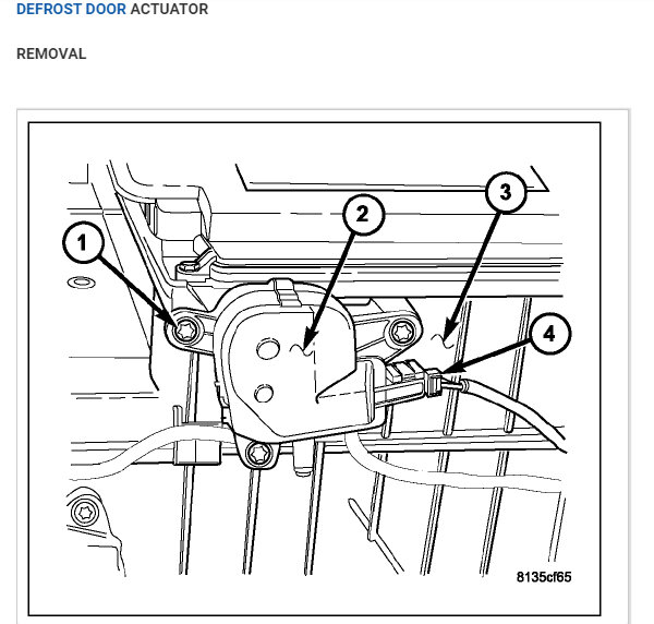

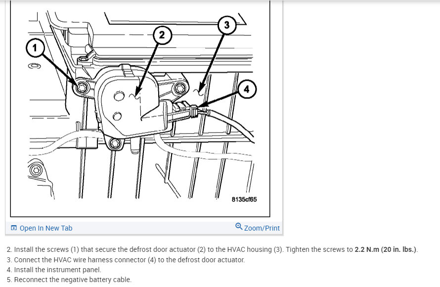

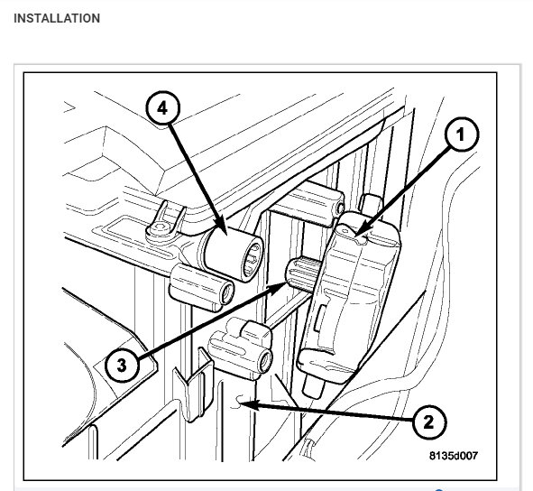

What you described sounds like it is related to what is called the mode door actuator. This actuator is responsible for air flow direction. It could be stuck between the settings.

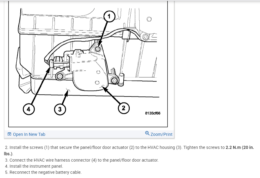

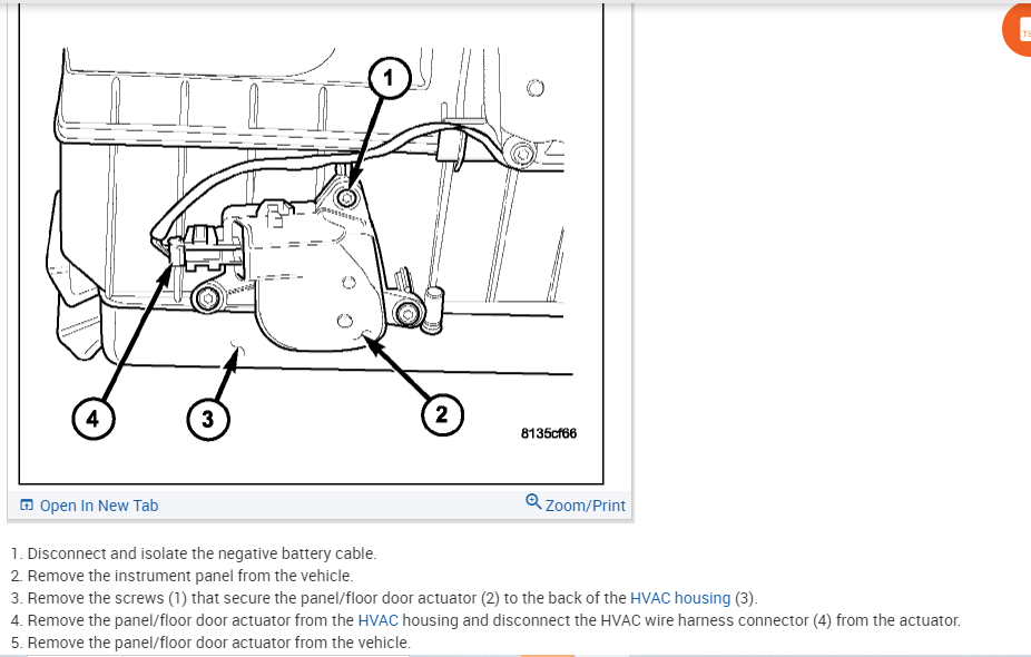

On this vehicle, there are two mode door actuators, one for the defroster and the other for the floor and panel vents.

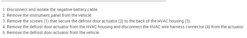

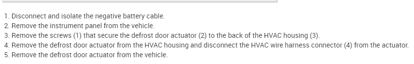

I attached the directions below for the removal and replacement of both. What I suggest is this. Remove one at a time and inspect the gears on it first. If they are good, then with it plugged in, see if it reacts when you change the air flow direction.
Let me know what you find.

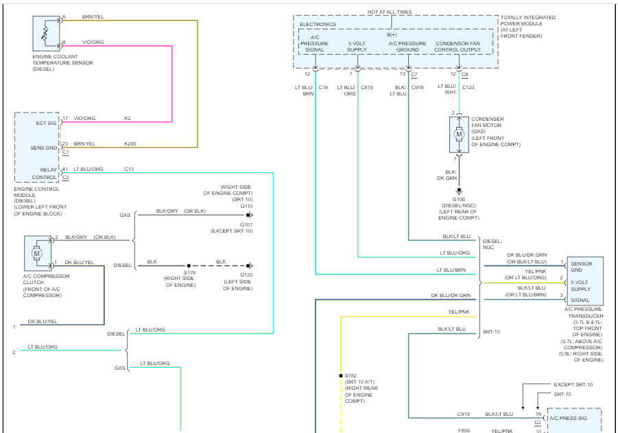

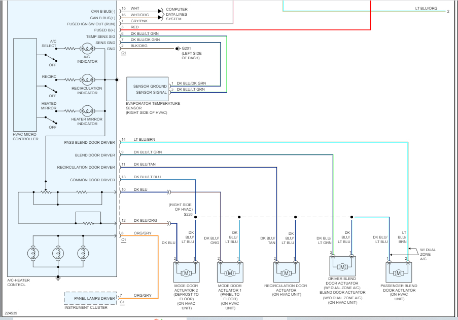

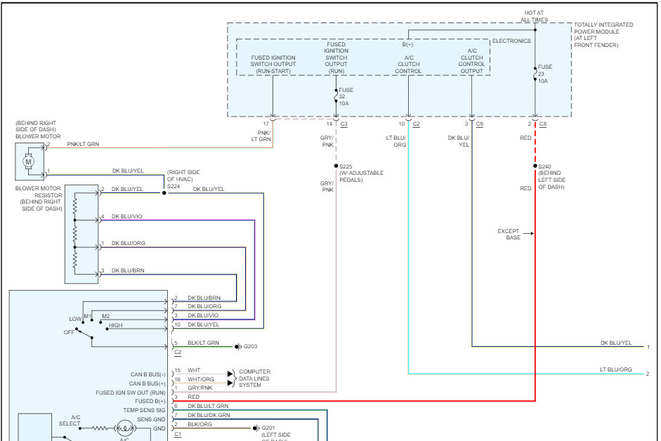

Do you have a climate control wiring diagram that you can provide? 2006 Dodge Ram 2500 Laramie Mega Cab.
All actuators work and all blend doors are intact and functioning, but the vent controls still do not work.
Jan 25, 2023 at 9:54 AM
  • 110,240 POSTS

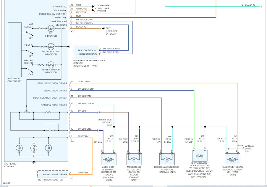

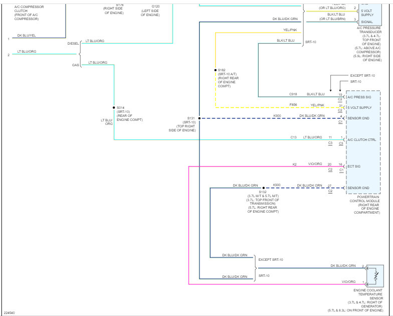

I attached the schematics below for the entire HVAC circuit. They are for a 2006 2500 with the 5.9L. There is no listing for the Laramie mega cab, so I suspect they are the same.
Let me know if this helps.
See pics below. Note: The schematic was two pages. I cut each page in half to make them readable for you. I did overlap them so you can follow from one to the next.
