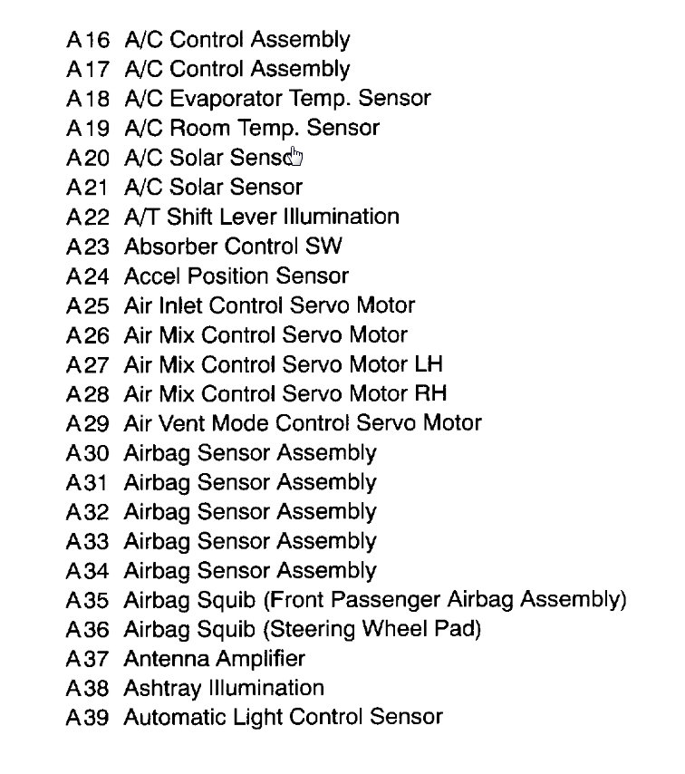

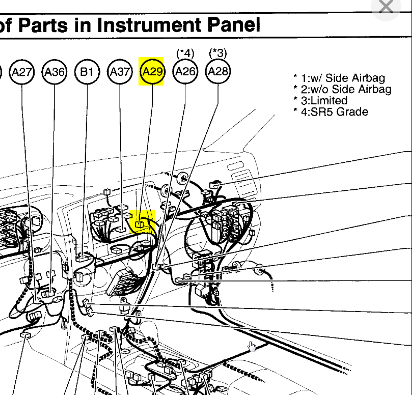

No control of vents and assume this is a vent control servo motor issue. where is this located?
Sep 28, 2019 at 3:42 PM
I attached the location. Unfortunately Alldata does not have specific step by step on how to replace this. However, these are normally accessed by remove the glove box and getting to the air box. Should be just to the left and on top of the air box.
Let me know if you need more info. Thanks
