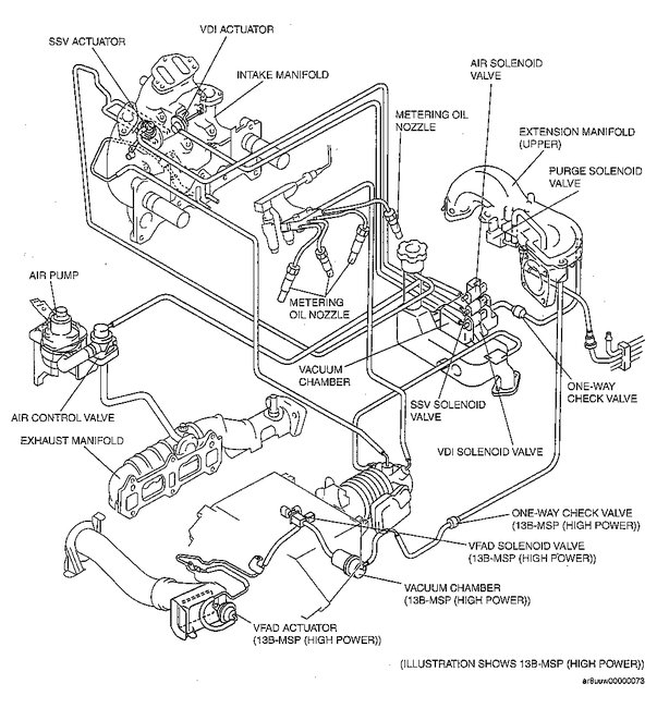

was checking for a vacuum leak and pulled them out and do not know where to put them back. it is the two hoses coming out from top of throttle body.

can we have the sub model please, so we can find the right vacuum diagram.

This is the air intake hose diagram for the sport sub model. If this is not the correct one let us know.

Yes, that is the correct diagram. i am having trouble with the hose that leads to the meetering oil nozzle. is there a nipple or something for it to plug into?

Did this line break on you? if you just pulled the air line off, what is the reason you cannot put it back on to where it came off of? I have not seen a rotary engine in years and I am having trouble locating the exact air line connector at the nozzles. there should only be one vacuum line going to the nozzles from the throttle body.

sorry for small picture, but is this the connection you are referring to?
