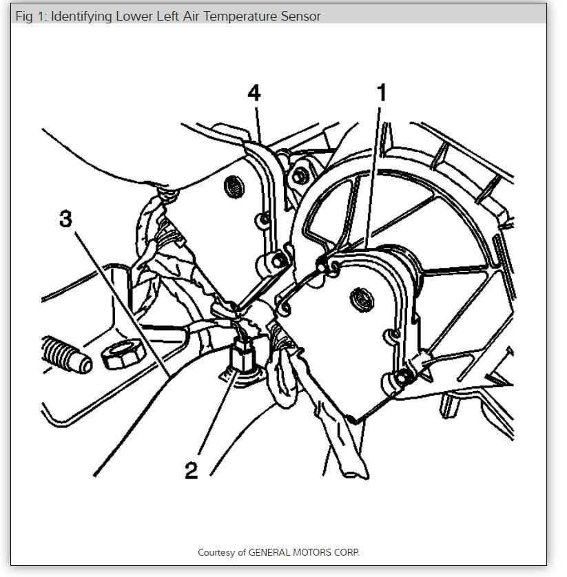

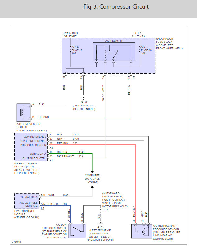

The temperature gauge does not show any temperature, the air conditioner will not click on when it does it, it will come on randomly and then the air conditioner will work.

Can I ask if the temperature gauge you are referring to is outside temperature or climate control temperature? (What you set)
Please let me know, Ken
Sep 17, 2018 at 5:41 AM
JESSICA MATUSIK MARLATT
The inside gauge.
Sep 19, 2018 at 12:26 AM
  • 55,112 POSTS

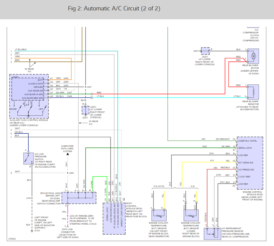

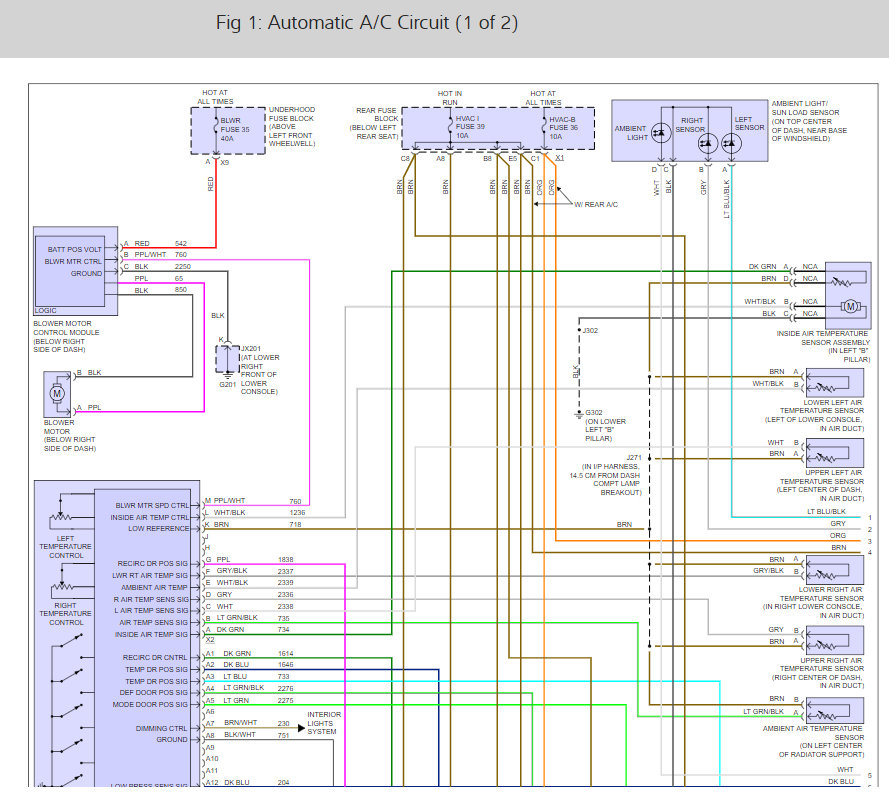

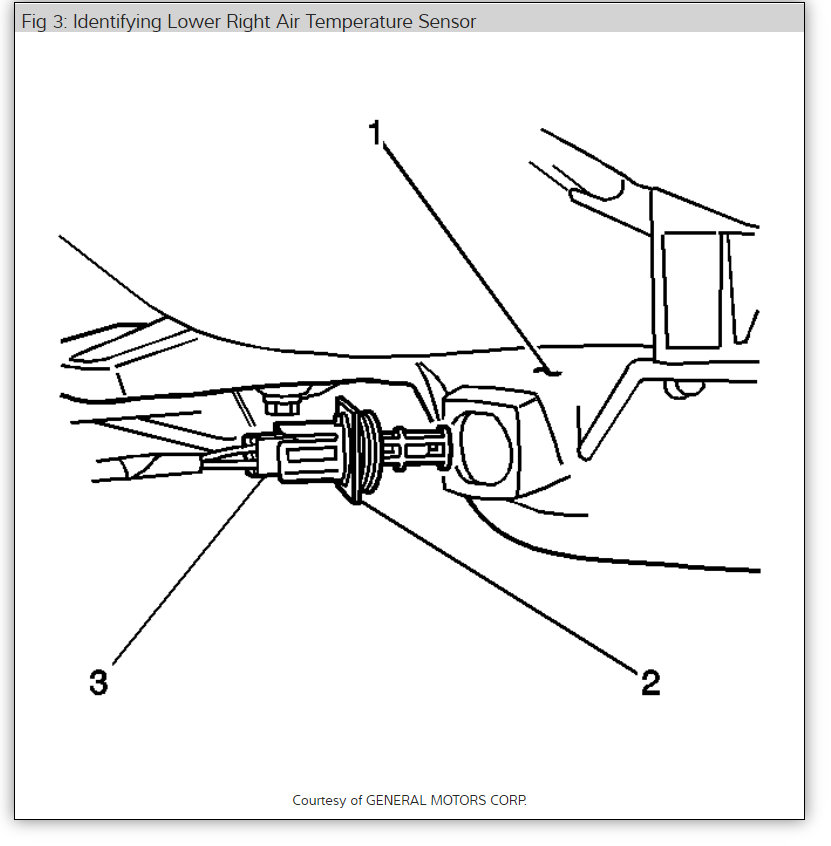

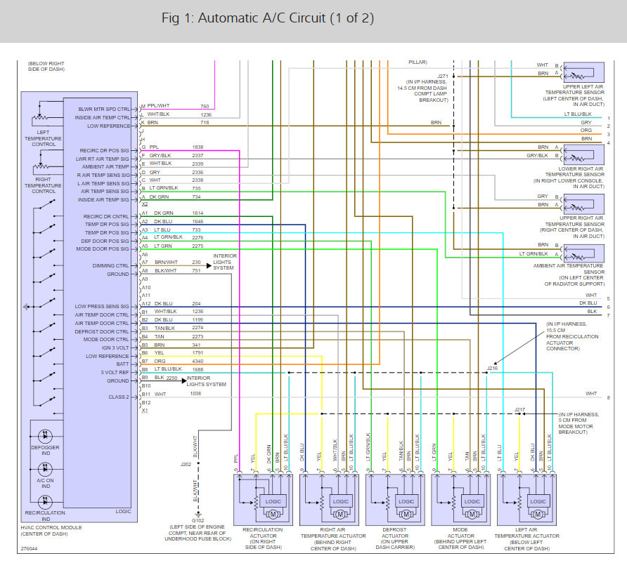

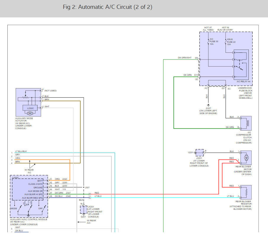

It sounds like you have an ambient temperature sensor that is out. There are two for this system or the controller is going out. I would remove the sensors to check the electrical connections for corrosion caused by moisture first. Here are the sensor locations and the air conditioner wiring diagrams so you can see how the system works. You can also have the HVAC system scanned at the shop for a trouble codes it should cost about $70.00.
