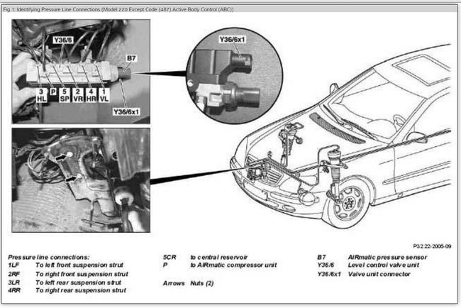

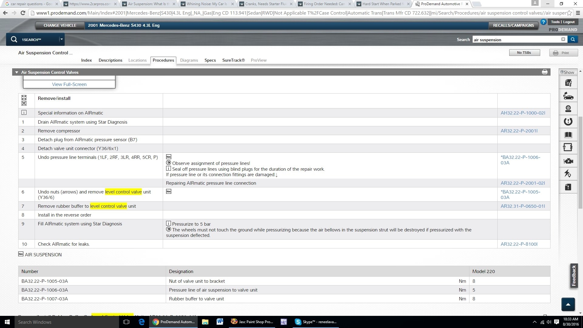

What is the procedure in replacing the valve block on the air suspension system?
Aug 23, 2016 at 7:24 PM
RENEE L
  • 1,260 POSTS
Sorry for the slow reply, we have been really busy. Here is what you need to do the job, please let us know how its goes. Check out the diagrams (Below). Please let us know if you need anything else to get the problem fixed.
