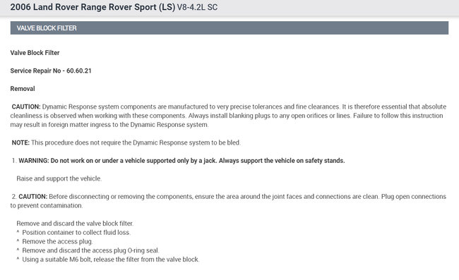

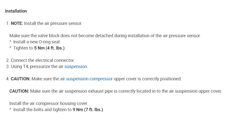

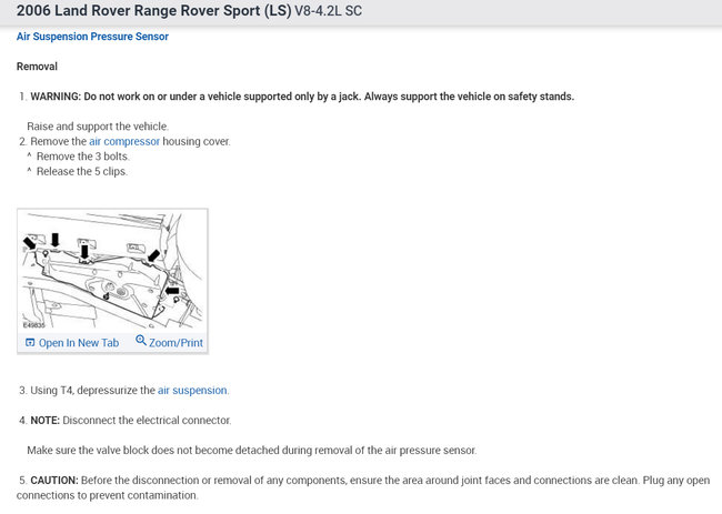

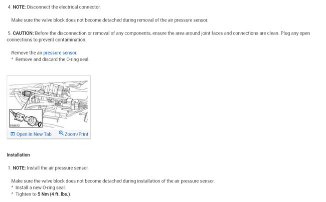

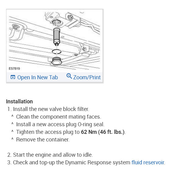

It sounds like the middle valve block is not working correctly and not exhausting or not allowing air through it in the allotted time, so the system shuts down and gives the code C1A13. This system has a valve block filter, did you replace that as well? Check the diagrams below so you can see what I am talking about.

no, sorry, I do not even see a valve block filter as pictured. The car has an aftermarket Hitachi compressor. I Had a local shop, (most won't touch a range rover) remove and replace the middle valve block with a new one per a Land Rover mechanic instruction, three valve connections, he said simple no reprogramming needed. The shop is not interested in diagnosing the problem. When I try to raise the car the suspension fault stops the raising. I clear the fault by turning off the ignition and if I hold the raise button pushed it does not fault. Unfortunately, the fault appears on the dash
before it can raise enough. The Land Rover mechanic would have said something about a filter, he advised to buy a new middle valve block which I did. Any guesses?
