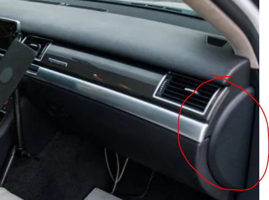

Where is the air compressor fuse or relay for this car?
2009 AUDI S8
105,000 MILES • V10 • 4WD • AUTOMATIC
DIVIDES
  • 903 POSTS
Air suspension fuse fuse or relay location needed.
Sep 6, 2021 at 9:22 AM
SQM
  • 6,383 POSTS
There is a fuse located on the right side of the dash fuse box. Look at the picture below.
It should be number 10 and a 10A : Suspension level control system
That is the only fuse that is listed as the suspension for this S8.00.
Let me know what issues you might be having.
