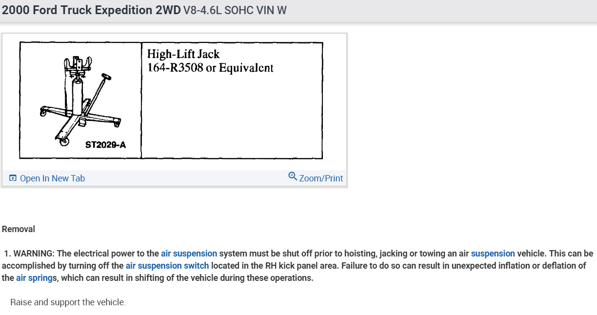

Is it okay to drive my vehicle with the air suspension off?
Oct 4, 2018 at 3:38 AM
  • 55,694 POSTS

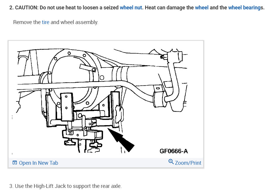

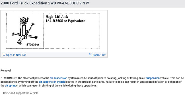

Unfortunately no it will slowly leak out and the ride height of the car will become very low. What problem are you having?
Oct 6, 2018 at 9:22 AM
LAURIE HOFFER
  • 48 POSTS

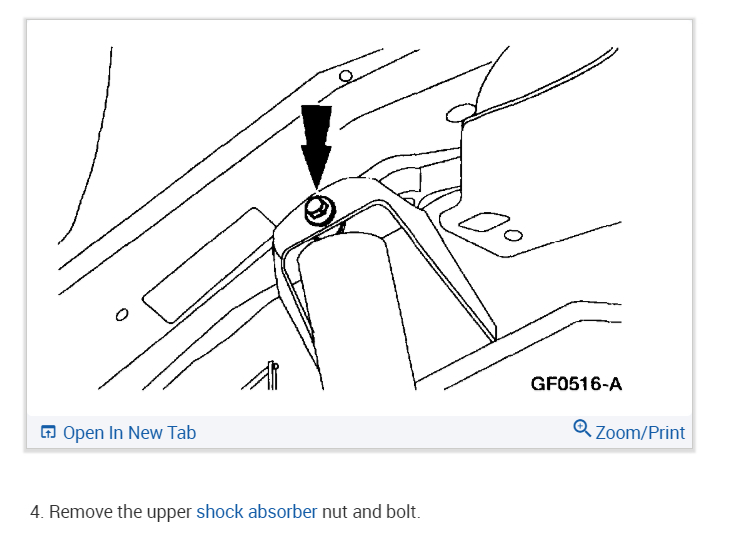

My light comes on and off at times it and seems the compressor runs all the time.
Oct 6, 2018 at 11:44 AM
  • 55,694 POSTS

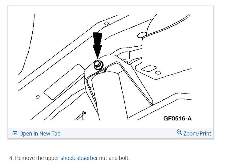

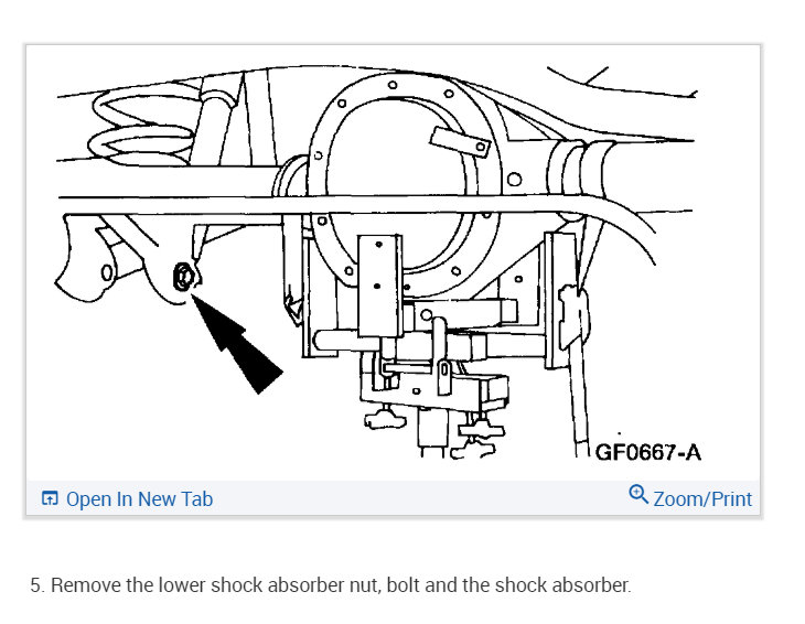

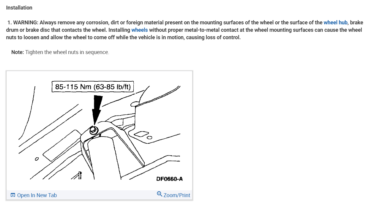

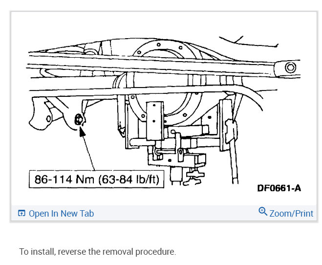

Yep this is common, what happens most of the time is the rear shocks leak. Here are guides to help you change them out. You can get new shocks on Amazon or RockAuto.com
