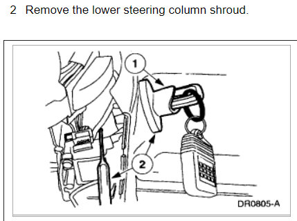

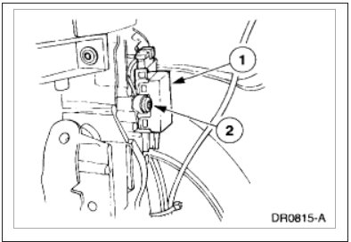

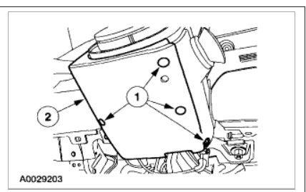

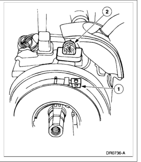

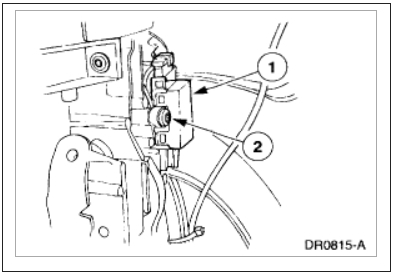

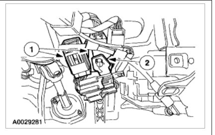

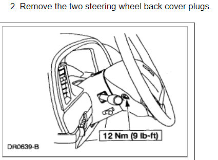

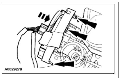

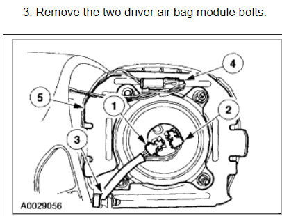

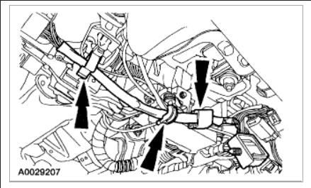

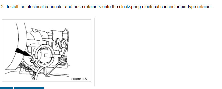

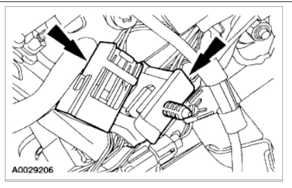

How do I remove the drivers side rear air spring?
Jan 7, 2018 at 12:28 AM
Experienced Mechanic
55,694 POSTS

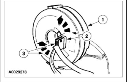

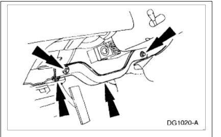

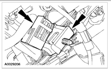

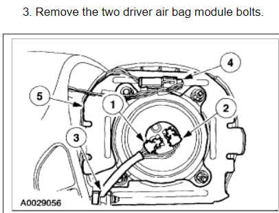

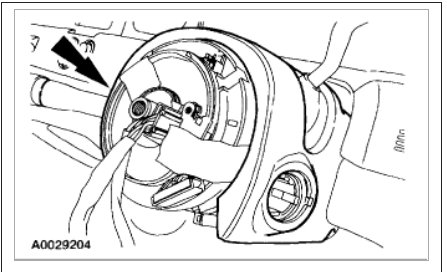

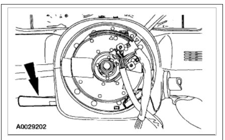

You must disconnect the battery first so the airbag doesn't go off.
Here is a guide to help you see how:
https://www.2carpros.com/articles/air-bag-removal-steering-wheel
Then you will need to take the steering wheel off. Yours will need a puller
https://www.2carpros.com/articles/steering-wheel-removal
And this guide shows the clock spring.
https://www.2carpros.com/articles/steering-wheel-clock-spring-removal
Below are the diagrams to show you what it will be like for your car.
