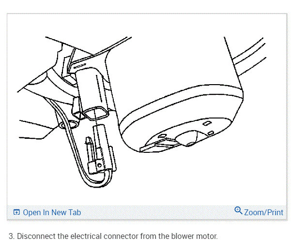

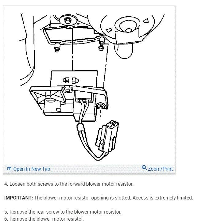

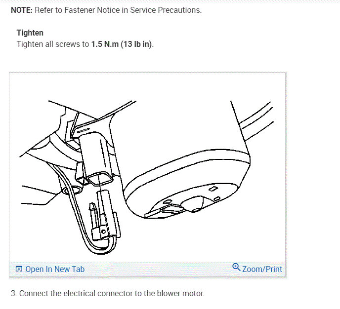

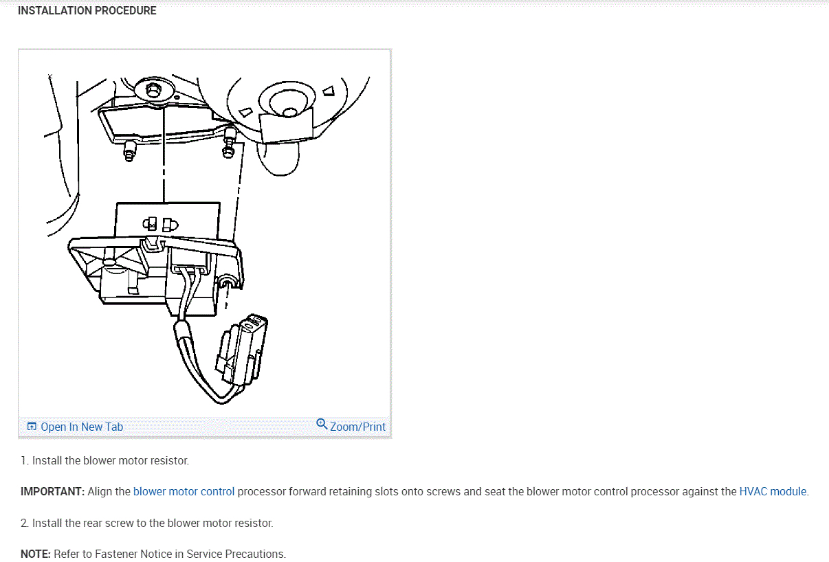

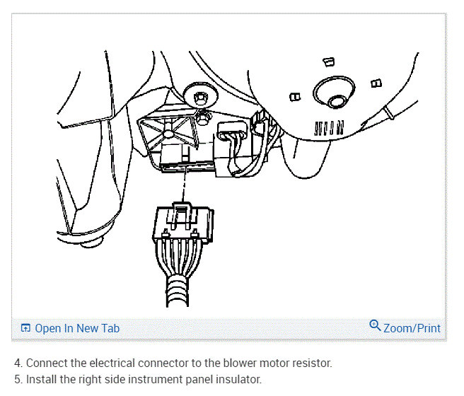

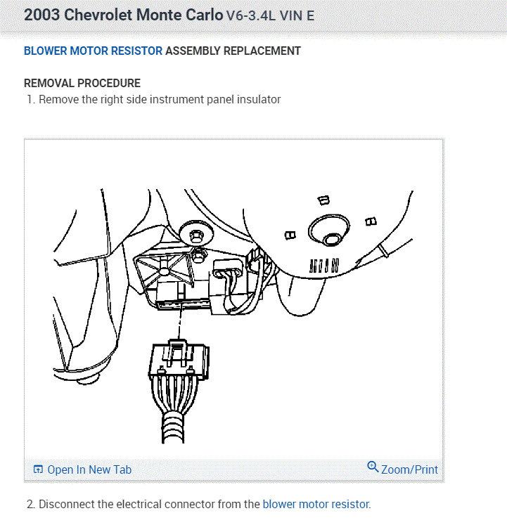

The most common cause of it only working on high is a faulty blower motor resistor. This part is located under the dash, passenger side, at the blower motor housing.
I attached the directions below specific to this vehicle for replacement. This is what I suspect is causing the problem for you.
Let me know if this helps or if you have questions.
