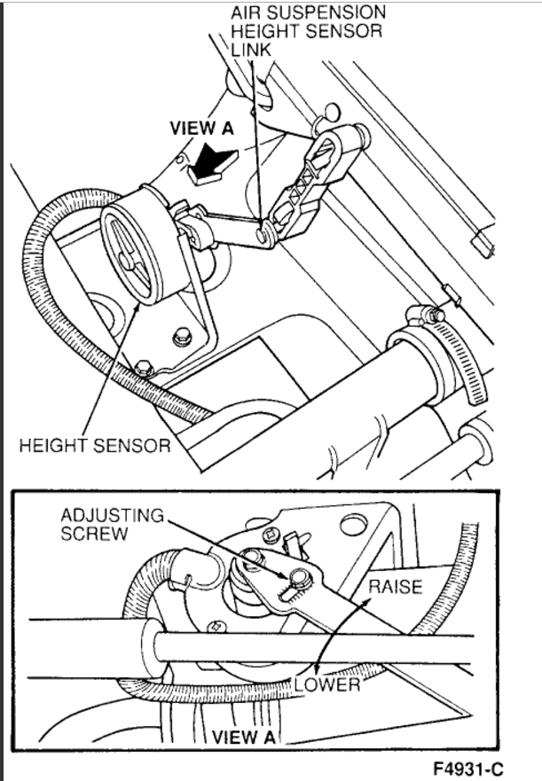

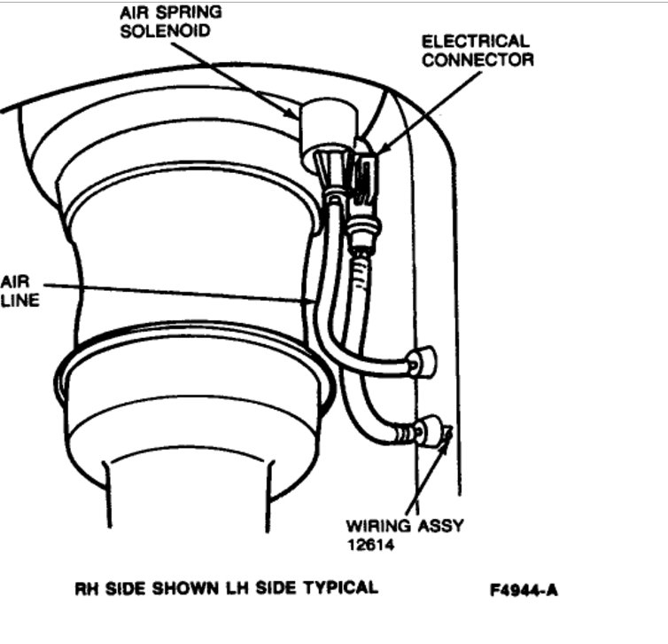

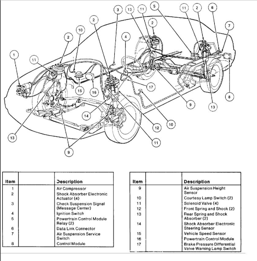

try to remove the driver side rear air shock/bag to get to the top of it. I can here the air leak coming from this area, from inside the trunk. any help ?
Sep 3, 2017 at 6:36 AM
  • 55,214 POSTS
Yep the air bags have a valve at the top of them which can leak or the air bag itself needs to be replaced.

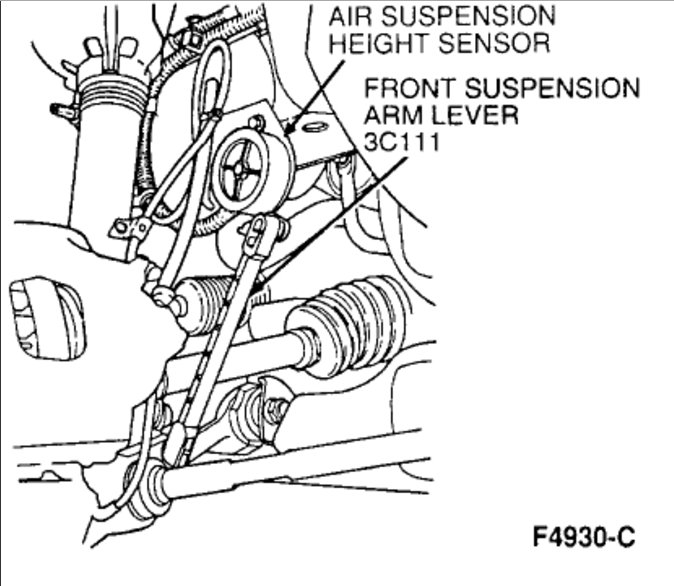

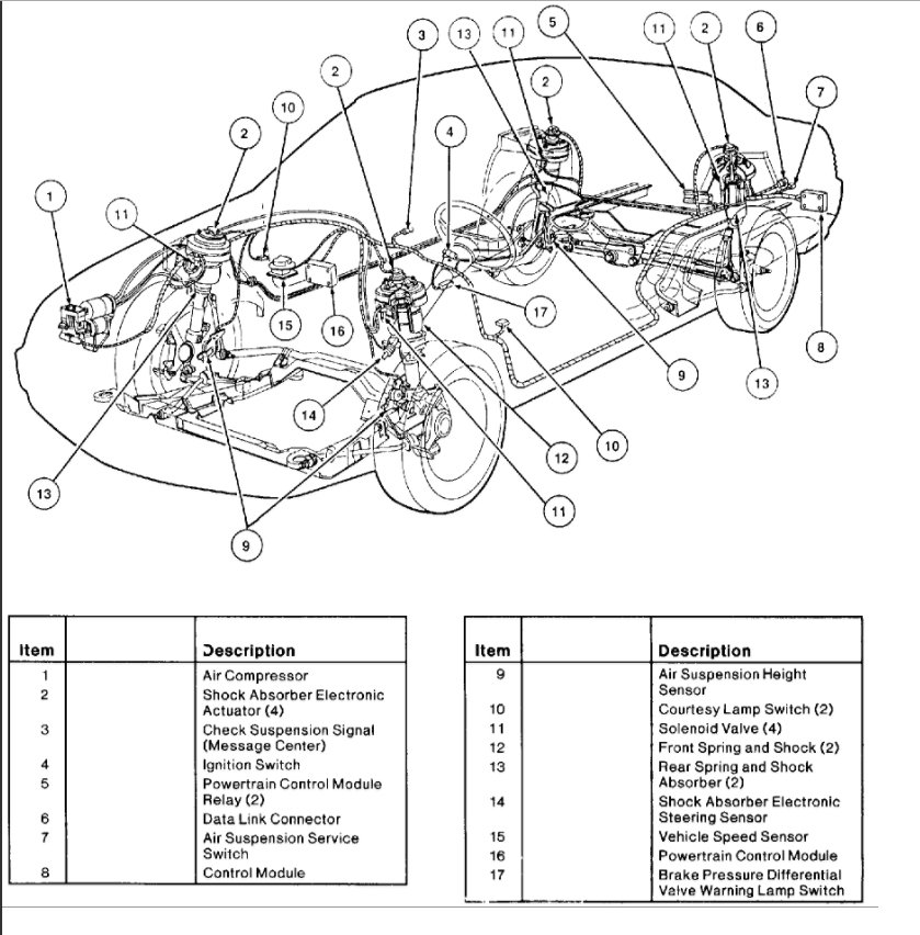

Here are some diagrams to help you:
