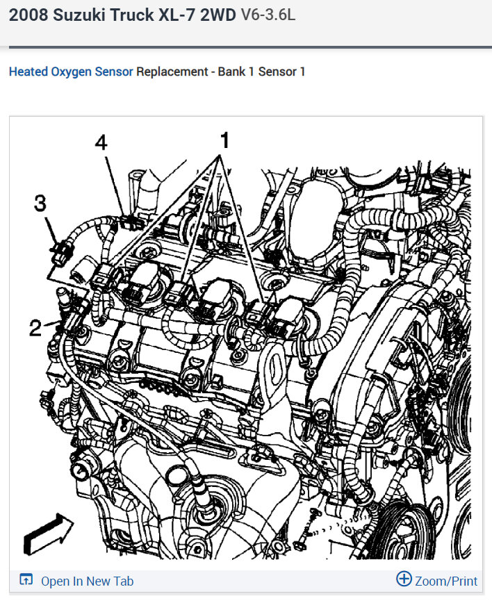

I do not know where bank is located. 2 banks sideways in engine area. where is bank 1, sensor 1.
Feb 14, 2024 at 1:50 AM
  • 55,837 POSTS

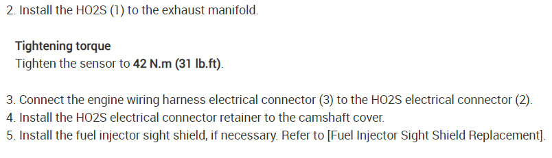

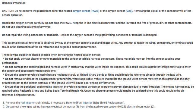

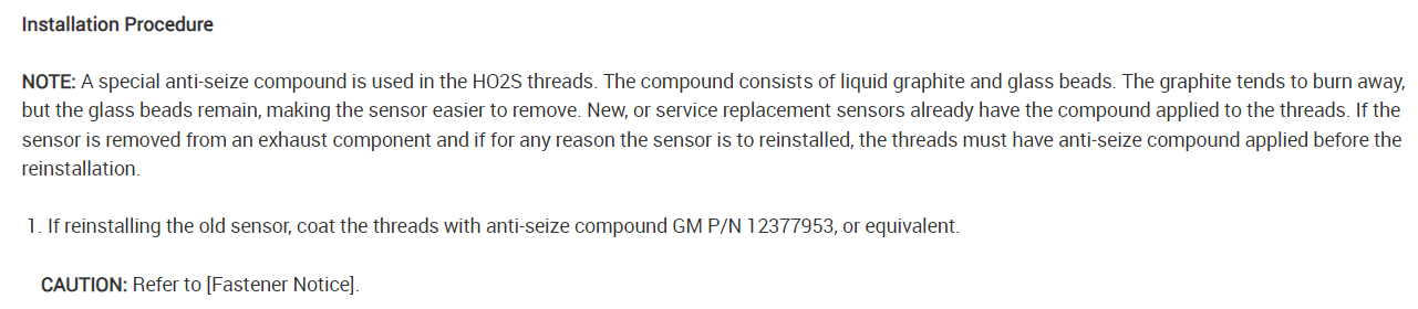

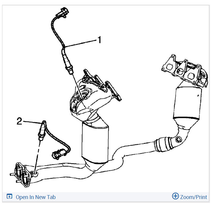

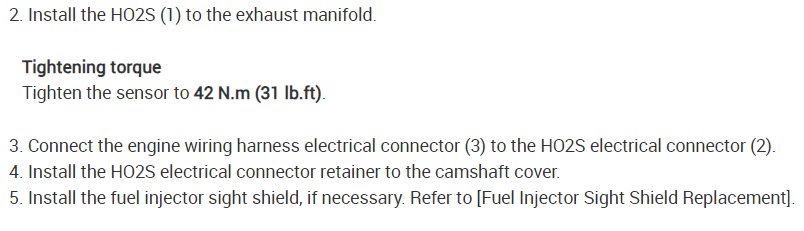

The bank 1 sensor 1 oxygen sensor is on the right side of the engine (near the firewall). Here is a generic guide to help you step by step with instructions in the diagrams below to show you how on your car:
https://www.2carpros.com/articles/how-to-replace-an-oxygen-sensor
Check out the images (below). Let us know if you need anything else.
