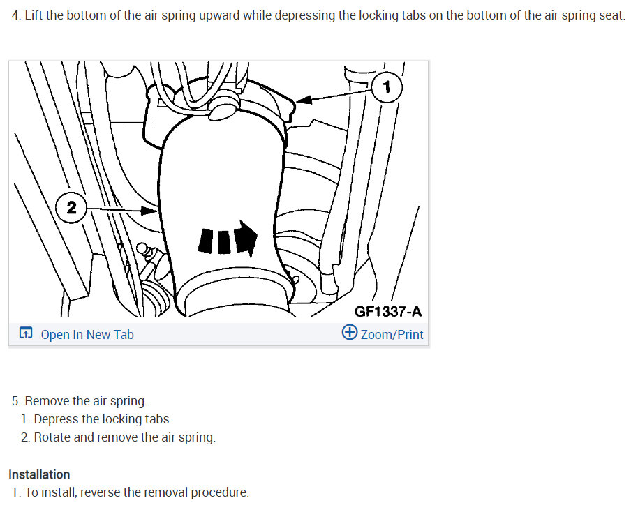

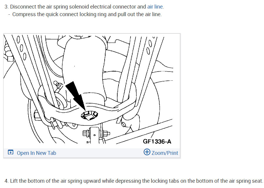

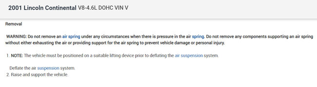

It sounds like you have a large air leak in the system, the compressor will only run so long that the system shuts down, so the compressor doesn't overheat. I would inspect the air pressure lines for cracks or disconnected lines, other air bags that are bad. This is a common problem with this car. You can get regular replacement shocks to delete the air suspension all together. Here is the kit on amazon for $125.00:
https://amzn.to/3YglgWt
Check out the images (below). Please upload pictures or videos in your response of any problems so we can see what to help you with.
