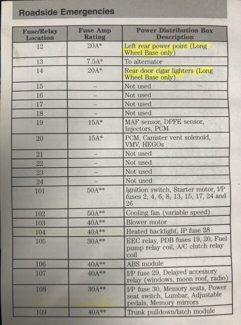

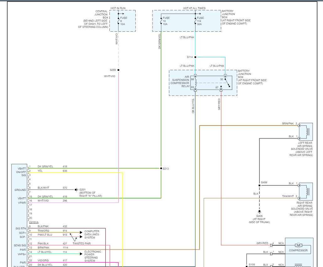

First, there are three fuses that are related to the air ride suspension. I need you to check them. See pic 1 below. When you check the fuses, confirm there is power to and from them.
If they are good, then go back to the relay and remove it. On the relay, you will see that each pin has a number assigned to it indicating what it does. I need you to first locate pins 86 and 30 on the relay. Then determine which connector pins they go to in the box. Check both for battery voltage. They should have power at all times.
If they do, take a test light and connect the alligator clip to the battery-positive terminal and probe (in the box) where pin 85 would connect. With the key on, the test lamp should turn on because a ground path is provided via the suspension module actuating the relay.
Let me know what you find.

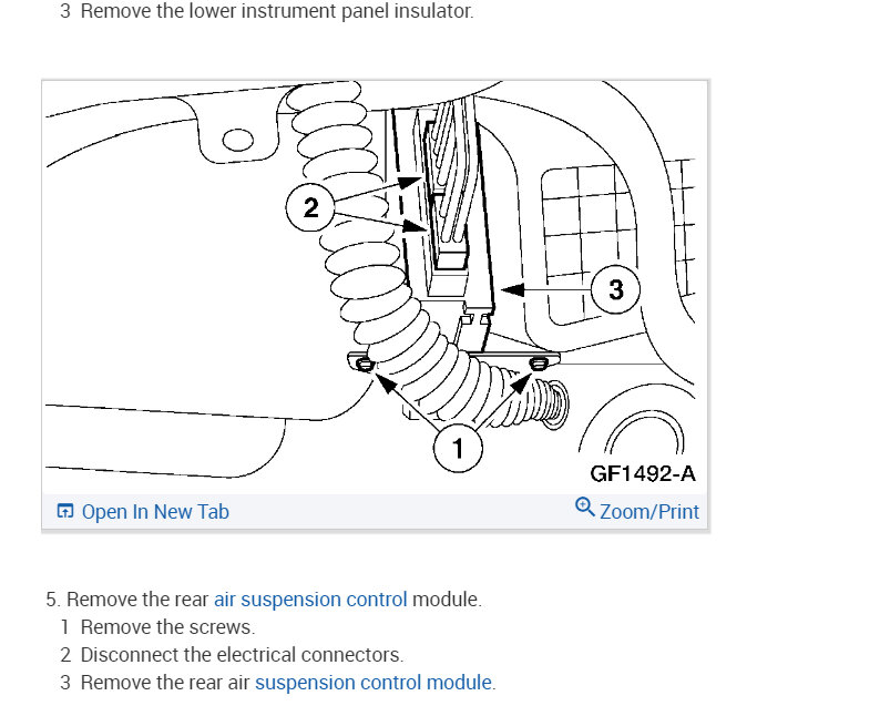

Do you have power at the fuse for the system? Fuse # 114, # 10 and #8? If so, check the ground to the air suspension control unit and if so, replace the air suspension control unit.

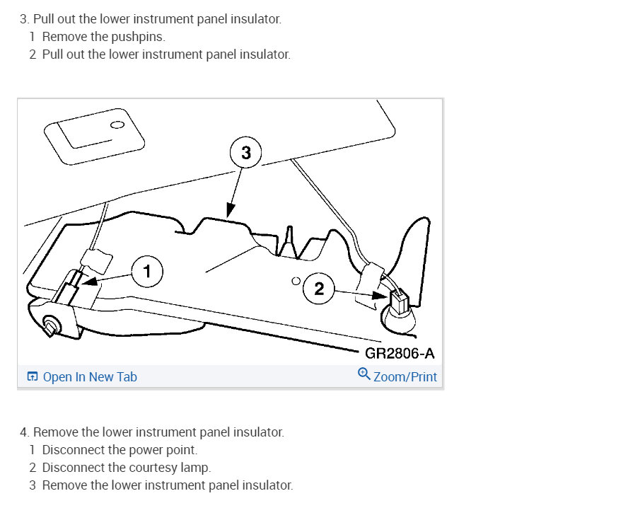

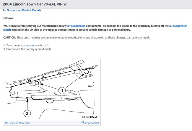

Here is a guide to help you check the power and grounds:

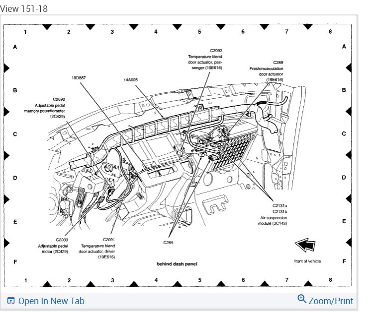

Here is the module location so you can check it out.
May 11, 2023 at 11:02 AM

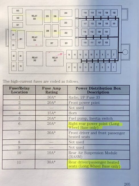

Power to #114 yes
Power to #10 yes
#8 is not in use empty from the factory

5 pin Relay Sockets in the bottom of the “POWER DISTRIBUTION BOX”
Test light test
#30 All light
#86 2 light
#85 1 light
#87 No light no power
Power Yes
#86 Relay sock 304 & 303
Power Yes
#85 Relay. Sock 301
No power to
Sock #19 is for the MAF sensor DPEE sensor Injectors PCM
Sock# 20 is for the PCM Canister Vent Solenoid, UMV, HEGOS
Fuses Good

Is the air suspension control unit, the same for all panther body cars?
May 12, 2023 at 12:40 AM
  • 55,511 POSTS
Yes, is should be, is the control unit getting power and ground?
May 13, 2023 at 3:02 AM
2004 LINCOLN TOWNCAR
  • 9 POSTS
No power but ground is good.

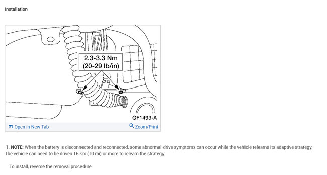

Do you have a more detailed drawing or pictures demonstrating the removal of the air suspension control module?
The last one you supplied is not a match for this 2004 Lincoln town car.
May 14, 2023 at 2:00 AM
  • 9 POSTS

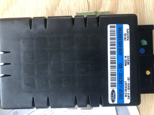

The air ride suspension control module is out. Looks to be undamaged. What is the testing procedure to determine its work ability?
May 14, 2023 at 11:05 AM
  • 55,511 POSTS

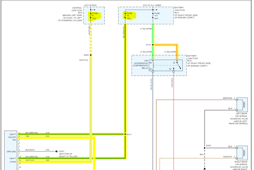

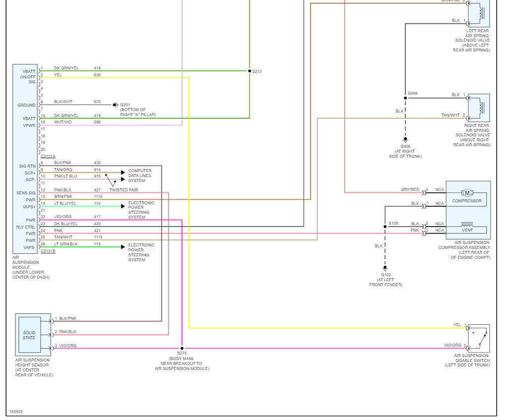

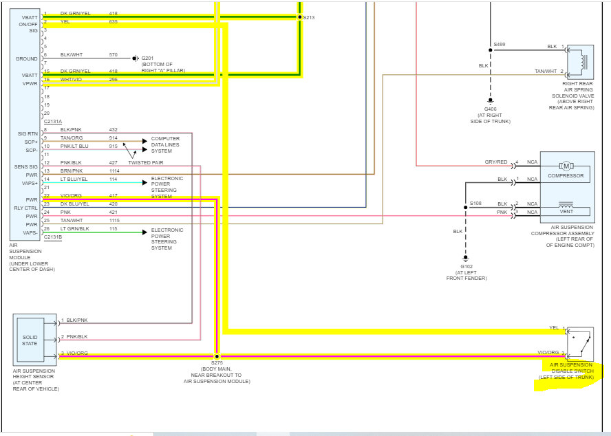

The best way to test it is to replace it. There is no easy way to test it. Here are the wiring diagrams so you can see how the system works. Check out the images (below). Please let us know what happens.

I have already located the drawings
Now I am looking for one to replace it with.
Interesting!
The Dealership is out, I checked, it is not in the dealer books.
Most units show up on eBay but the numbers don’t match.
Something about the first number to do with the year.
Next
May 15, 2023 at 6:39 AM
  • 9 POSTS
Do you have any input on how to read the numbers?
May 15, 2023 at 7:31 AM
  • 55,511 POSTS
Nope, you must call the ford dealer.
