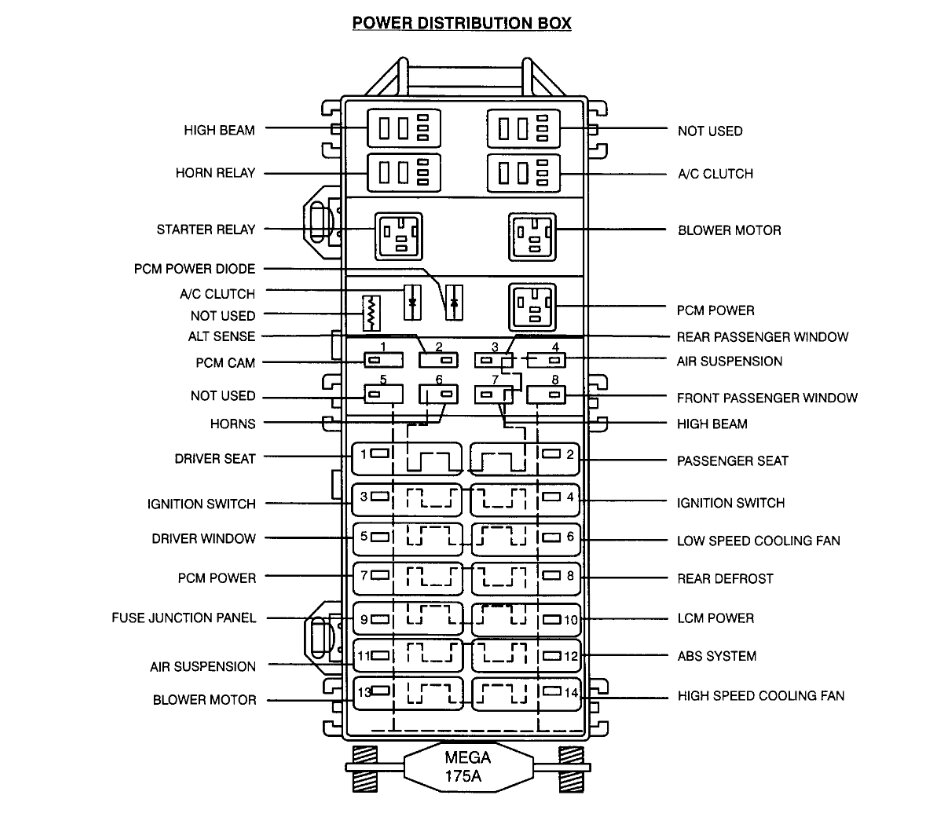

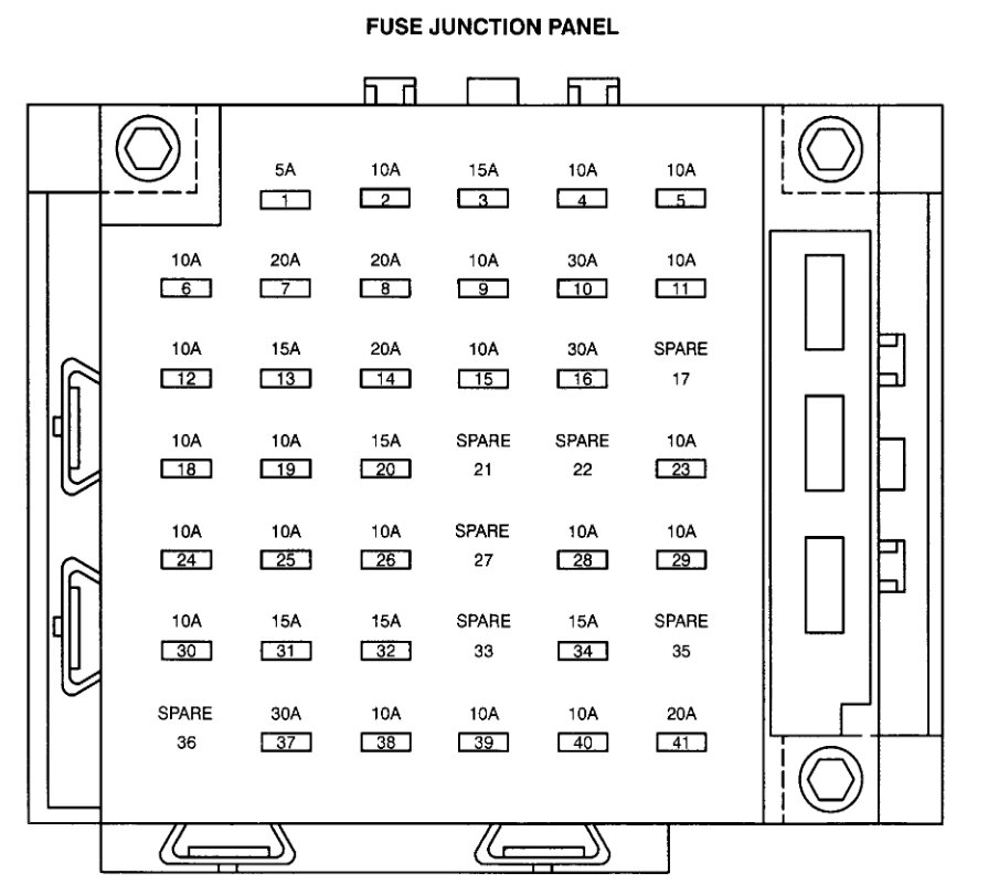

changed rear airbags, changed the air compressor, and the car still sags in the back.
Apr 10, 2023 at 6:03 AM
  • 55,721 POSTS

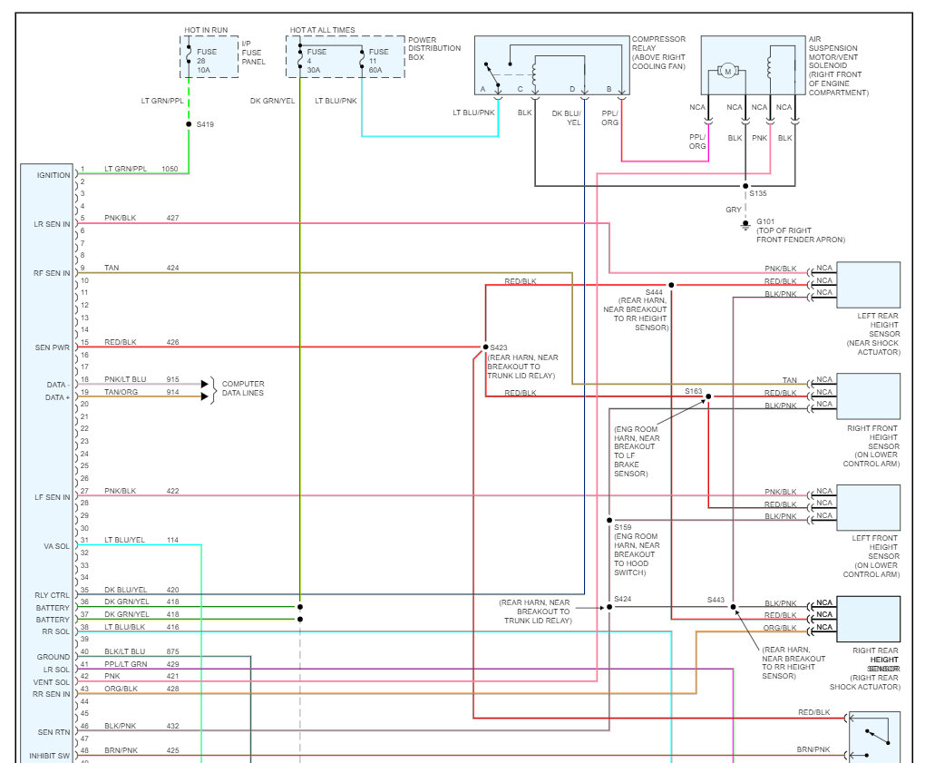

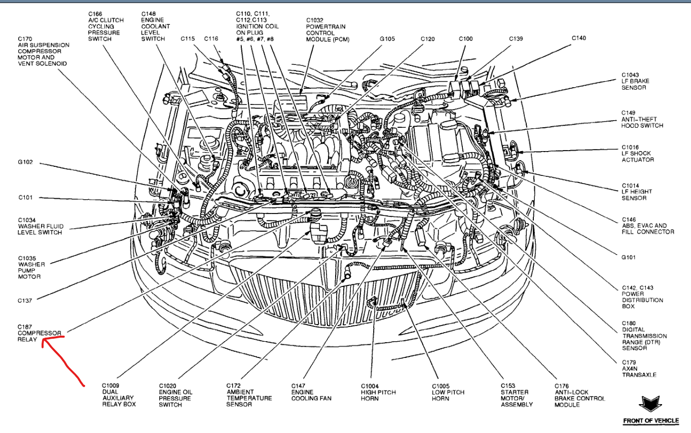

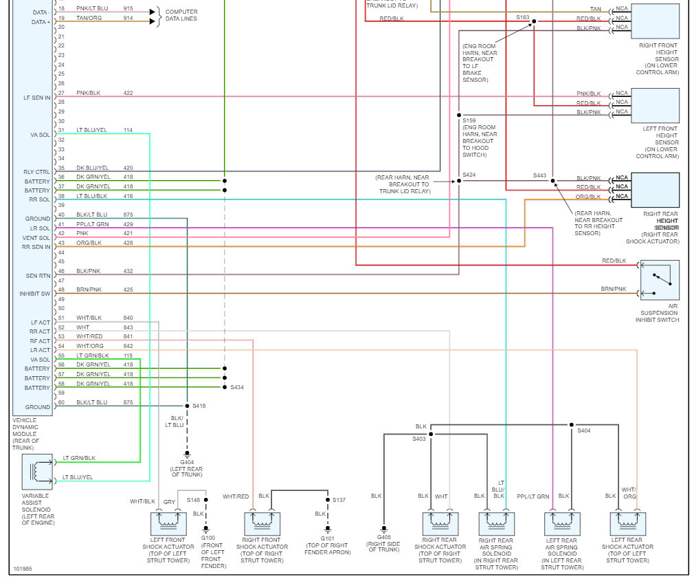

When you turn the key on do you hear the compressor running? If no I would check the fuse #28 in the interior fuse panel and fuse number 4 and 11 in the fuse panel under the hood. If the fuses are good let's swap out the compressor relay above the right cooling fan.
Here is a guide to help and the air suspension wiring diagrams so you can see how the system works:
