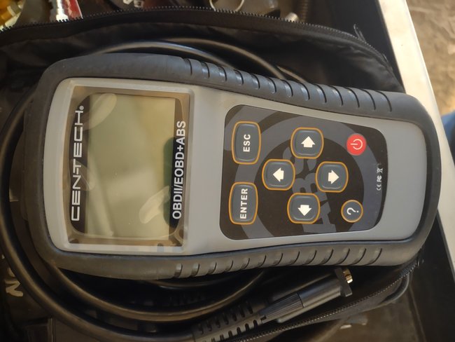

Yes, the compressor is running. And I have Cen-tech OBD2/E obd+ abs Scanner will that work, or do I need to purchase another one? I attached a picture of it.

I'm not familiar with the scanner. If it could read the can-bus codes, it would likely say it on the scanner.
You can get them on Amazon for good prices. However, you may want to contact a shop and ask if they would do it for you. The lower-end scanners may not do the job.
