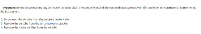

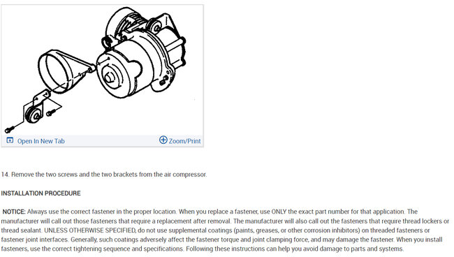

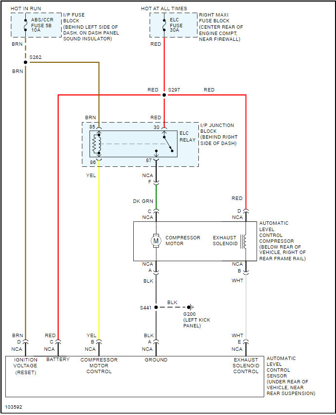

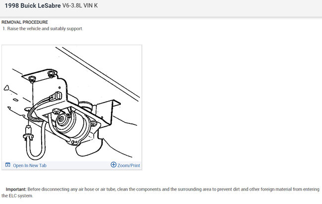

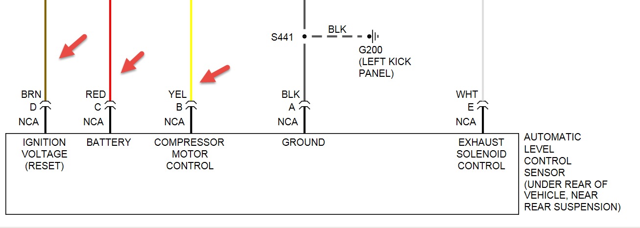

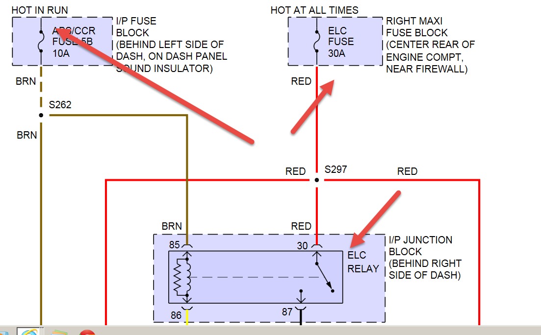

you can check fuses underhold and relay as it should be marked inside cover. check items in pics see if motor gets power with key on then goes to motor via yellow wire if it does that will help then you have to check for leaks on lines and shocks with a spray bottle. Check out the images (below). Let us know how it goes
Jan 17, 2015 at 5:31 PM
  • 54,837 POSTS

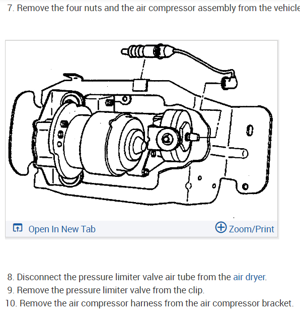

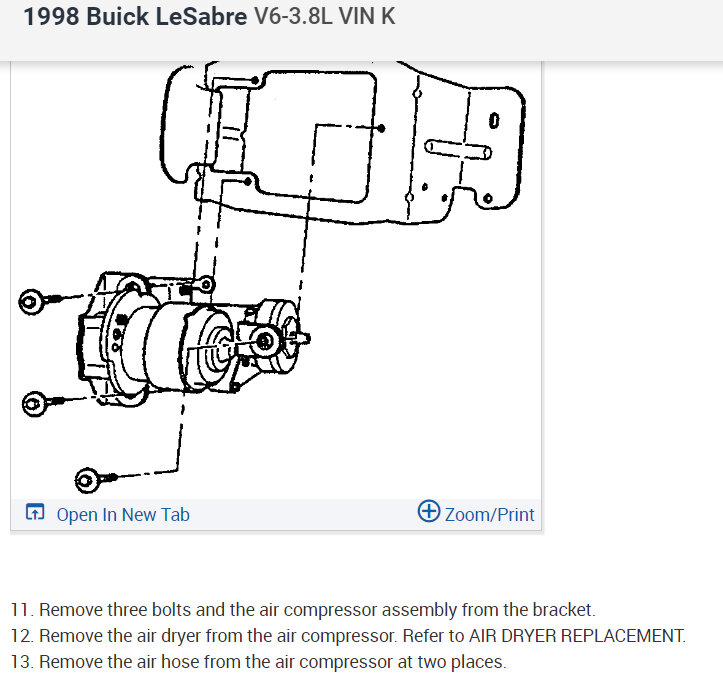

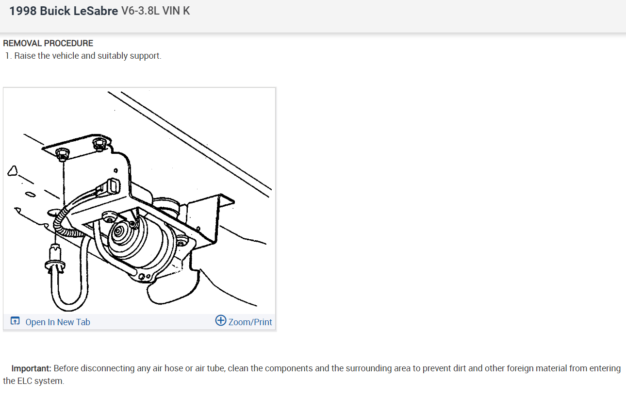

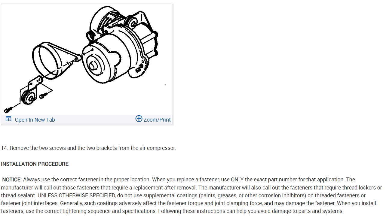

It is easy to check the compressor just remove it and put 12 volts to it. Here is the location of the compressor pump so you can check it out. The black wire is ground FYI. Check out the images (below). Let us know how it goes
