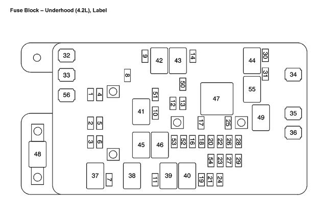

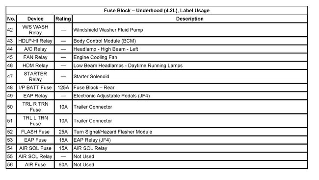

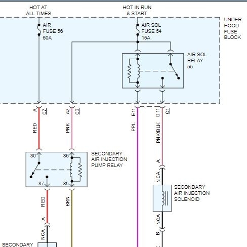

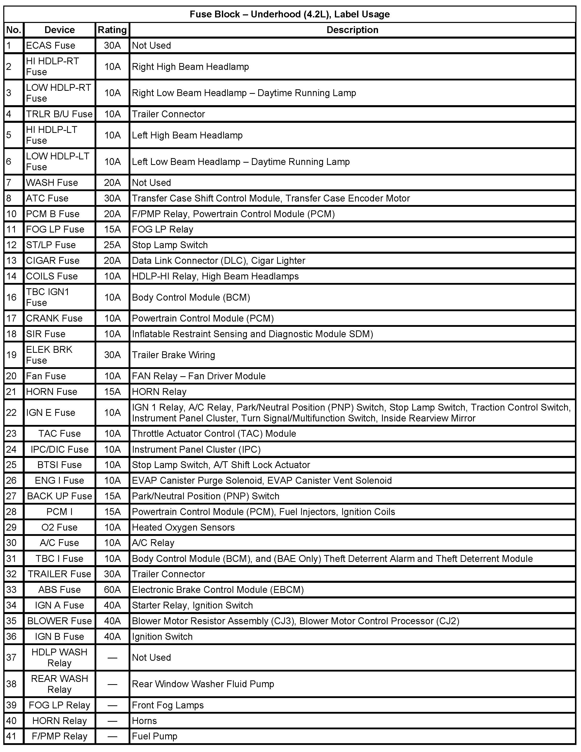

What is the location of the fuse (#56) for the air pump?
Dec 4, 2018 at 7:43 AM
  • 110,240 POSTS
According to a wiring schematic, it is in the under hood power distribution box. According to the layout of the fuse box, fuse 56 is not used. At this point, I suggest seeing if it is there.
I attached all the pictures of where I got the information from.

Thanks Ken but I was looking for information on the answer from Jacobandnickolas in witch he states it is under the power distribution panel not in it.
Dec 5, 2018 at 4:19 AM
  • 55,303 POSTS
I see it right there by the #33. Can you take a picture and upload it?
