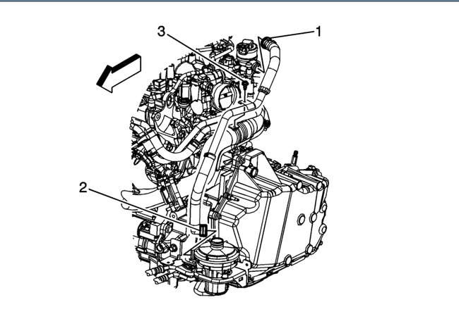

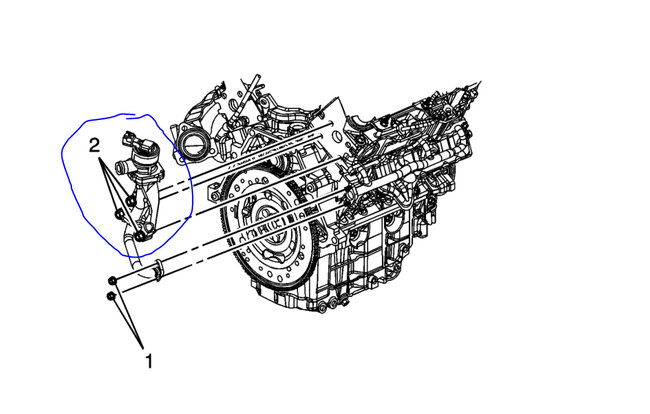

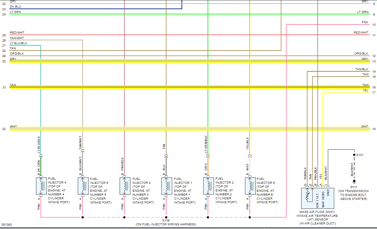

Trying to find the air pump check valve so I can change it out. Where is it located in the car listed above?
Nov 2, 2020 at 3:03 AM
Good afternoon,
I attached the procedure for you for the repair below. It is on the back of the cylinder head as shown in the pictures.
What leads you to think you need to replace it? Do you have a code?
Secondary Air Injection Shutoff and Check Valve Replacement
Removal Procedure
1. Remove the exhaust crossover pipe.
2. Disconnect the secondary air injection (AIR) feed tube quick connect fitting (1) from the AIR shutoff/check valve.
3. Remove the AIR feed tube bolt (3) from the heater inlet/outlet pipe bracket.
4. Disconnect the engine wiring harness electrical connector (2) from the AIR shutoff/check valve.
5. Raise and suitably support the vehicle. Refer to Vehicle Lifting.
6. Remove the AIR shutoff/check valve nuts (1).
7. Lower the vehicle.
8. Remove the AIR shutoff/check valve bolts (2).
9. Remove the AIR check valve and gasket. Discard the gasket.

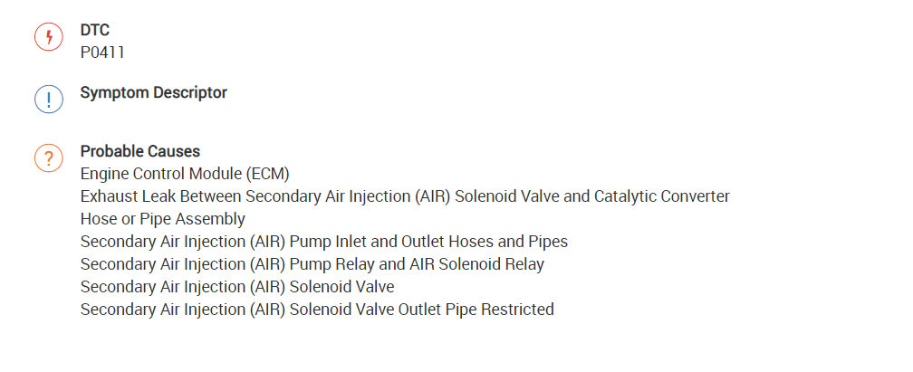

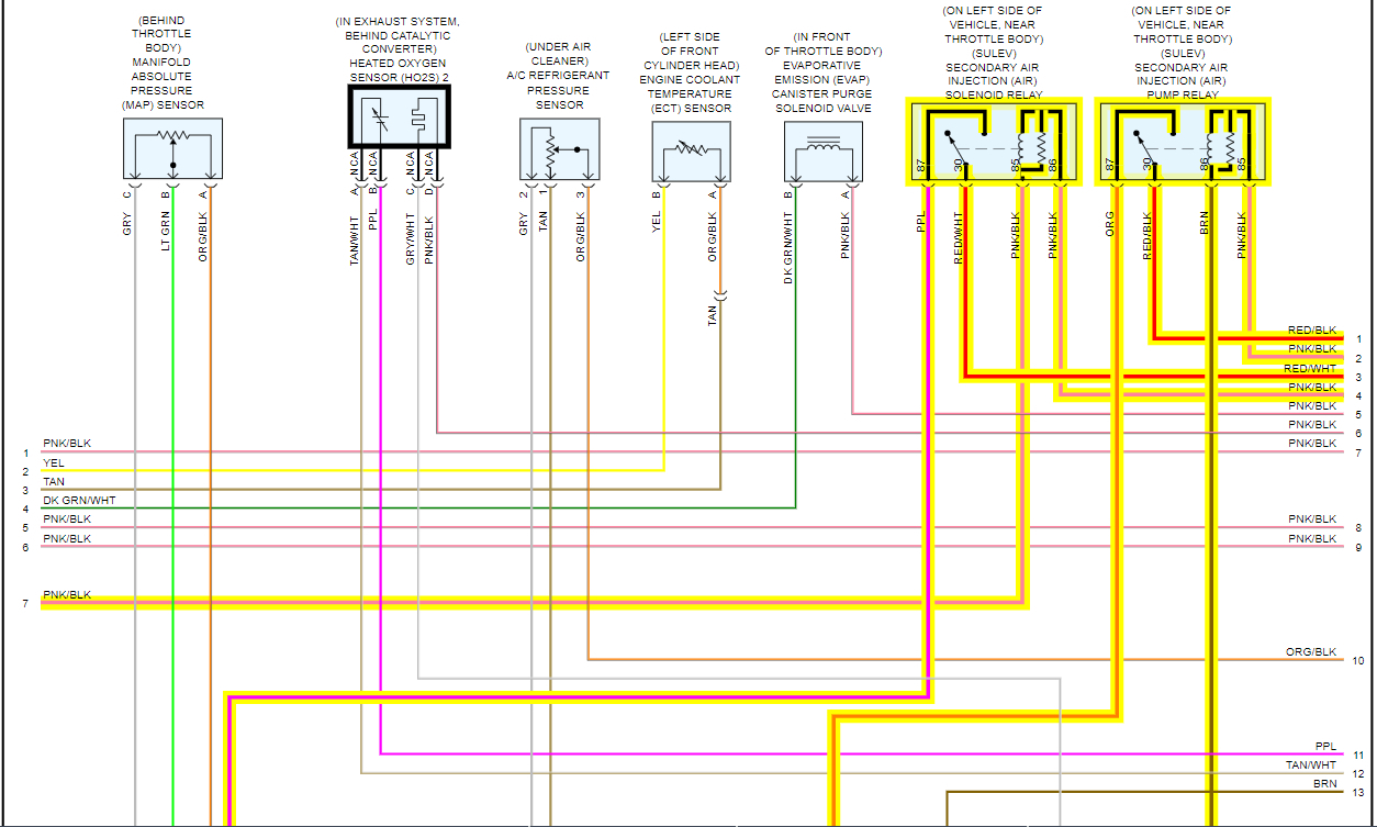

Yes, I was told code P0411 incorrect upstream flow detection. But was give part number 355050.
Nov 2, 2020 at 4:07 AM

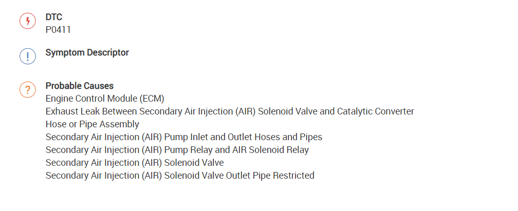

Okay, I attached the description and the possibilities below for you to view.
Can you hear the pump turn on when you start it first thing in the morning? The pump is the most common failure for this code.

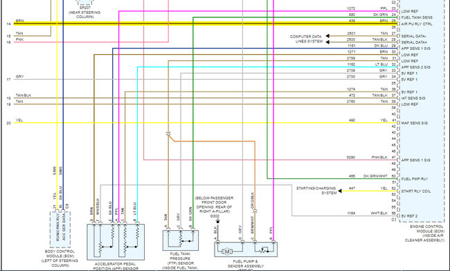

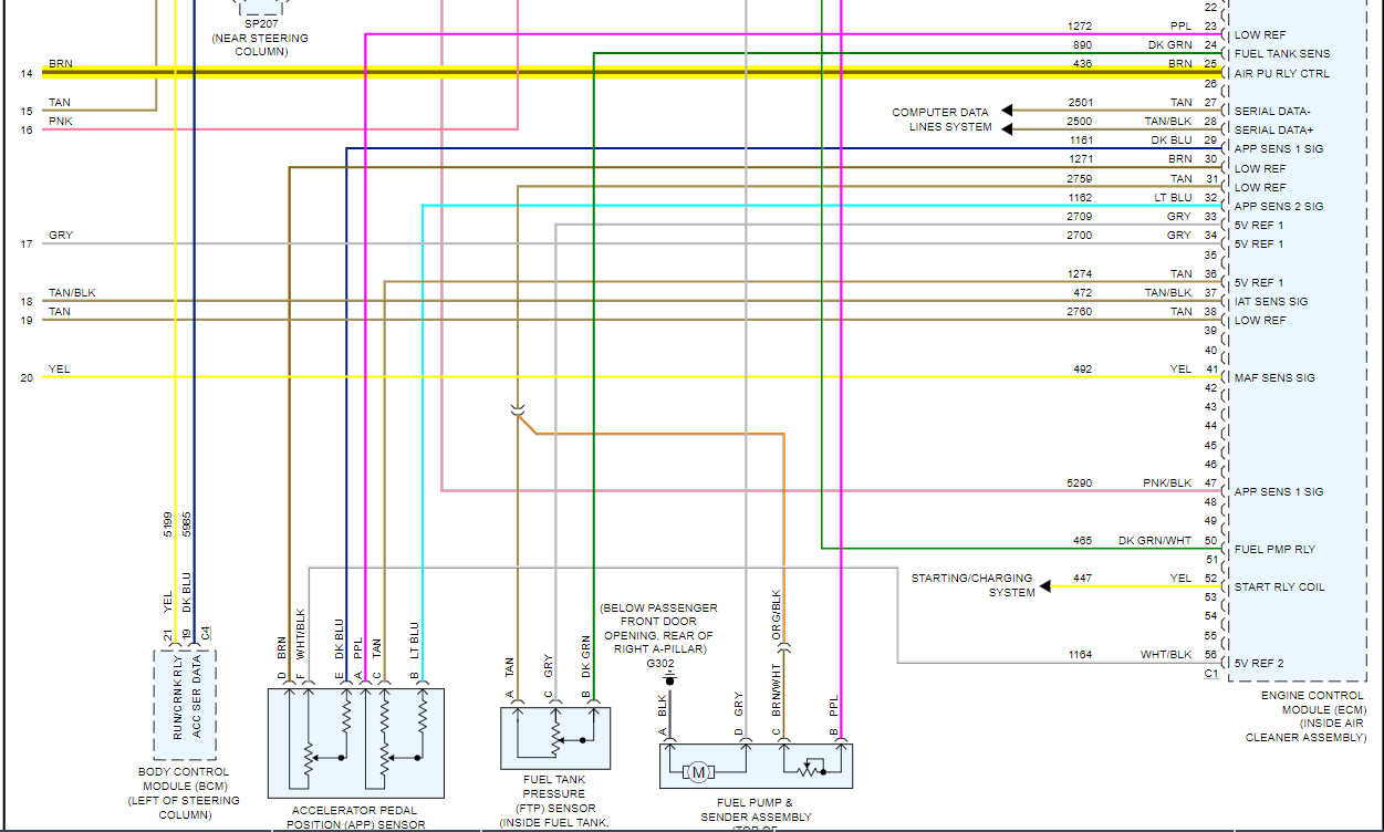

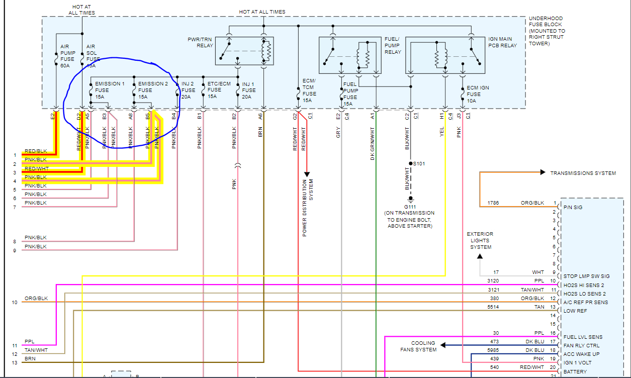

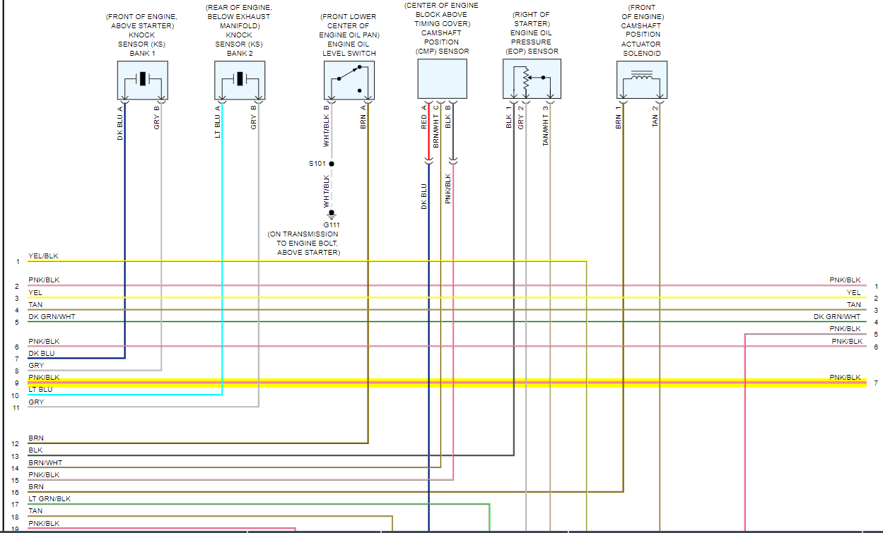

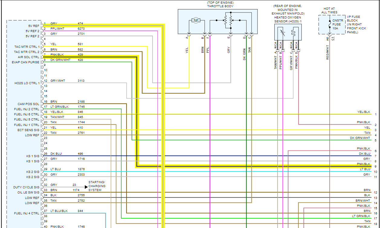

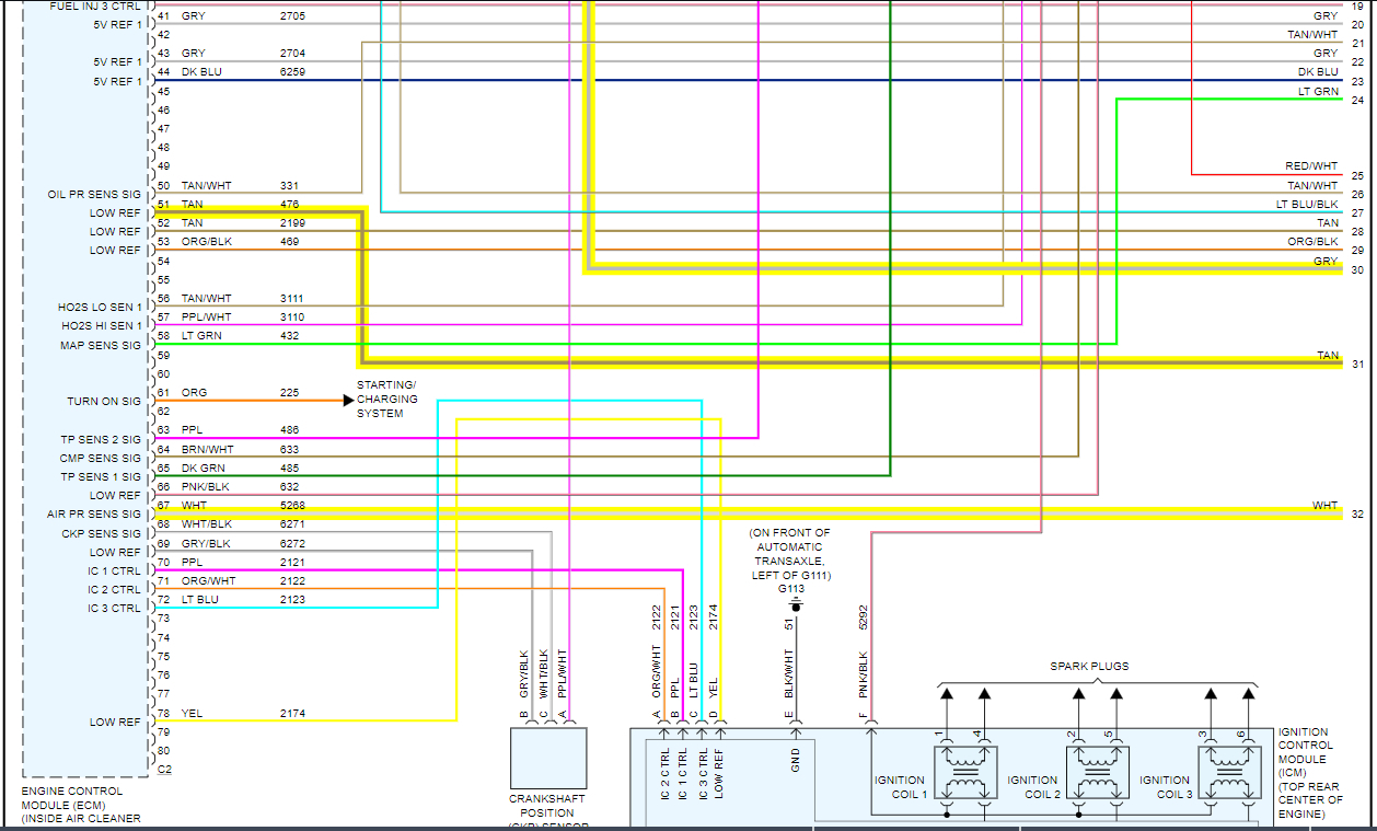

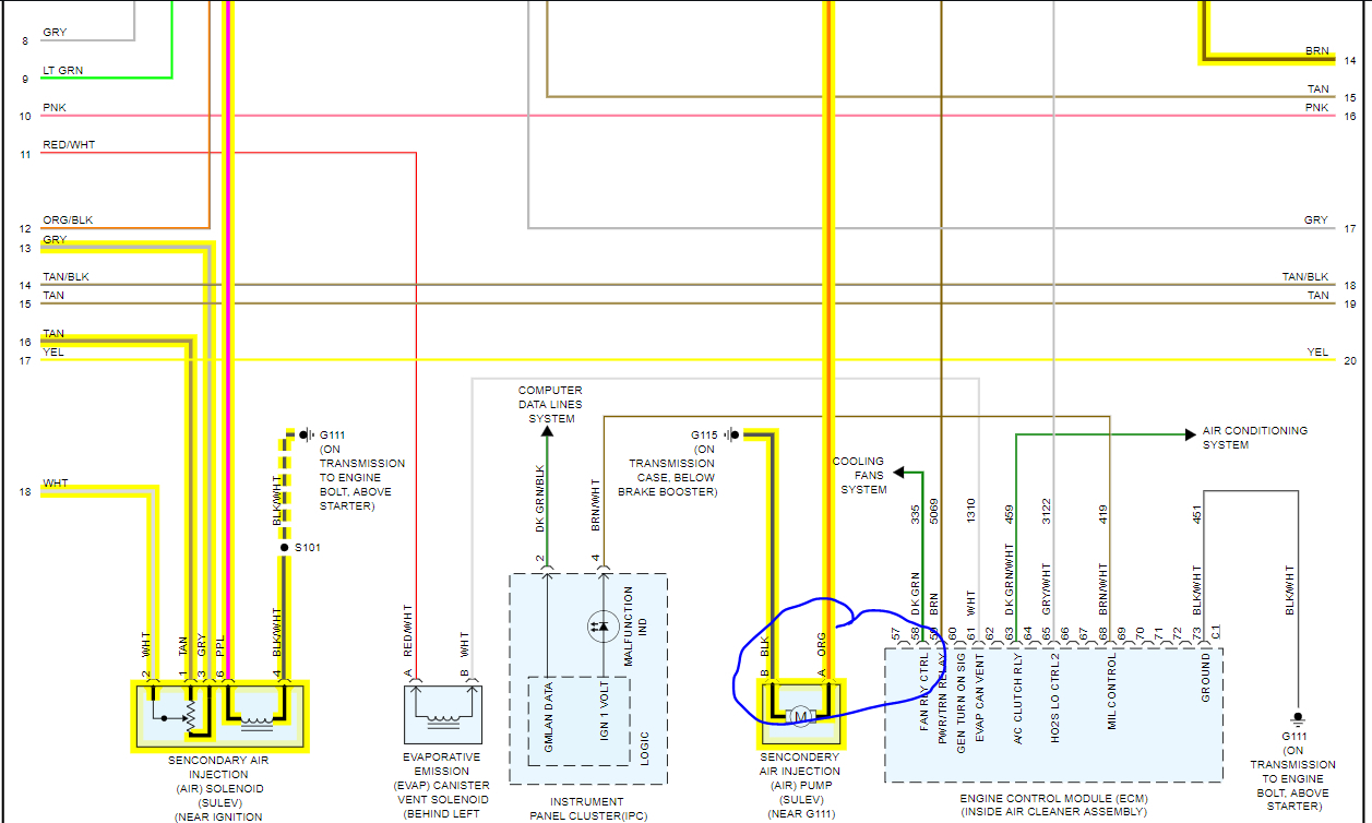

I attached the wiring diagram as well. You need to test the orange wire at the pump for power within the first 3 minutes of when the car starts from an overnight sit.
Circuit/System Description
The secondary air injection (AIR) system aids in the reduction of hydrocarbon emissions during a cold start. The system forces fresh filtered air into the exhaust stream in order to accelerate the catalyst operation. An electric air pump, the secondary AIR injection pump, provides filtered air on demand to the AIR control solenoid valve/pressure sensor assembly. The AIR control solenoid valve/pressure sensor assembly controls the flow of air from the AIR pump to the exhaust manifold. The AIR valve relay supplies the current needed to operate the AIR control solenoid valve/pressure sensor assembly. A pressure sensor is used to monitor the air flow from the AIR pump. The engine control module (ECM) supplies the internal pressure sensor with a 5-volt reference, an electrical ground, and a signal circuit.
The AIR diagnostic uses 3 phases to test the AIR system:
1. DTCs P0411 and P2430 run during Phase 1
2. DTCs P2430 and P2440 run during Phase 2
3. DTC P2444 runs during Phase 3
During phase 1, both the AIR pump and the solenoid valve are activated. Normal secondary air function occurs. Expected system pressure is 8-10 kPa above BARO.
During phase 2, only the AIR pump is activated. The solenoid valve is closed. Pressure sensor performance and solenoid valve deactivation are tested. Expected system pressure is approximately 15-22 kPa above BARO.
During phase 3, neither the AIR pump nor the solenoid valve is activated. AIR pump deactivation is tested. Expected system pressure equals BARO.
In all 3 phases, testing is accomplished by comparing the measured pressure against the expected pressure. The ECM can detect faults in the AIR pump, AIR control solenoid valve/pressure sensor assembly, and the exhaust check valve. The pressure sensor can also detect leaks and restrictions in the secondary AIR system plumbing.
