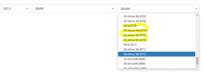

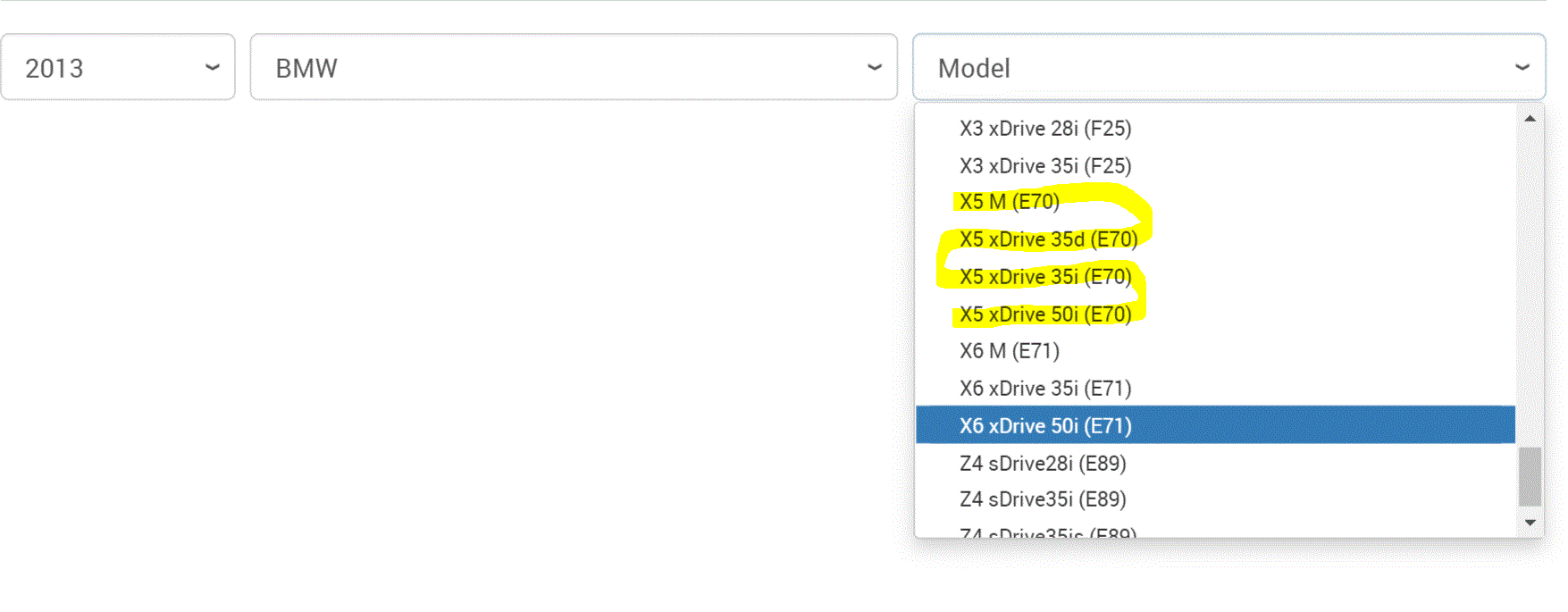

I need to know which engine your vehicle has and model. See the attached list below.
Now, if the only thing you took it there to have done was a scan to identify diagnostic trouble codes and they continued testing other things, I would think that is something that is arguable. Did you authorize anything other than a scan for diagnostics?
