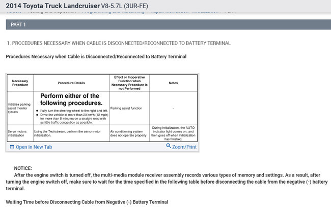

when this problem happened i try to disconnect the negative battery cable to reprogramming the air conditioner but no changes.

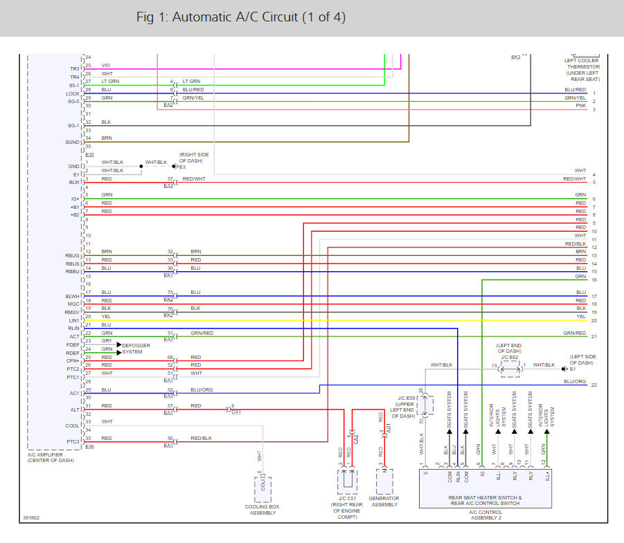

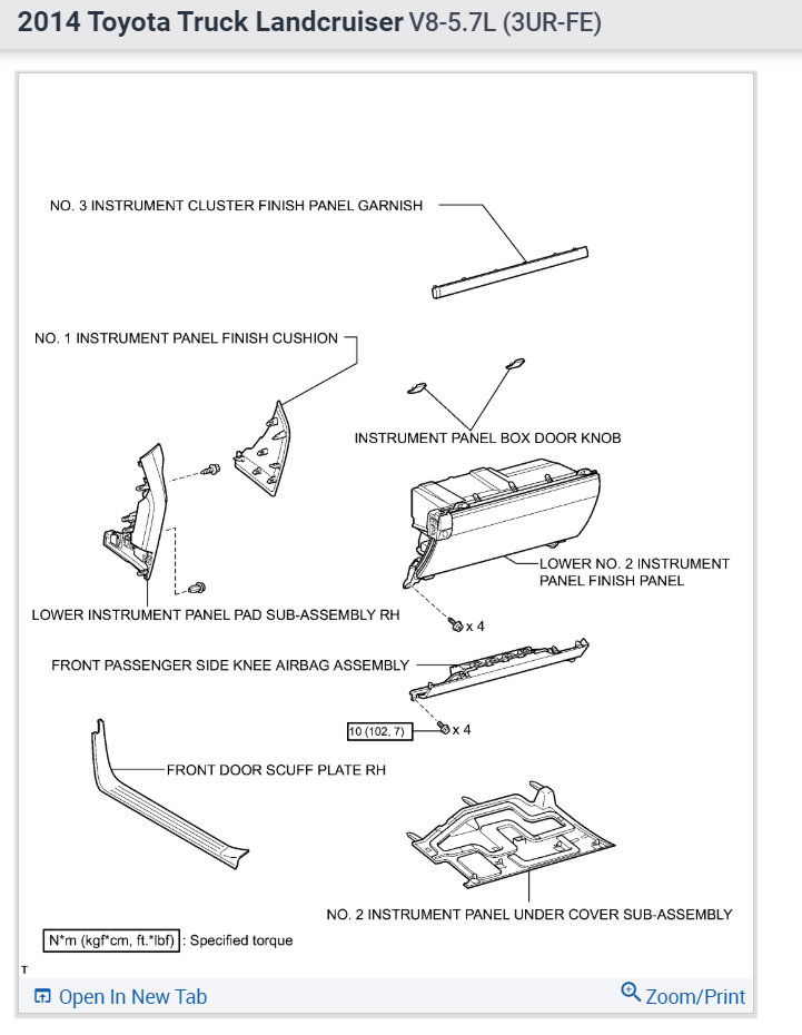

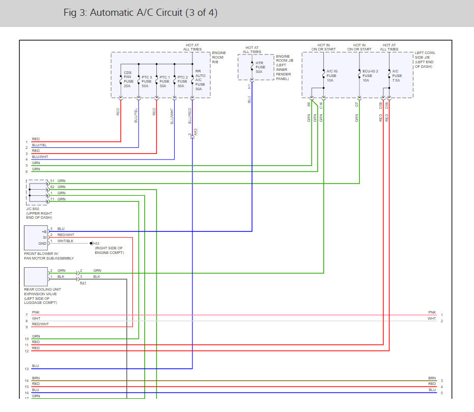

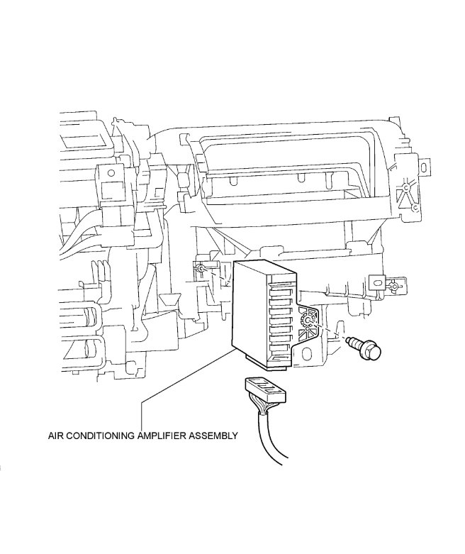

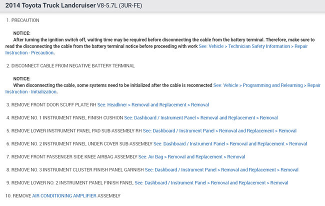

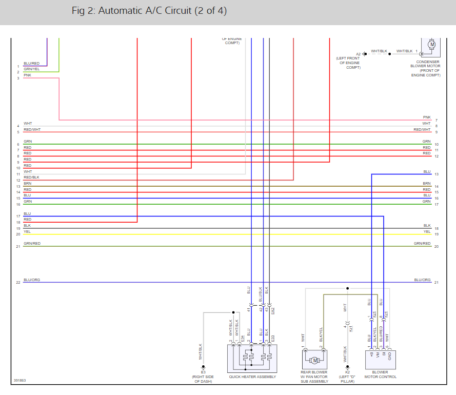

This is common when the air conditioner amplifier goes out but to be sure we should scan the CAN to see whats going on here is a video to help you can get a CAN scanner for about $50.00 on Amazon. I have included instructions for the amplifier replacement in the diagrams below.
https://youtu.be/InIlnsjOVFA

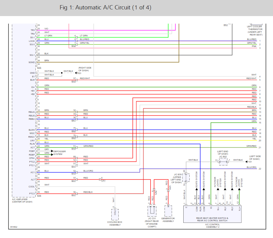

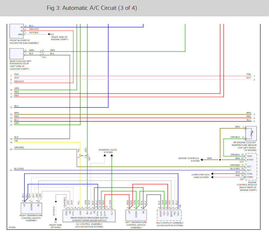

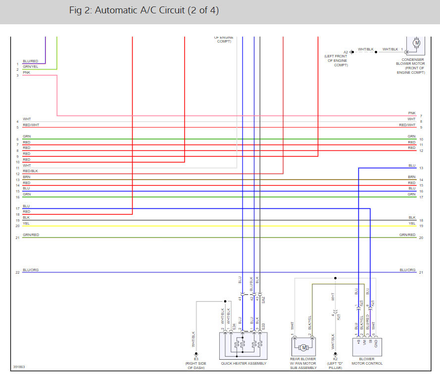

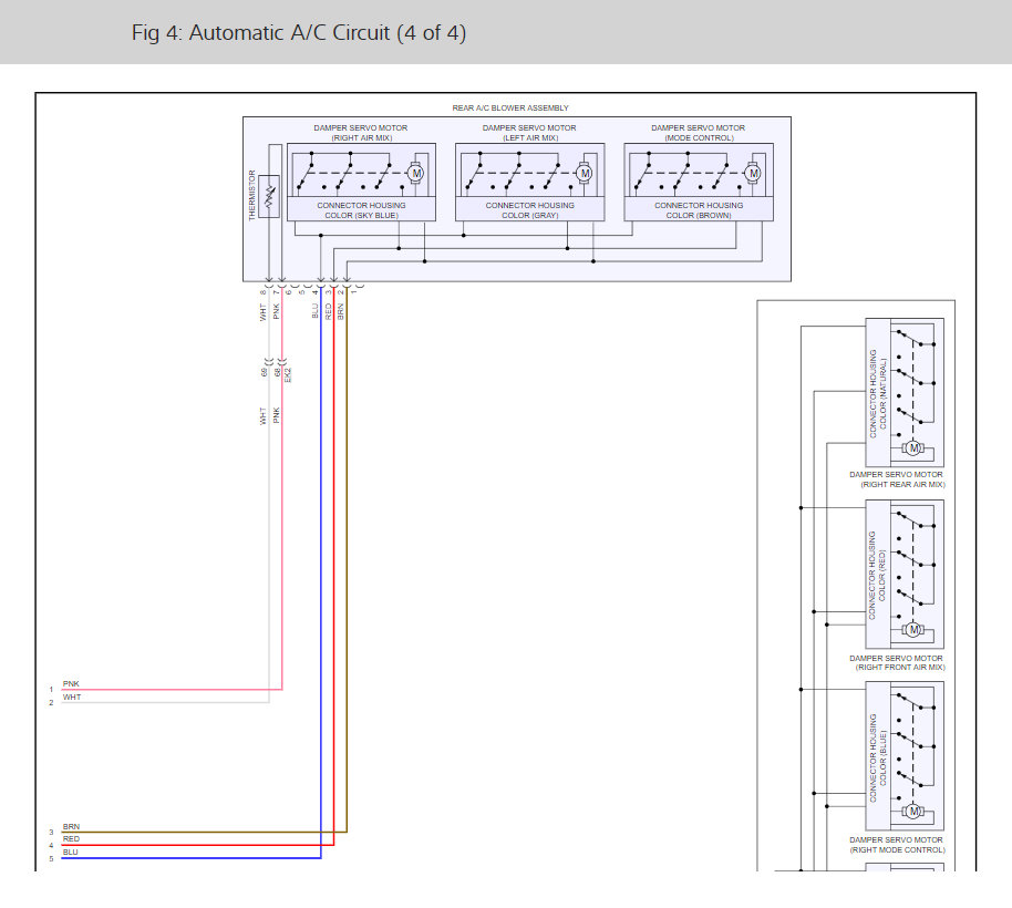

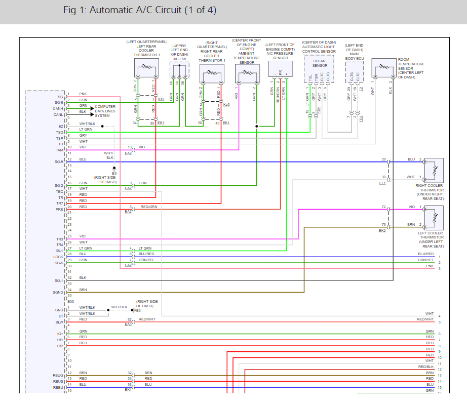

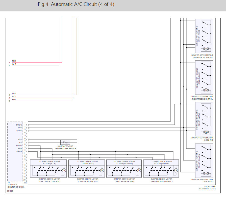

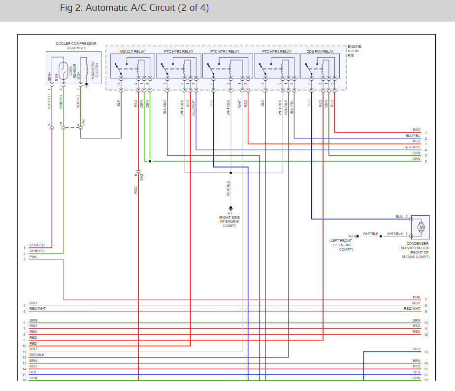

I have included the HVAC wiring diagrams so you can see how the system works. Check out the diagrams (below). Please let us know what you find. We are interested to see what it is.

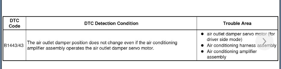

I got the Code of problem, it is B1443.
Oct 10, 2019 at 6:53 AM

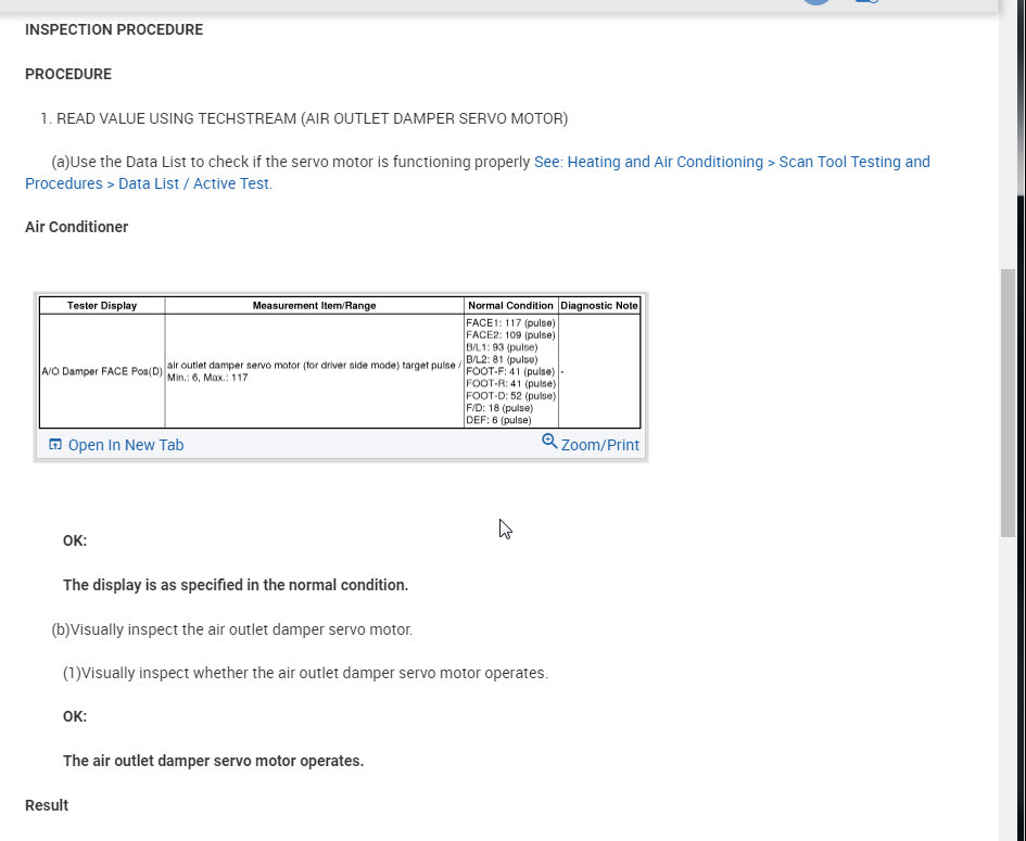

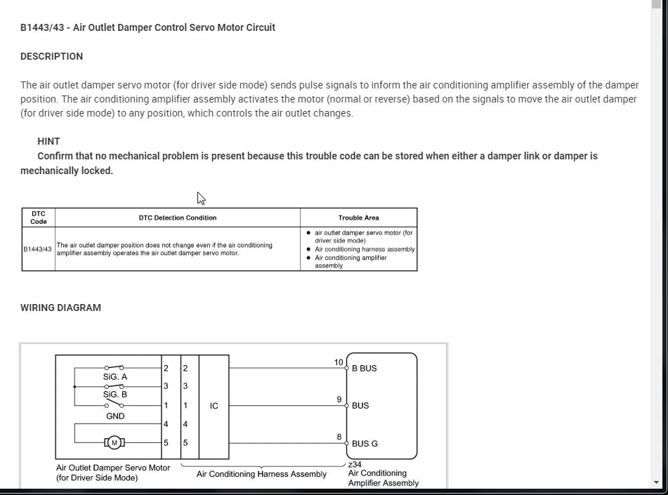

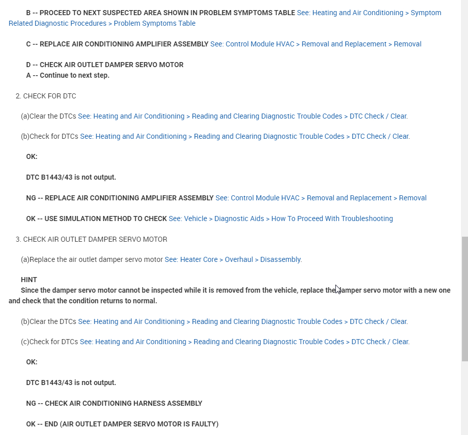

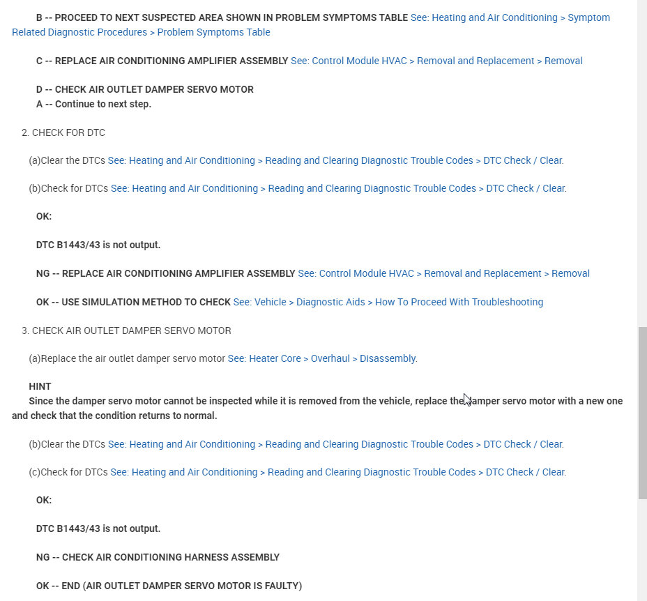

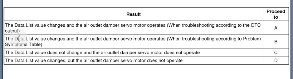

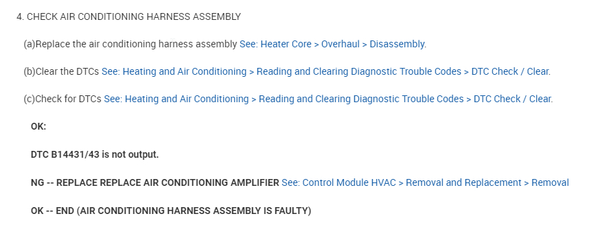

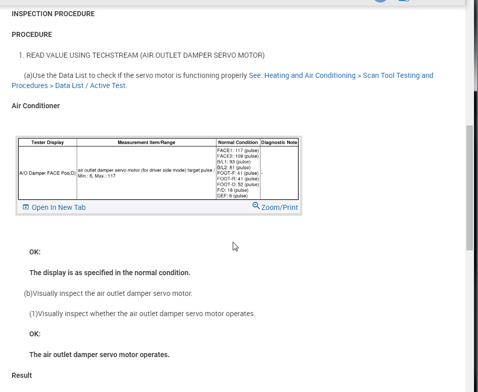

Hi BREMAXI,

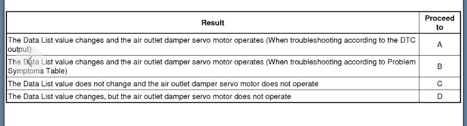

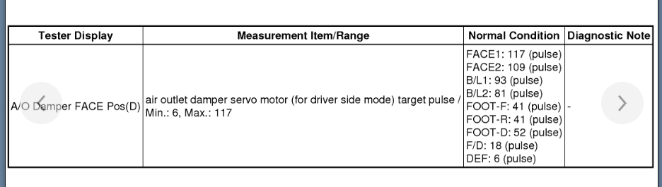

If I can jump in and provide the flow chart for this code, it will help figure out the issue. The only unfortunate thing is this is written for a dealer or shop that has a scan tool so it may be a little hard. Barring a wiring issue, the most likely cause is the servo motor.
Did you purchase a scan tool that can monitor this data? If so, run through this and let me know what you find. Thanks
Oct 15, 2019 at 7:03 AM

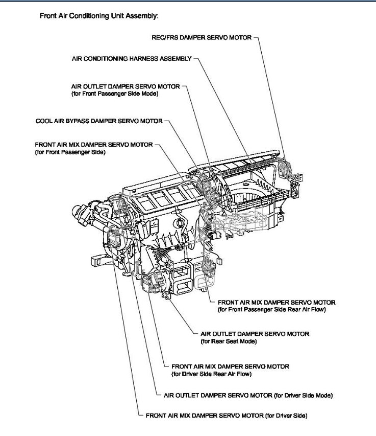

  • 55,423 POSTS
B1443 - Air Outlet Damper Control Servomotor Circuit. I would try replacing the actuator it is common for them to go out. Check out the diagrams (below). Please let us know what you find. We are interested to see what it is.
Oct 18, 2019 at 7:40 AM
BREMAXI
I already replaced the Air Outlet Damper Control Servomotor but the problem still happens. i think the problem is on the A/C amplifier (70%) or the room temperature sensor (30%). why i think on the room temperature sensor because i see the problem happen more with the more humidity weather.
Oct 18, 2019 at 7:53 AM
  • 55,423 POSTS
I don't think that would cause the code. it is a circuit problem. I would use this guide and wiring diagrams above to trouble shoot the connection problem.
