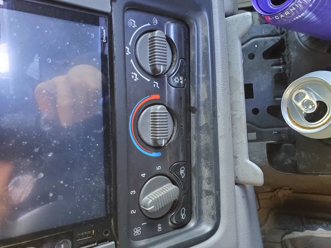

Air only comes out of defrost vents
2000 GMC SIERRA
250,000 MILES • 5.3L • V8 • 2WD • AUTOMATIC
PACKERS27
  • 207 POSTS
So, no matter what switch I turn it to, it never blows through anything but the defrost vent. Blend door motor. Mode Actuator ? I don't know alot about this so any explanation and a location to where the part is, is greatly appreciated. Here's a pic of my controls Thank you!!!

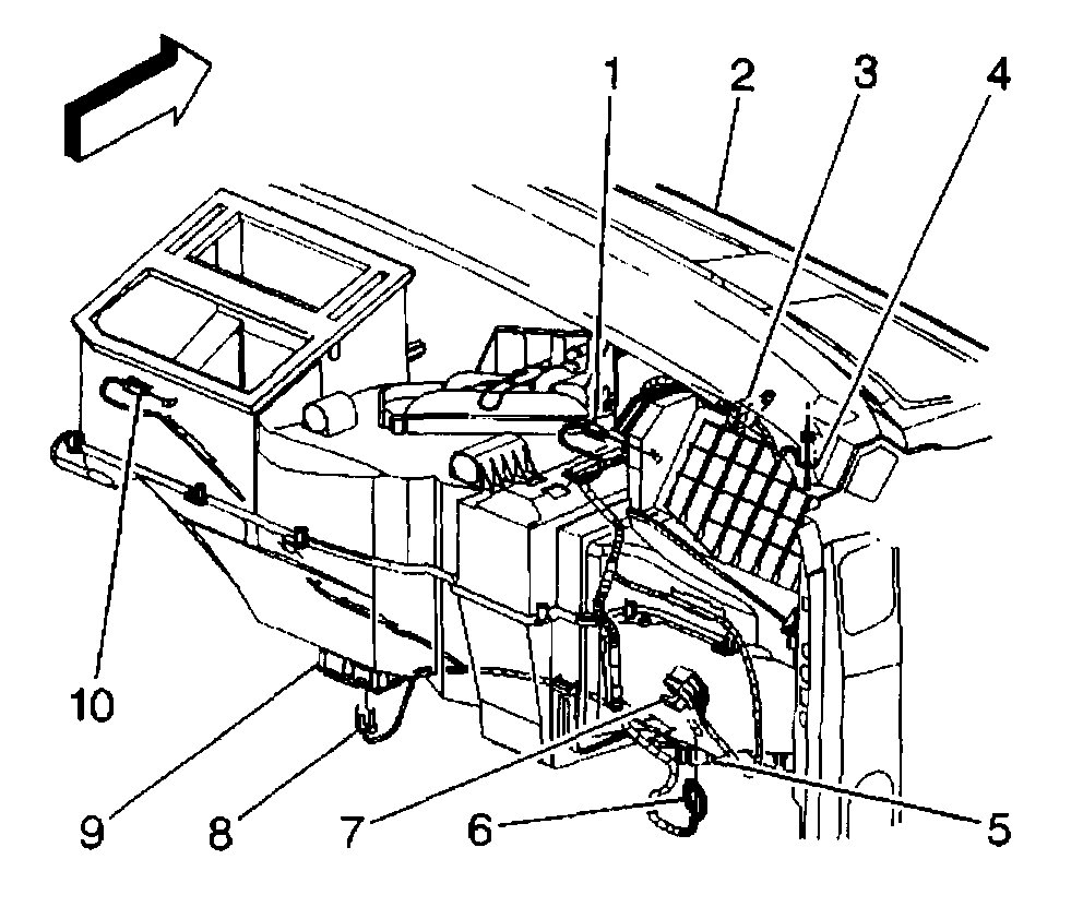

Airflow directions are controlled by the mode door actuator. Chances are the actuator is bad.
First, take a look through this link:
https://www.2carpros.com/articles/air-vents-stay-in-the-defrost-position
The mode door actuator is located under the dash near the center. Here are the directions specific to your vehicle for replacement. The pics below correlate with the directions.
2000 GMC Truck C 1500 Truck 2WD V8-5.3L VIN T
Mode Actuator Replacement
Vehicle Heating and Air Conditioning Air Door Actuator / Motor Service and Repair Procedures HVAC System - Manual Mode Actuator Replacement
MODE ACTUATOR REPLACEMENT

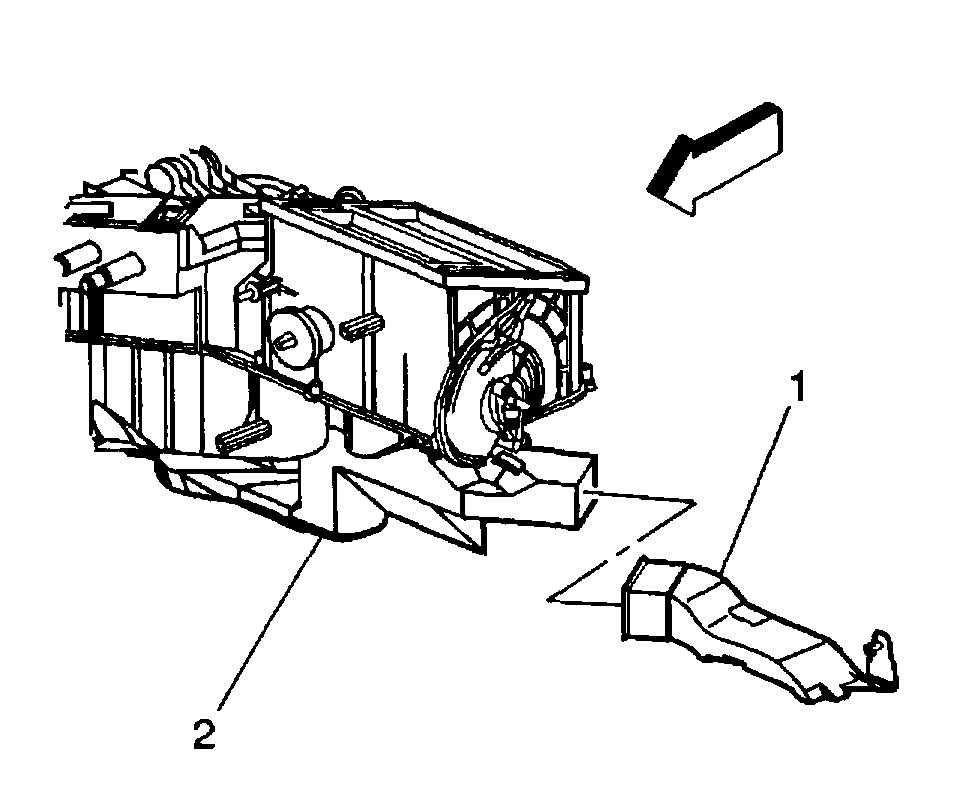

1. Remove the floor air outlet duct extension (1) from the floor duct (2).

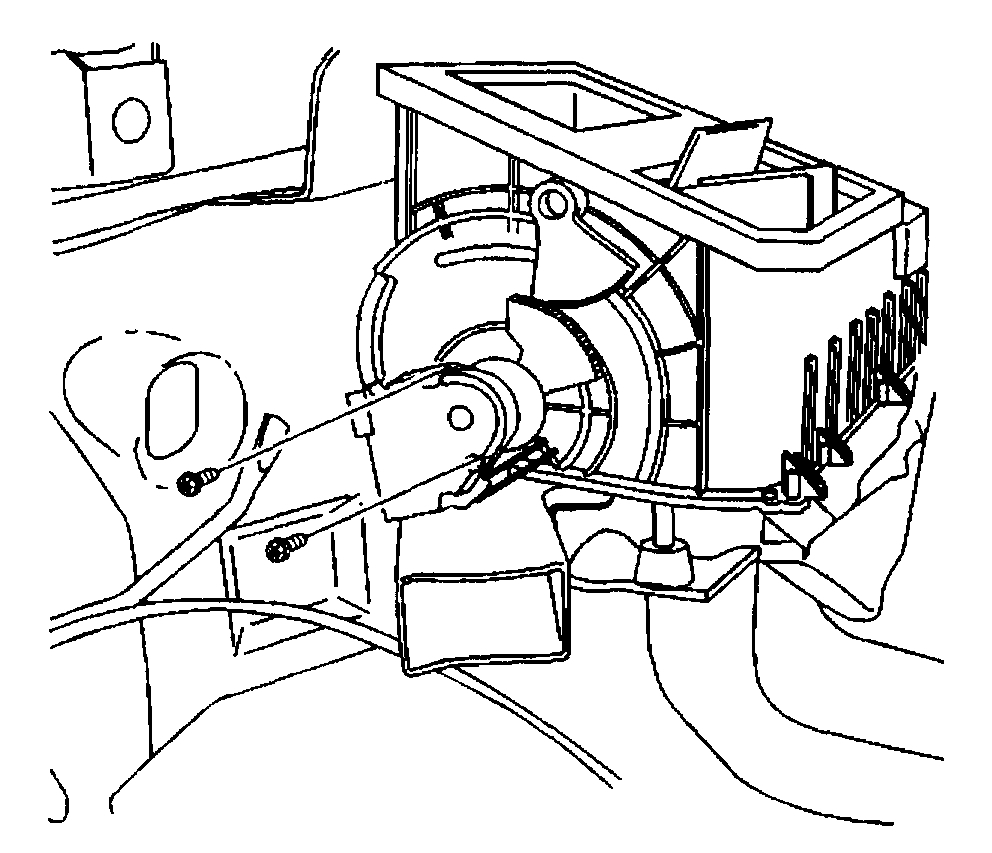

3. Remove the mode actuator mounting screws from the HVAC module.
4. Remove the mode actuator as an assembly with the actuator cam.

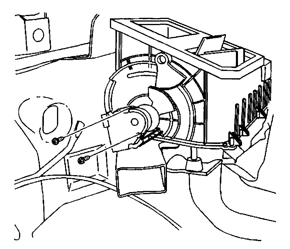

pic 4
1. Install the mode actuator as an assembly with the actuator cam.
- Line up the heater/defroster valve lever with the mode actuator cam slot.
- Line up the A/C valve lever with the mode actuator cam.
NOTE: Refer to Fastener Notice in Service Precautions.
2. Install the mode actuator mounting screw to the HVAC module.
Tighten
Tighten the mode actuator mounting screw to 1.6 N.m (14 lb in).

4. Install the floor air outlet duct extension (1) to the floor air duct (2).
