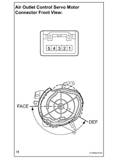

Hello, my heat and A/C work fine, however it blows from the face vents only regardless of switching to feet or defrost. This is dangerous when the windshield fogs up during driving in the rain. The knob movement doesn’t feel right but does click something as I can hear a small motorized movement down under dash somewhere.
Everywhere I look, it’s always talking about everything but this specific issue. I’m decent with fixing things just don’t know where to start. This is also for others who might have the same issue and are struggling to find help with it. Thank you.

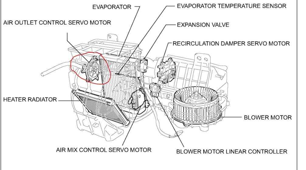

I would suspect the mode door motor has failed. The noise is the key. You should not hear the motor at all. That tells me there is a failure in the motor.
It is under the dash on the driver's side on the case. I attached pictures for you to view.
1. INSPECT AIR OUTLET CONTROL SERVO MOTOR
a. Remove the air outlet control servo motor.
b. Connect the positive (+) lead from the battery to terminal 4 and negative (-) lead to terminal 5, then check that the lever turns to "DEF" position.
c. Connect the positive (+) lead from the battery to terminal 5 and negative (-) lead to terminal 4, then check that the lever turns to "FACE" position.
NOTE: While using the battery during inspection, do not bring the positive and negative tester probes too close to each other as a short circuit may occur.
If the operation is not as specified, replace the air outlet control servo motor.
