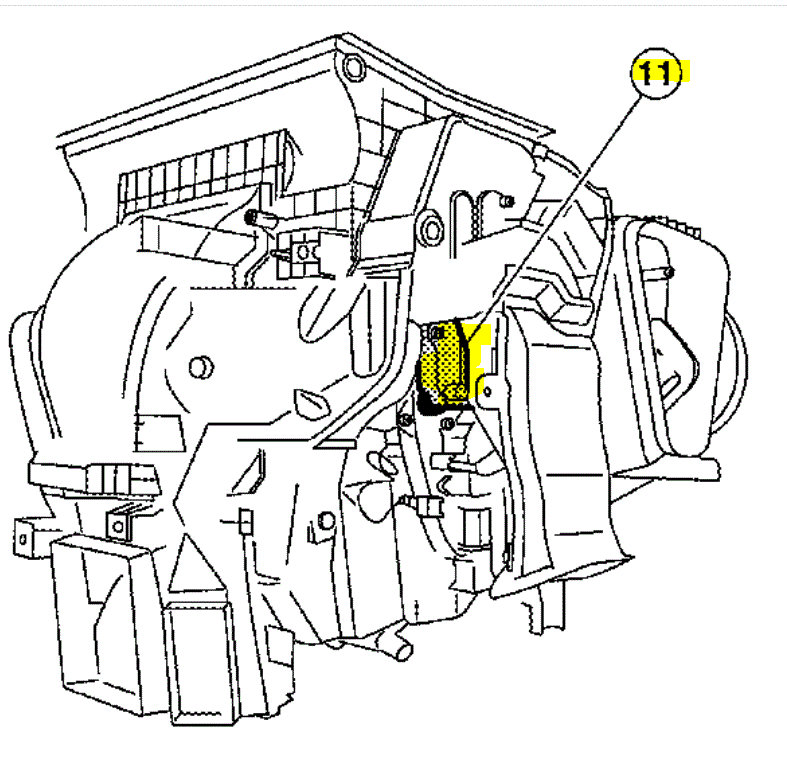

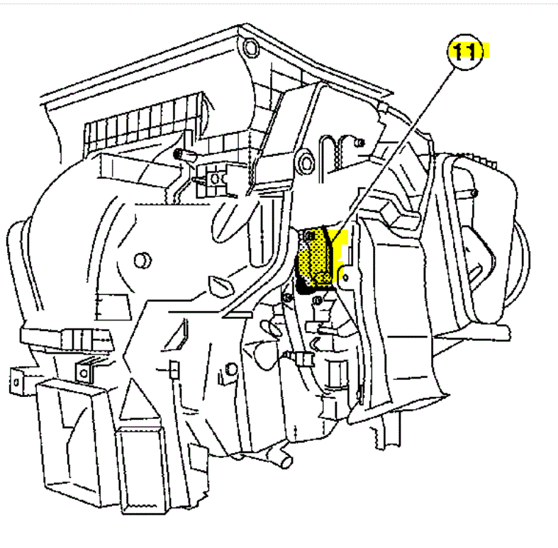

Based on if this has automatic climate control or manual control determines the locations of the blend door actuator (air mix door). The air mix door actuator is what controls the temperature entering the vehicle.
I attached a pic below of the manual system and indicated the air mix door actuator for you to see.

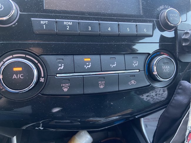

Below is a picture of the controls.
Apr 26, 2022 at 3:57 AM

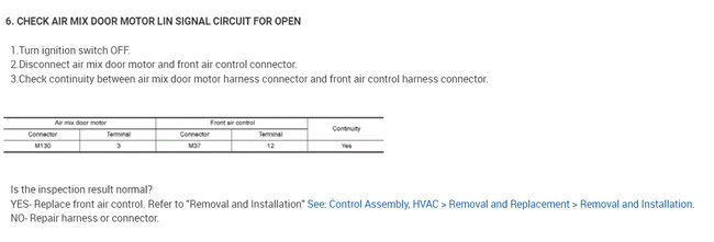

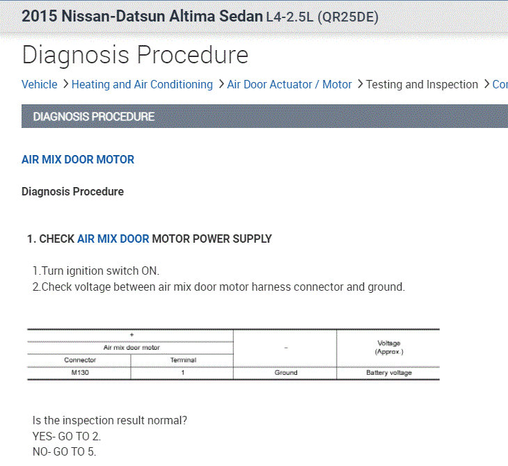

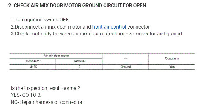

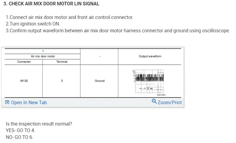

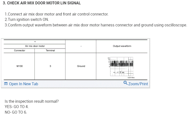

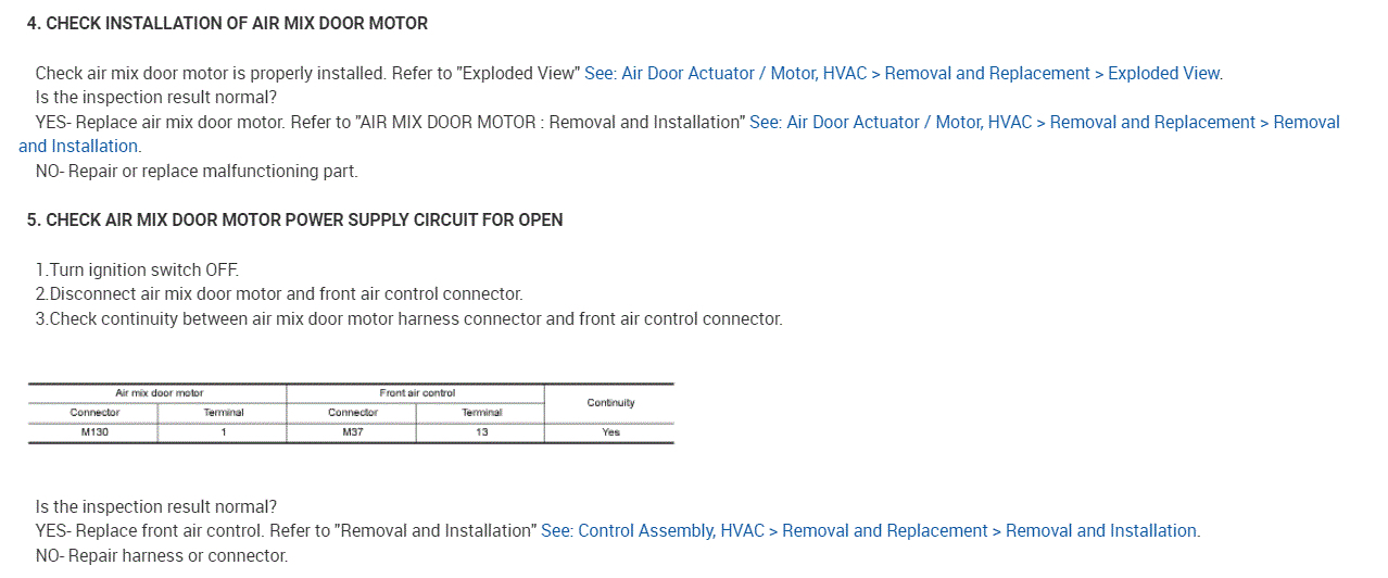

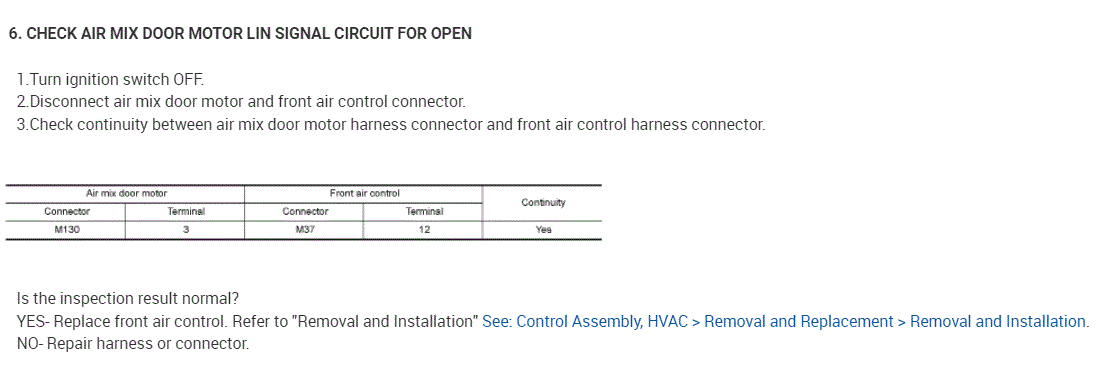

At this point, the next thing is to start diagnostics related to the air mix door actuator. I attached the diagnostics below. Here is a link you may find helpful:
Take a look through the diagnostics and let me know if you are comfortable performing them.
Also, since it goes from heat to cooler air, the door has to be moving. The only thing I can say is it isn't moving the door far enough.
Let me know what you find or if you have questions.
