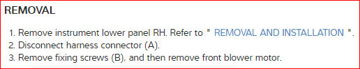

This summer I have noticed that my A/C is not blowing as strong in my van. It is still cold, it just seems weaker. I used to hear a little squealing sound sometimes when I would turn the air on. It was occasional though, not every time. I am not sure what to do but I had a really bad experience with a mechanic on another car recently so I am nervous to take it in. My dad is somewhat handy with cars and can do many things with them that do not require really unique or special tools. Is there anything we could check ourselves or am I destined for a mechanic? Thanks in advance for your help.

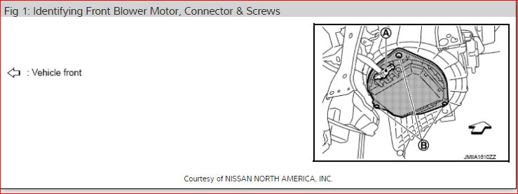

I would suggest looking/inspecting your blower motor for proper performance. After time it might be wearing out due to normal use. I have attached a picture and how to remove steps. I have also attached a link showing how to do it as well. It is located behind the right hand lower instrument panel. Hope this helps and feel free to ask any further questions if needed. Thanks for using 2CarPros.

Little squealing noise can be bearings starting to fail or something in the blower motor. I would also check the cabin air filter if it has one. It depends on which options it has, the automatic system uses an ionizer ad filter while the manual system has neither.
