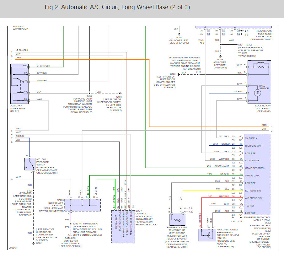

Air not blowing
210,000 MILES • 4.3L • 6 CYL • 2WD • AUTOMATIC
ROBJUAN14
I had no heat so I changed blower motor and resister. But before I did that I disconnect the battery. I reconnect the battery and heat worked. Let sit overnight then started with no air blowing. I checked resister harness and looks good. All fuses look good. Any help is appreciated.
Jan 7, 2018 at 8:59 AM
  • 55,865 POSTS

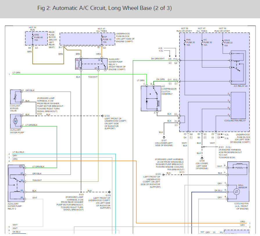

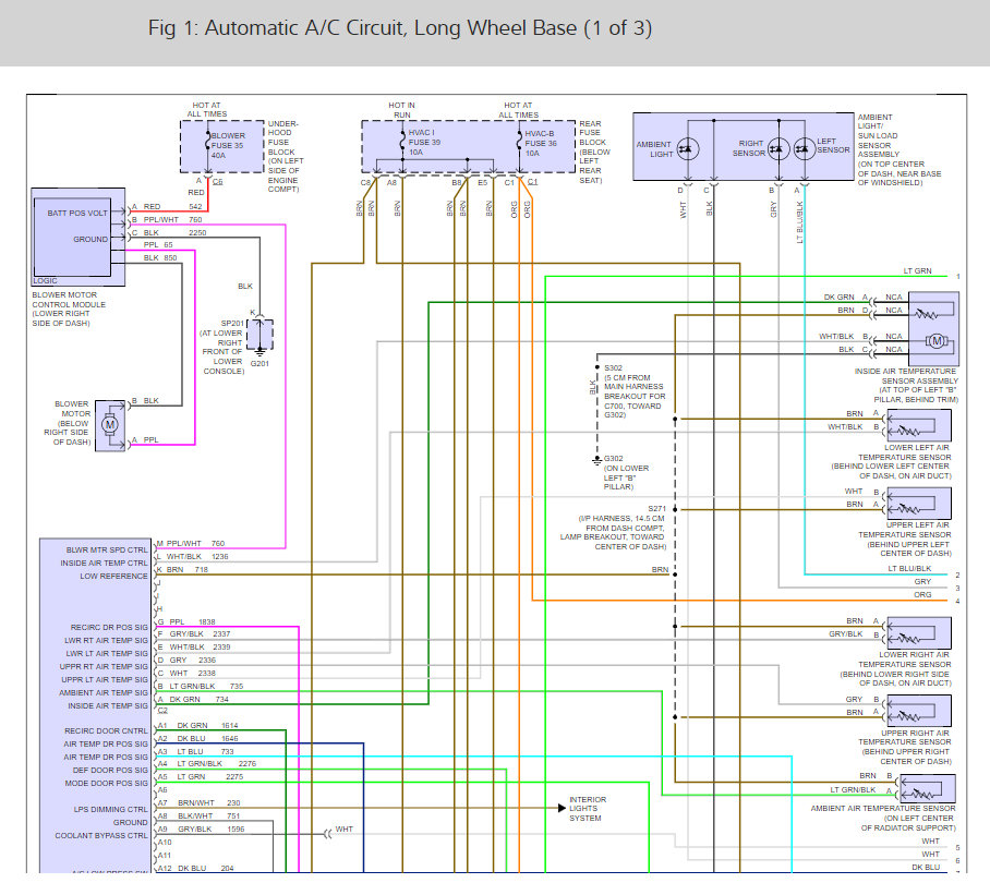

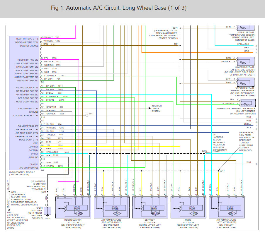

When you say resistor do you mean the blower fan control module? We must be losing power somewhere are the trigger from the controller. Here is a guide to help us see whats wrong:
Below are the wiring diagrams so we can do some easy testing to find out what is wrong.
Jan 9, 2018 at 5:39 AM
