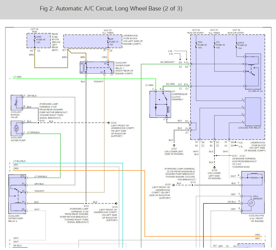

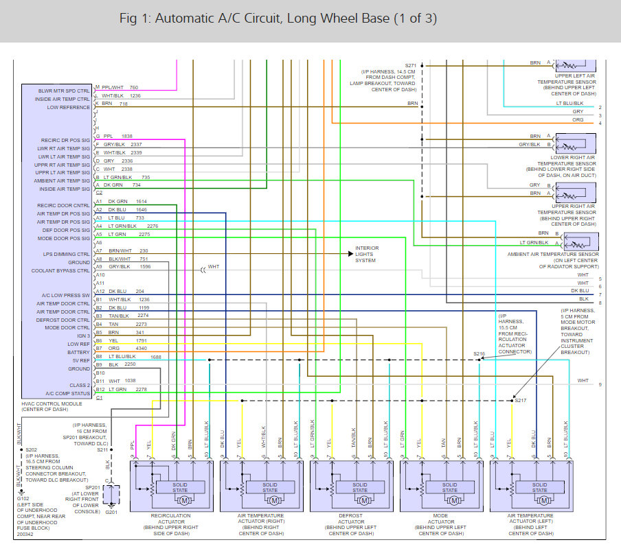

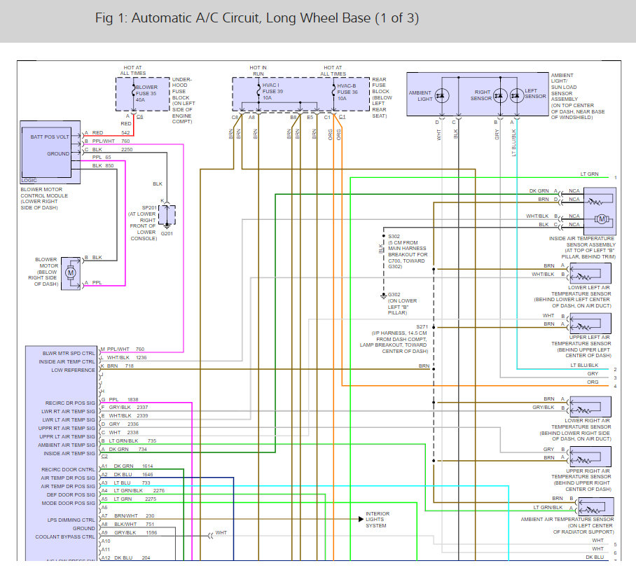

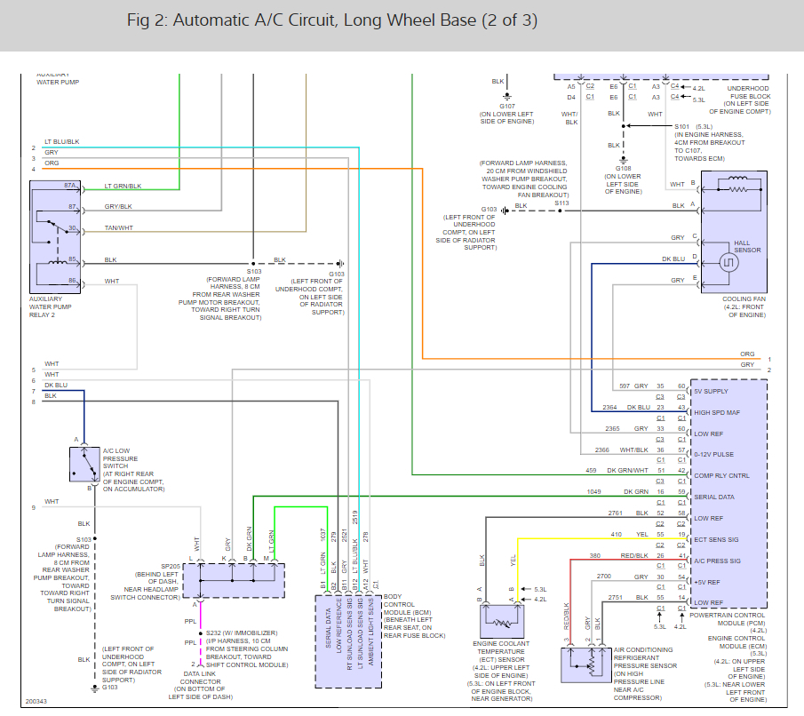

When you say resistor do you mean the blower fan control module? We must be losing power somewhere are the trigger from the controller. Here is a guide to help us see whats wrong:
Below are the wiring diagrams so we can do some easy testing to find out what is wrong.
