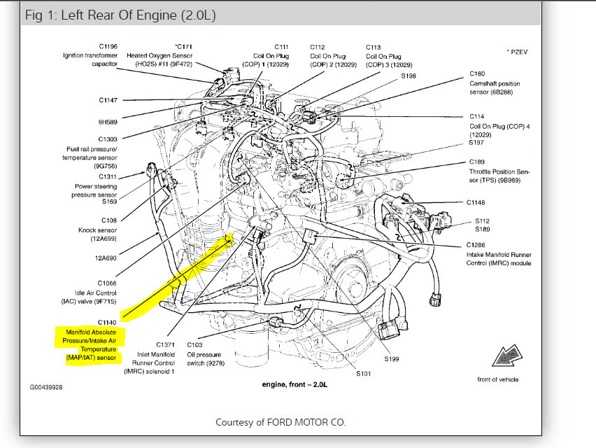

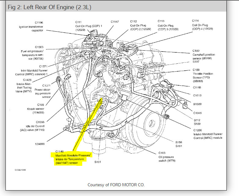

Can you please tell me where the air intake temperature sensor is on my vehicle please? Thanks in advance

The Intake Air Temperature Sensor (IAT) is going to be located in the air intake ducting going to the throttle body on your vehicle. It should have a two wire electrical connector hooked up to it. In the diagrams down below I have included a diagram for both the 2.0L and the 2.3L engine's for your vehicle showing the location of the IAT sensor. Please get back to us with how everything turns out after using these guides.
