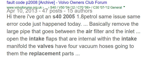

I had a problem with my Volvo occasionally idling funny. I was told to get and air intake control valve and replace it. I got the part image attached, but cannot find its location anywhere so as i can change it.
PIERBURG Air Intake Control Valve 7.22240.15.0
Volvo S40 II (MS) 1.8
1798cc. 125hp..
From 01/2004 to 07/2012
Any help deeply appreciated.

HI THANK YOU BOTH FOR YOUR REPLIES.THIS IS WHAT I WAS SENT BY VOLVO FOR A AIR INTAKE CONTROL VALVE FOR MY YEAR AND MODEL.UNFORTUNATLEY I CANNOT NOT FIND IT ANYWHERE NEAR THE THROTTLE BODY EVENEN REMOVED COMPLETE AIR FILTER UNIT AND BATTERY TO GET A BETTER LOOK AROUND THAT SECTION SO A BIT OF A MISTRY

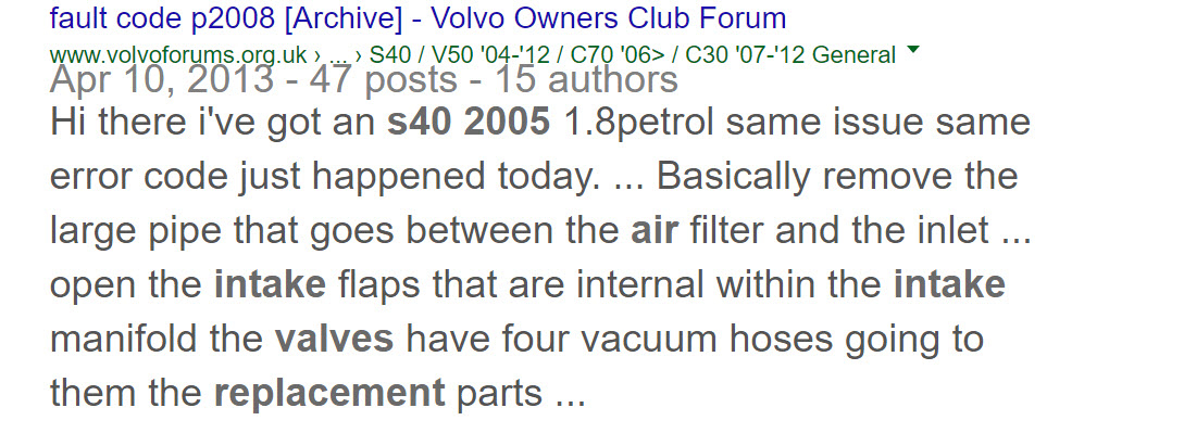

Unfortunately you have a 1.8L which in the US is not available and the info I sent was for a 2.4L, dummy me for not looking.however I did look online and found what is in the pic that may lead in the right direction.
