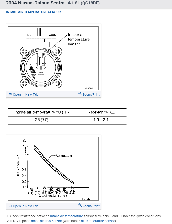

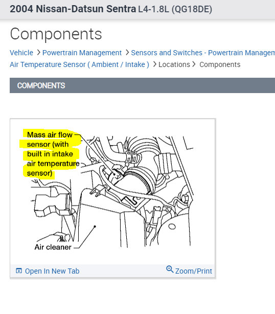

Just trying to find the location of the Air intake charge temperature sensor on my car listed above. Thank you
Jul 3, 2022 at 2:24 AM
SQM
Experienced Mechanic
6,383 POSTS
For this vehicle, the air intake charge temperature sensor is built into the mass air flow sensor.
See diagrams below for reference.
Let me know of any questions.
