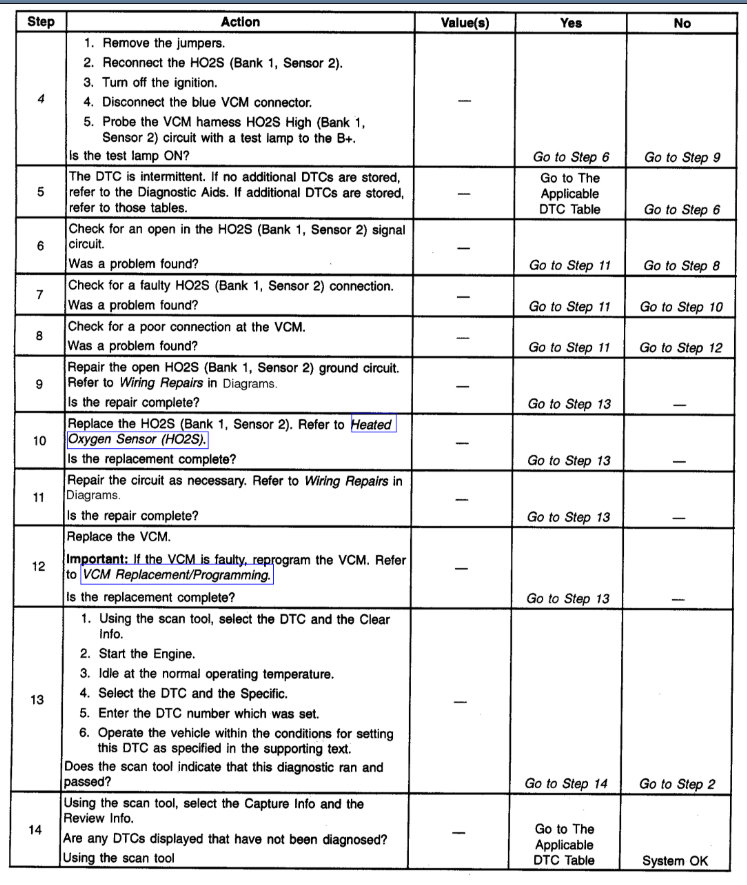

My truck has recently started sounding like it's sucking air horn blowing air possibly. I have 3 codes that are the EGR and the bank 1 sensor 2 code is going off for the heater circuit and not responding to fuel cutoff something like that. it has a new cap, didn't do the rotor. rotor, new wires, new plugs. yesterday new fuel pump Fran fuel treatment. I clean the EGR valve. I've done starter fluid around the air intake and what not. I didn't get any high-revving or anything like that. just wondering if anybody could help me out. really bad acceleration through 1st 2nd 3rd. sounds like good ain't going nowhere by me and it does but I like it used to I'm swinging on for at least a month or so. and oh my gosh mileage has went down significantly could help me out that be great.
The EGR gasket was a little rough and I noticed black marks that seemed to indicate that exhaust was blowing out sorta around the gasket holes. but when I did the starter fluid around it it did nothing.

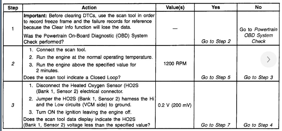

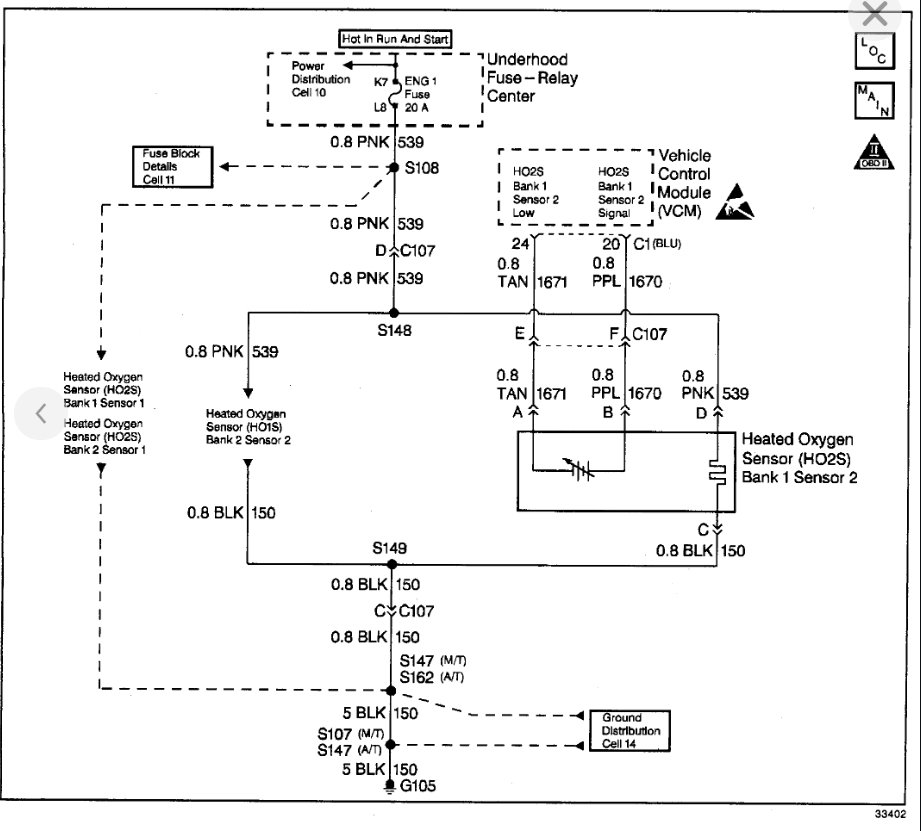

I cleared them and so far it is only throwing the p0140 code for the bank 1 sensor 2 not responding to fuel cut off or fuel enrichment signal.
Feb 9, 2020 at 6:17 AM
While I don't think this is the route cause, we do need to tract it down. The reason being it is related to what you are seeing. Part of this test is determining if the ECM is the issue and that could definitely be the route cause. So if we fix this code, it could fix the whole issue.
