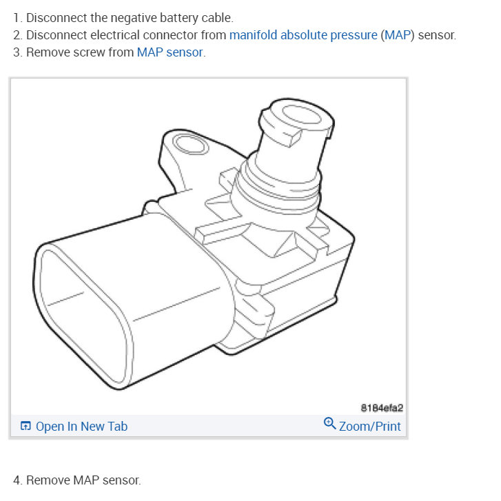

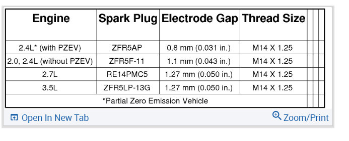

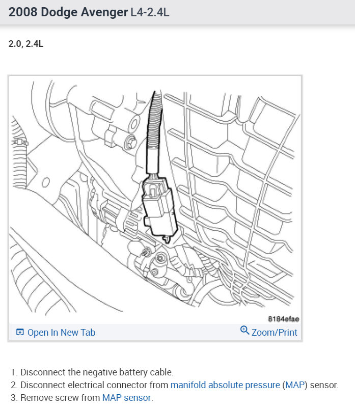

Usually the random misfire is a mixture issue I would try a new MAP sensor. Remove it to see if it holds vacuum. Check out the diagrams (below). Please let us know what you find. We are interested to see what it is. Also make sure you have the correct spark plugs it will not run correctly with anything else the chart is below as well.
