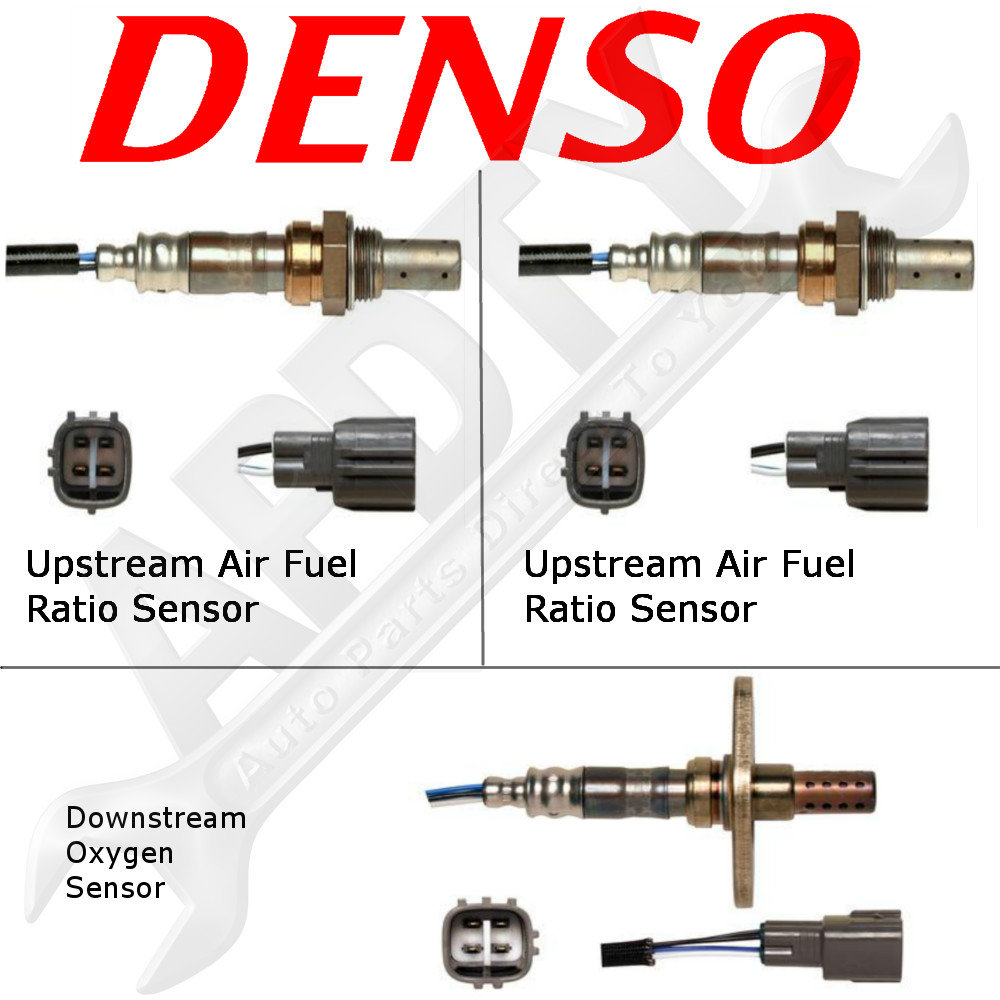

I know this car has two upstream oxygen sensors. Are both of them air fuel sensors? I am throwing a code for bank 2 sensor 1 and know it is a air fuel sensor. Is bank 1 sensor 1 also them same or can I use a regular oxygen sensor in there if there is no code?

Sensors 11, 21 are the same type of sensor. Do not use any other type of sensor. Check out the diagrams (Below). Please let us know if you need anything else to get the problem fixed.
