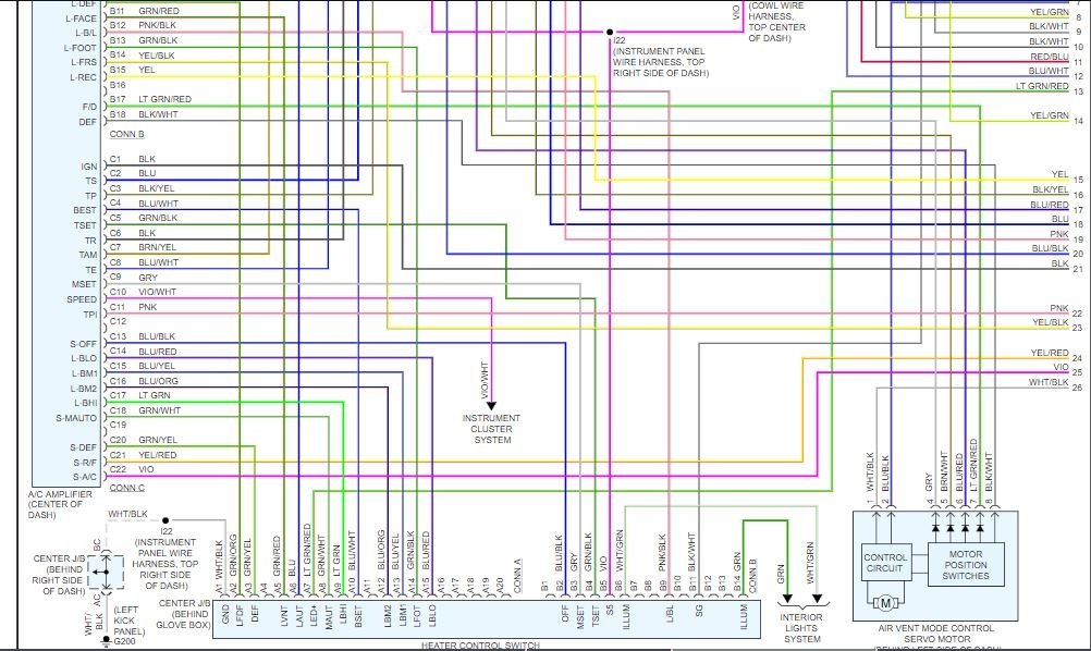

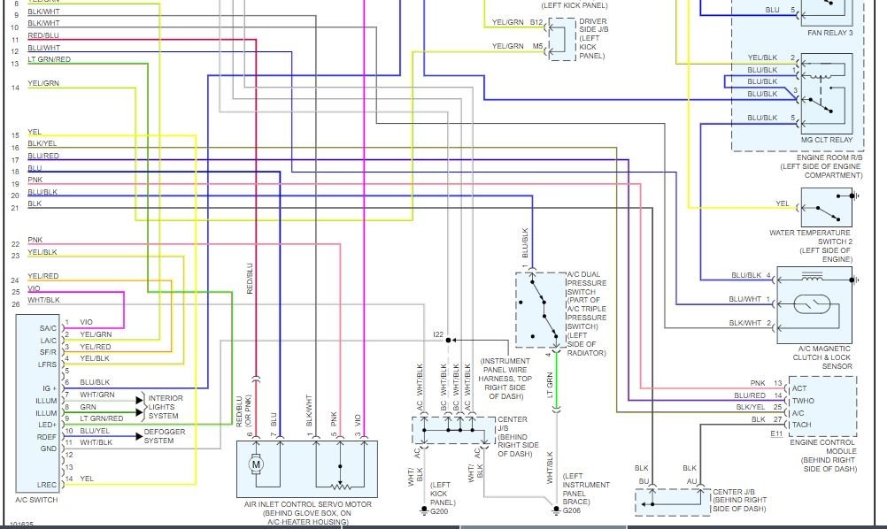

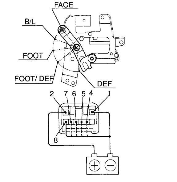

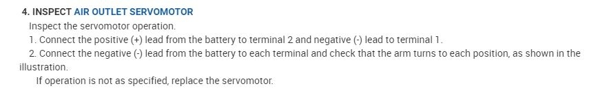

Good morning,

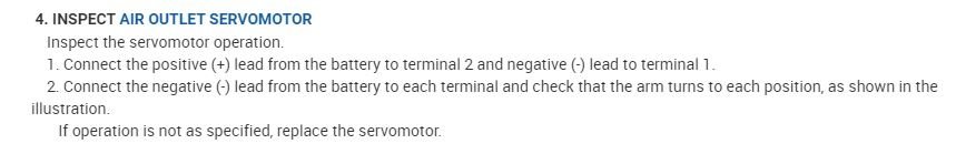

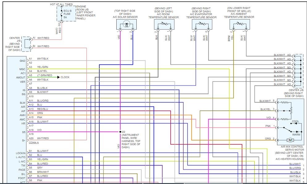

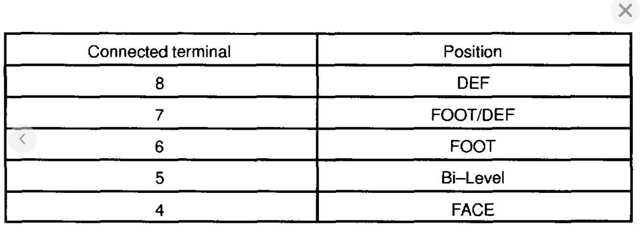

The control head for the A/C sends a command to the servo motor for which direction for the air to flow.
This could be a wiring issue, the control head itself or the servo motor. You need a scan tool that can read the A/C system and perform the commands to see if a signal is getting to the servo motor.
I attached some information for you to view but you need to either check it if you have a scan tool or have someone check it for you to find the failure.
My thoughts are the control head.

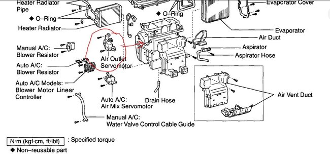

Thanks so much. Do you have a detail of where the servo motor is for this and how to get to it? And I am assuming by the Control Head you mean the controls for the A/C? The other functions seem to be working okay. Could it still be the control head?

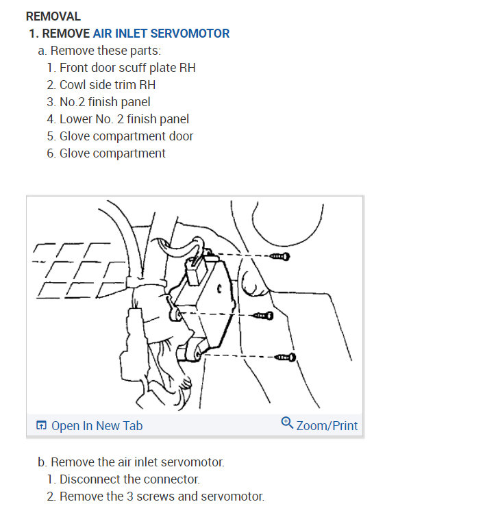

Feb 1, 2020 at 10:00 PM

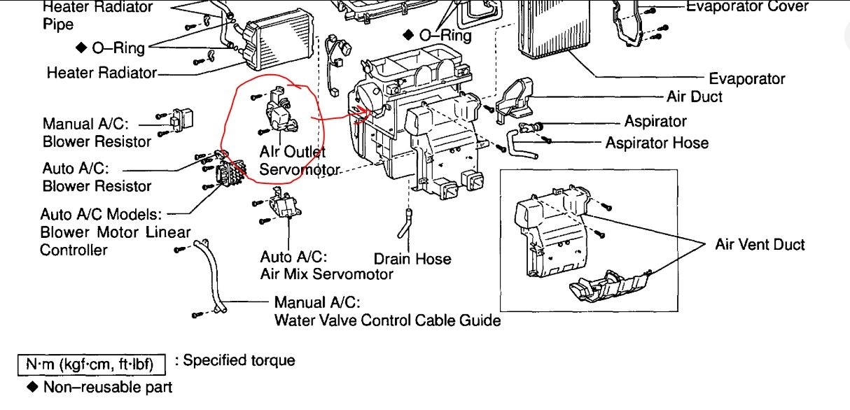

Yes, that is what controls the servo motor for the modes.
I attached a picture of the location for you.

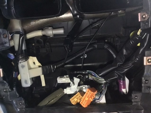

Roy,
Thanks I posted something to the other post. This is what I am looking at but I am still having a hard time finding it. Sorry this is not my day job. Thanks for the patience.
Feb 2, 2020 at 10:03 PM
STEVE W.
  • 15,349 POSTS
The mode control servo is toward the left side in that picture, behind the purple and blue wire bundle.

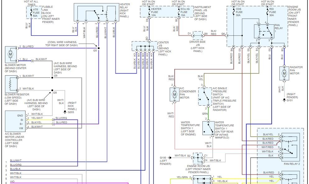

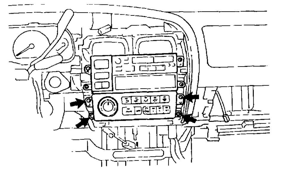

I don't think we ever heard back on it, unfortunately that is very common. If you have the same issue where you cannot switch the air from defrost to dash to floor then you have the same actuator fault. The dash doesn't need to be removed but you do need to pull the instrument trim and the stereo out to gain access to the servo that is tucked in behind it.
Testing and wiring is in the above images.
Jun 26, 2021 at 12:39 PM
We usually hear back when it does not work. We never heard either way so we usually assume it did resolve the issue.
No, the dash does not have to come out. The procedure is in the opening statements of the question.

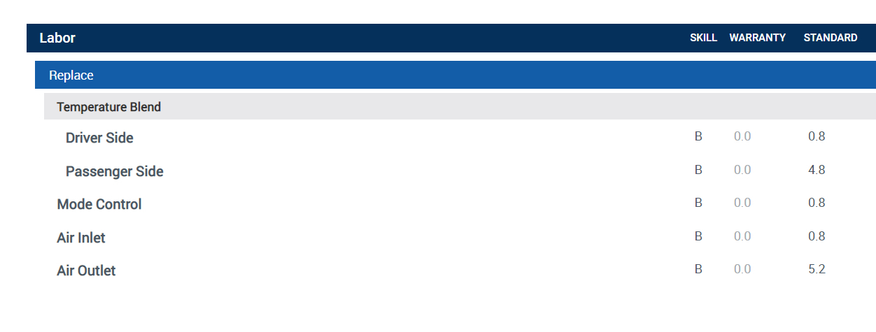

Thanks so much for the replies. This is a car I am considering purchasing and the price is a little steep to start with as used cars are priced pretty high right now. I had my mechanic look it up and he kept getting mixed info and wasn't sure if this was the part that was calling for an hour of labor or something that was showing 5.5 hours labor (which was something that said the dash had to come out). With this said, I will be more comfortable paying a little more for the car. Thanks again.
Jun 26, 2021 at 10:50 PM
Okay, I attached the labor times for replacing each mode door. The ones they are 4.8 and 5.2 hours are the ones that will require the removal of the dashboard.
Has your mechanic narrowed it down to a specific door?
Jun 27, 2021 at 12:48 AM

Okay, the mode door pays .8 hours to replace. That should be about $100.00 plus the part.
I attached a picture of the location for you below.
