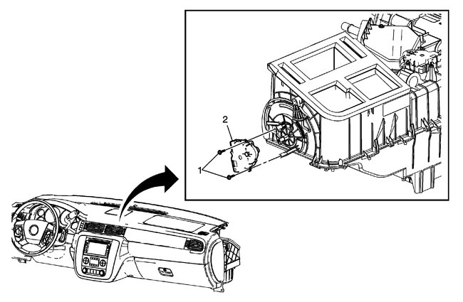

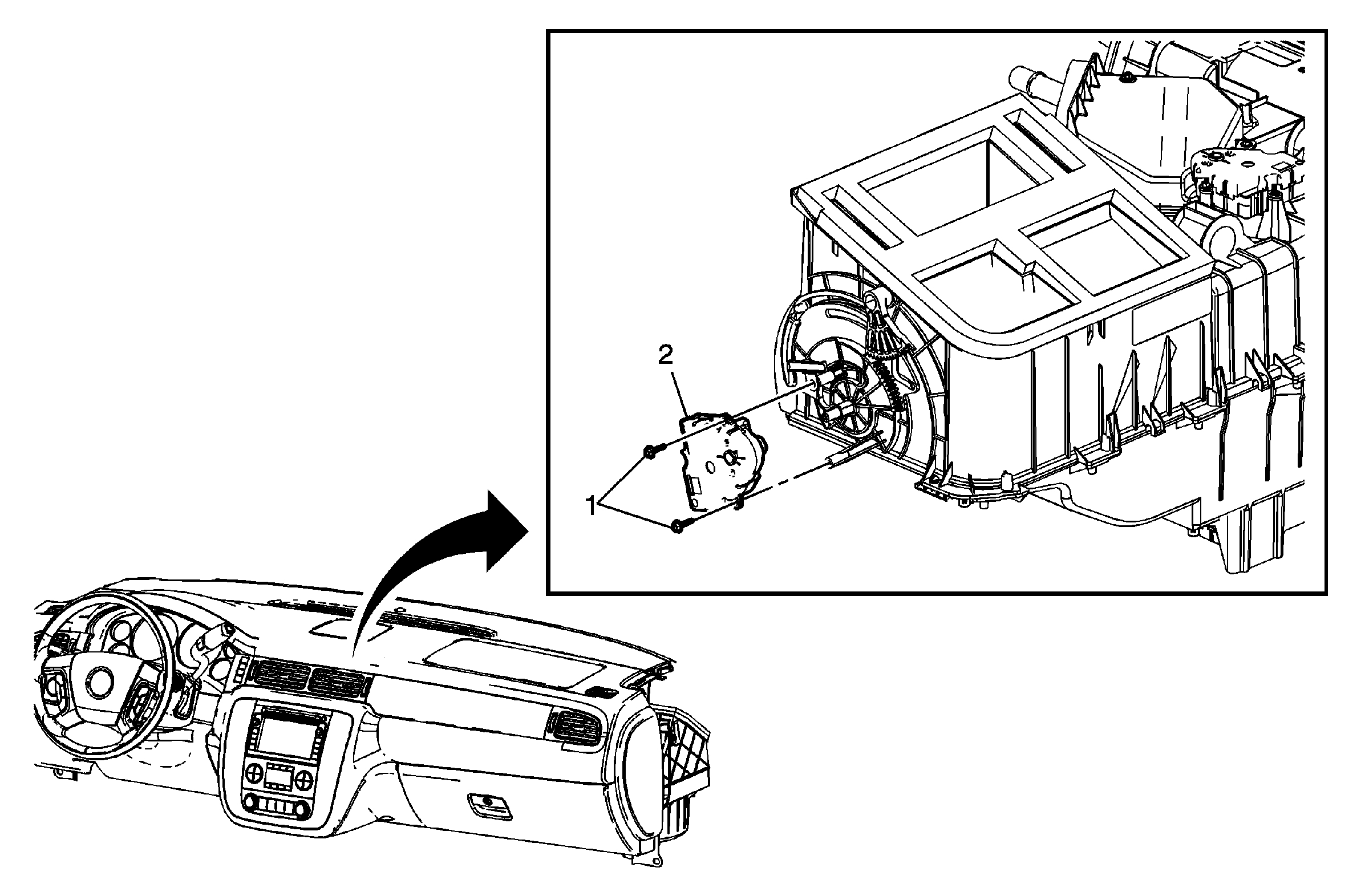

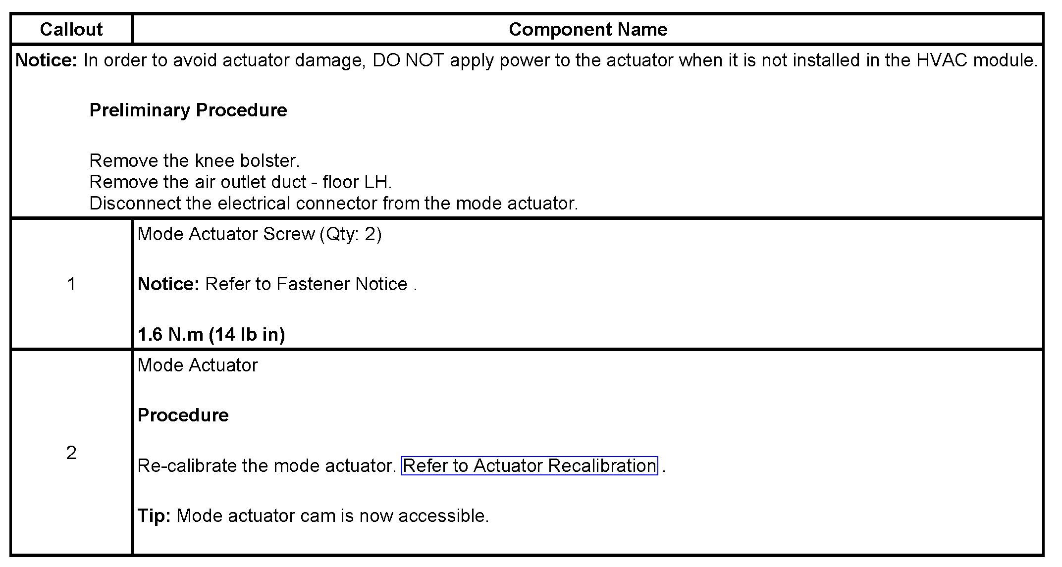

Air flow acuator stuck on vent
2007 CHEVROLET 1500
200,000 MILES • 5.5L • V8 • 2WD • AUTOMATIC
ARTMOUSSEAU
Cannot direct flow of air to any position.
Nov 5, 2019 at 11:19 AM
  • 110,194 POSTS
Hi:
It sounds like the mode door actuator has failed. This actuator is what determines air flow directions.
I attached two pics below. The first are the directions for replacing the actuator and the second shows component location.
Let me know if this helps or if you have other questions. Note: This is for manual climate control. If you have automatic climate control, let me know.
