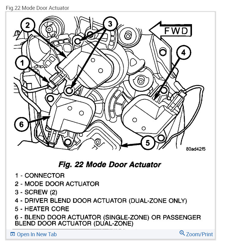

No air flow through any of the vents
2001 DODGE CARAVAN
85,000 MILES • 6 CYL • 2WD
PETE GAYHEART
Blower motor works fine, can hear air flow but no air coming through any vents including defrost and heater.
Aug 2, 2019 at 4:02 AM
  • 55,433 POSTS
It sounds like the mode blend door actuator is out. here is a guide that will walk you through the repair with diagrams and instructions below to show you how on your car:
