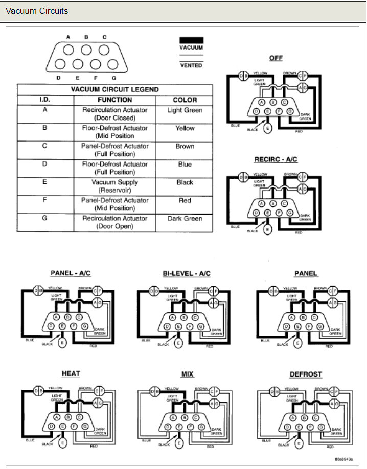

Blower sounds like it is running at all speeds, but I can barely feel it at any vent. what are my diagnostic choices?

It sounds like you lost vacuum tot he HVAC system. Can you check under the hood to see if you can find any small vacuum line headed to the firewall that are broken? Here is a guide to help you see what I am talking about:

thank you for the suggestion but, it is changing vent configuration properly just very little air flow. If I run it on high for very long it starts smelling like blower motor is getting hot, but only on high . Almost like there is some kind of obstruction. I have only had it for a week so i am still tracking all the bugs! :>(
