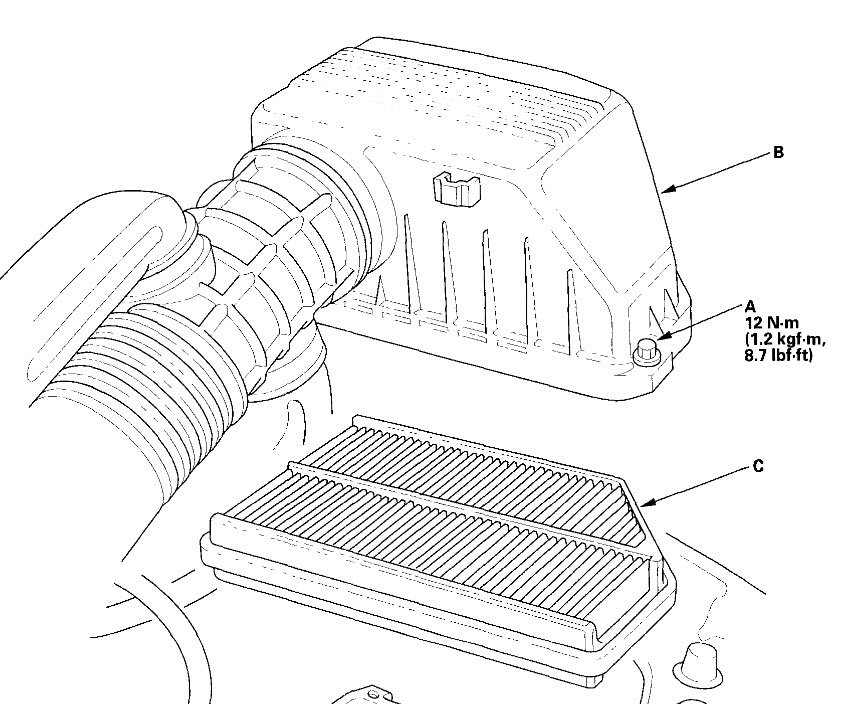

Info is needed to change the engine air filter ?? Tool,Tips, Techniques would Truly be Helpful.
Mar 31, 2016 at 12:12 AM
HMAC300
Experienced Mechanic
48,601 POSTS
just remove the bolts A lift cover and replace filter bolts are maybe 10mm or 13 mm
