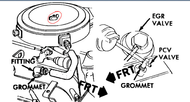

How do I take off the air filter housing on the vehicle listed above?
Jun 17, 2022 at 1:43 PM
  • 110,241 POSTS
There should be a wingnut at the top center of the housing holding the lid in place. Remove that nut and remove the cover and air filter element. (See pic below)
Once they are removed, there are a few hoses that need to be disconnected including vacuum hoses under the assembly. I don't recall there ever being anything holding the housing onto the carb other than the aforementioned wingnut.
Let me know if you are able to get it.
See pic below.

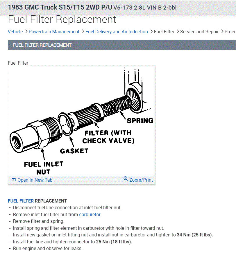

Thanks, needed better access to fuel filter.
Jun 17, 2022 at 3:22 PM
  • 110,241 POSTS
You are very welcome. I hope it helps you. As far as the filter is concerned, it's in the carburetor right behind the fuel inlet.
I attached the directions below for the replacement.
Let me know if this helps or if there is anything I can do to help.
Take care
See pic below.
