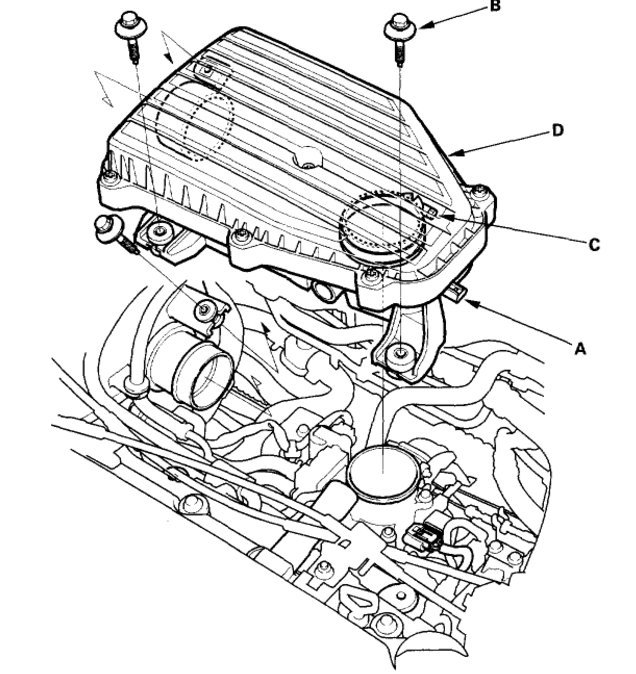

Hello, I am trying to take off (to replace) the air filter housing and we took off the bolts and unplugged the sensor. I was wondering if it is a matter of yanking it out or if we are missing something?

Yes these have a couple of hidden bolts, here is a diagram (below). This guide can help as well
https://www.2carpros.com/articles/how-to-replace-a-car-air-filter
Check out the diagrams (Below). Let us know what happens and please upload pictures or videos of the problem.
