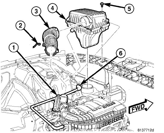

Instructions on removal.

Why do you want to remove the air filter box?
May 24, 2017 at 4:16 PM
DADDYA
MEMBER
29 POSTS
I'm going to install a new AC Compressor and was told that the air filter box had to be removed. Is there another way ?
May 24, 2017 at 8:21 PM
JIS001
Experienced Mechanic
3,412 POSTS
Remove the bolt as shown on image #5. After disconnecting all components on image pull the box out. Hope that helps.
