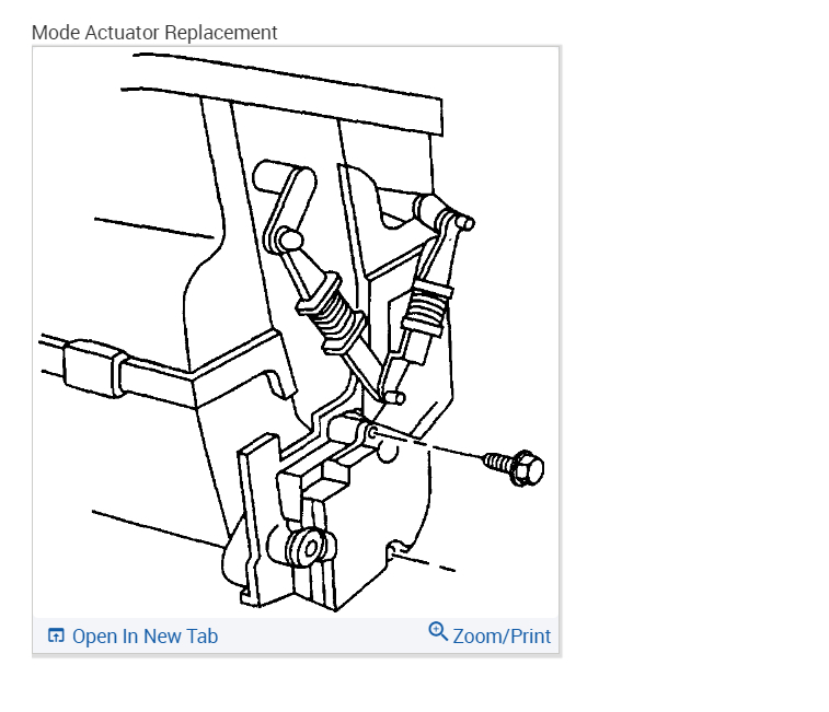

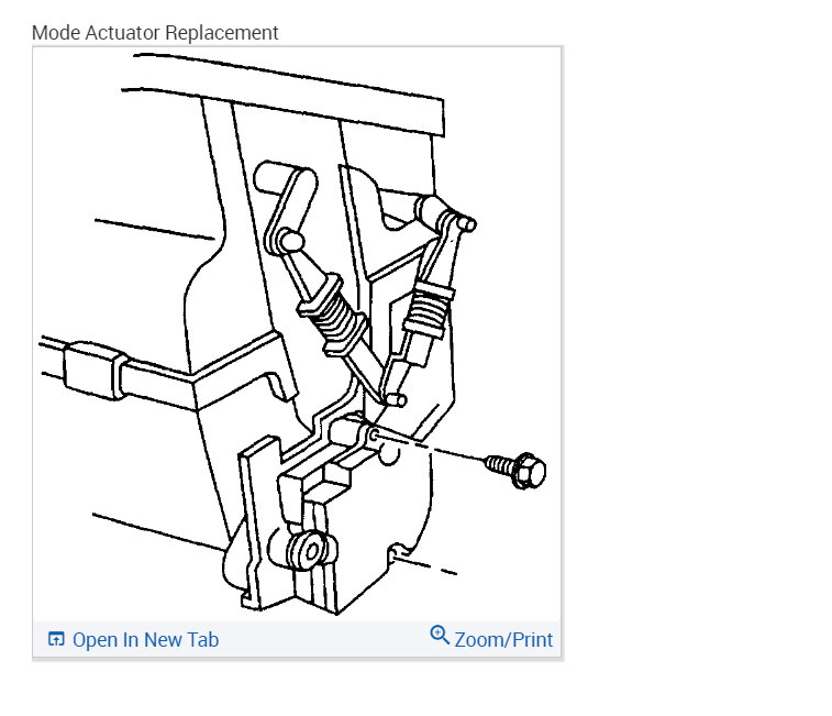

I only have air flowing onto the windshield (defrost mode). My selector will not allow air for floor or the vents on dash. I have the original part and the # 16177412 with another # B2852224B listed at bottom. My air door actuator mode selector has a 6 pin connection.
Nov 4, 2022 at 3:09 AM
  • 55,399 POSTS

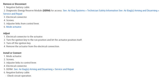

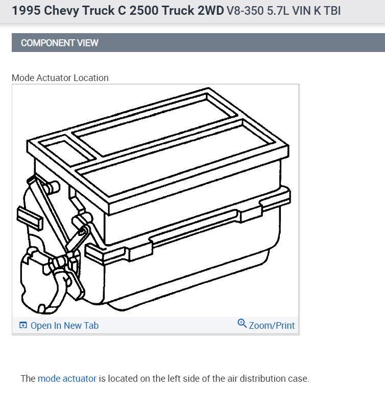

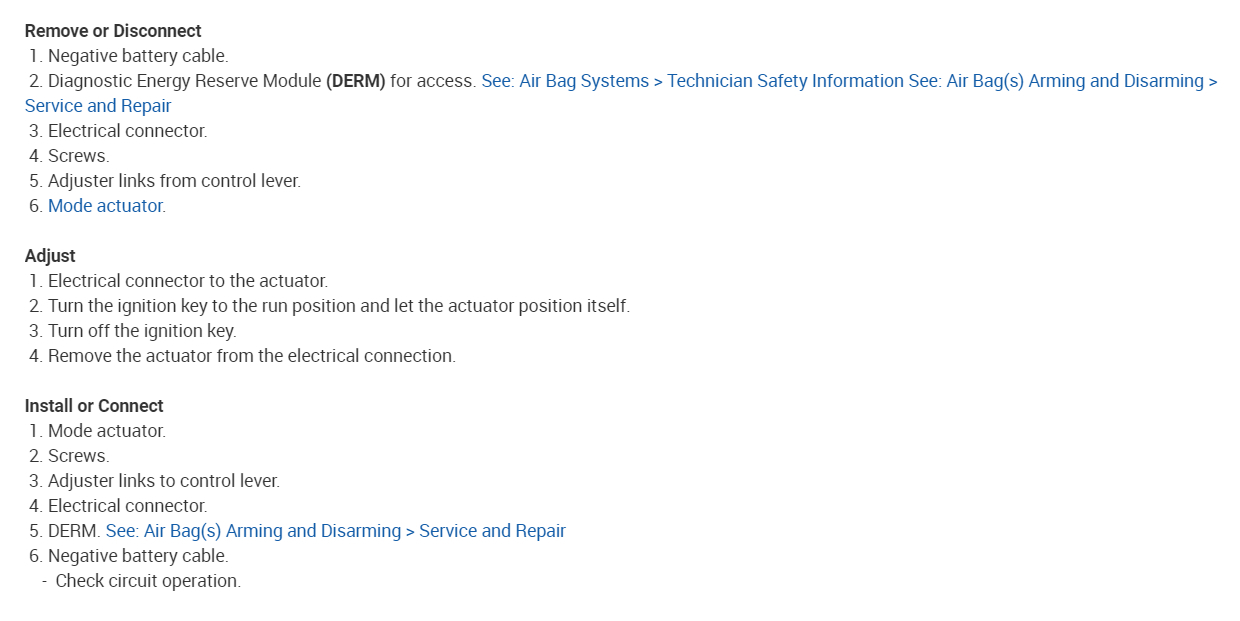

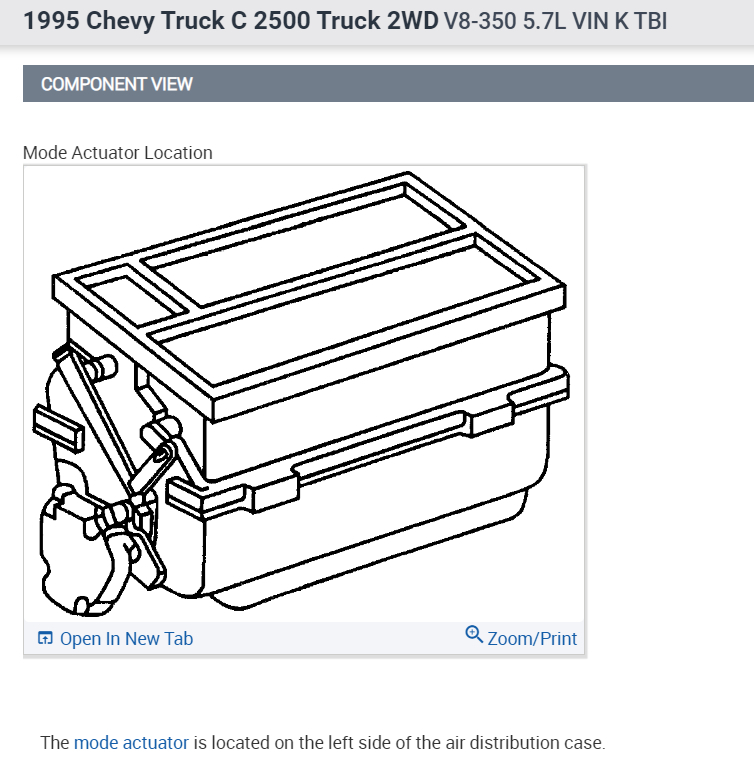

It sounds like the mode actuator door is not working. Check the control arms as well. here is the location of the actuator so you can check it out and replace the mode actuator. Check out the images (below). Please let us know what happens.
