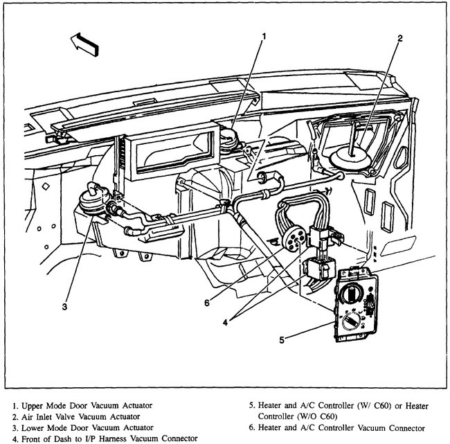

To remove the door actuator you will need to pull the dashboard back.
this guide will help then check out the diagrams below for your car.

The picture shows all of them and their location.

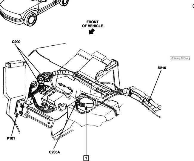

i need a diagram of my trucks dashboard to find exact location of air blend door actuator i have tryed everything and asked everyone i recently bought a haynes service manual from an auto parts store and said nothing about the actuator whether heat or air conditioning it blows in the floor and not anywhere else so if you can can please help me
Jun 26, 2020 at 11:22 AM (Merged)
  • 54,832 POSTS
The blend door actuator you want to change is on top of the heater box. Here is a guide and a diagram (BELOW) that shows you where it is and how to change it.

So based on what I have read it looks like I will need to replace the actuator that controls the left (driver-side) vents which is located on the top of the heater box (blows cold for a while, then blows hot sometimes turning the car off and on again will get it to blow cold again for a little while).
Anyway, it seems all the instructions, photos and videos (including the ones at the link provided above) are not for this actuator except for one that shows where it is located. Any detailed instructions since it is in a more inaccessible location than the lower actuator? Also, are all the actuator's the same? I do not want to order the wrong one for my repair.

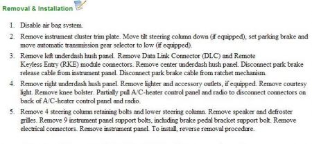

actuator motor is located on top of the heater case. remove instrument panel and unplug electrical connectors. remove actuator motor and replace with new.
Jul 24, 2020 at 4:55 PM (Merged)
BLUELIGHTNIN6
  • 16,542 POSTS
Instrument panel removal
https://images.2carpros.com/forum/automotive_pictures/261618_Noname_1007.jpg
